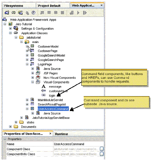

Page Component Subnodes
A Page node has four immediate subnodes as follows:
Each of these nodes might have subnodes of its own.
Java Source Node
The Java source node provides node level access to this component's Java source file. The Web Application Framework component node parents the Java source node in order to emphasize that the application component is logically comprised of more than just the Java node. The Java source node is identical to the conventional Sun Java Studio Enterprise 7 Java source node with the following exceptions:
Use the component's cut, delete, and rename commands instead.
The Java Source node contextual menu commands and properties are described fully in the Sun Java Studio Enterprise 7 documentation.

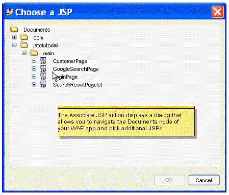

procedure icon  [action] Associate JSP
This associates an additional JSP with the page component. Select a JSP to associate from the list of available JSPs under the current application document root. The OK button in the Choose a JSP Dialog is only enabled when you have selected a JSP which is not associated with any other page at this time. This command modifies the associated JSP's content so that it is configured with the appropriate Web Application Framework tag library descriptor (tld) directive and a Web Application Framework JSP tag which declares the use relationship between the associated JSP and this page.
The following figure shows the Choose a JSP Editor.

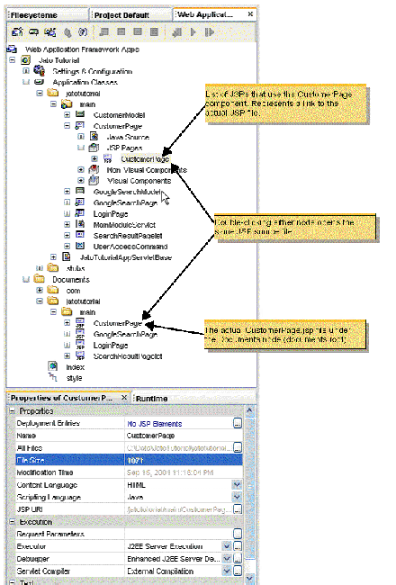

JSP Node
The JSP Node provides node level access to a page component's formerly associated JSP file. The JSP node is identical to the conventional Sun Java Studio Enterprise 7 JSP node.
Though the JSP file is physically located under the application's document root directory, and the page component is physically located under the application's WEB-INF/classes directory, the IDE creates a copy of the JSP node so that Web Application Framework page component developers can have easy access to the associated JSP from within the node hierarchy of the page component.
Note that this is a copy of the node only. There is only one physical JSP file, even though its JSP node appears in two places. This visually confirms that a given JSP is associated with a given page component, and that the IDE automatically synchronizes the content of the JSP as modifications are made to the page component that the JSP uses.
You can see that the JSP node exists in two node hierarchies simultaneously, the document node hierarchy, and the page node hierarchy.
The following figure shows the JSP node.
This figure shows the JSP node in the IDE's Web Apps window.
The JSPs under the Documents node represent the actual JSP files, while the JSPs under the JSP Pages node are simply links to the actual file. This means that if you delete a JSP under the JSP Pages node, you are just removing the visual association it has with the page component in the Sun Java Studio Enterprise 7. However, if you delete a JSP under the Documents node, you are deleting the physical file from disk.

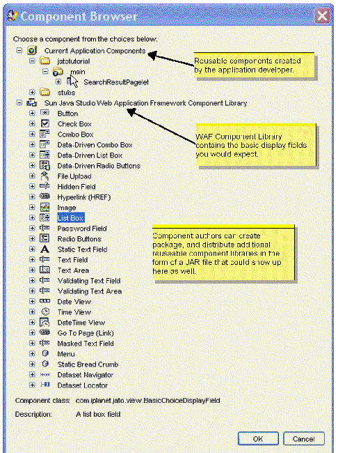

procedure icon  [action] Add Visual Component
This adds a new visual component node. This command presents a component chooser editor. The effect of choosing a component from the component chooser is functionally equivalent to adding a visual component by clicking on the Component palette. They are two equally valid ways to add a visual component.
The Component Browser editor displays with at least two nodes: Current Application Components and the Web Application Framework Component Library.
If you added a third party Web Application Framework component library JAR files to your WEB-INF/lib directory, you would see additional nodes representing those component libraries as well. For more information about creating your own reusable, distributable Web Application Framework component libraries, consult the Web Application Framework Component Author's Guide.
The following figure shows the Component Browser.
This figure shows the Component Browser.
For every visual component node which is added to the page in this manner, the IDE generates a component constructor invocation, a component accessor method, and a class constant for the component instance name. Additionally, a corresponding component specific JSP tag is inserted in all JSPs using the page component.

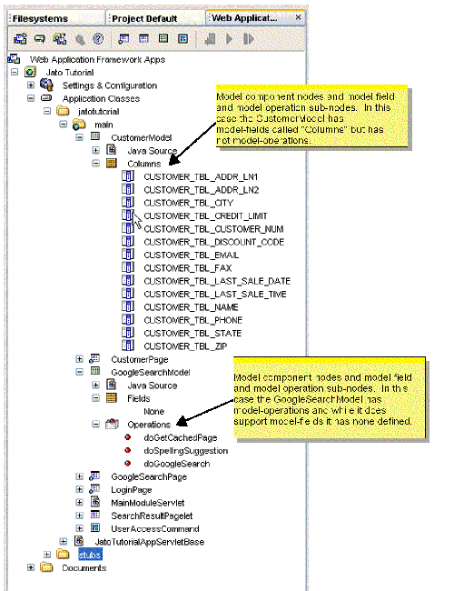

Model Component Node
Models are classes that serve as a storage mechanism and/or a proxy to data for the application's views (pages and pagelets). There are several types of models that ship with Web Application Framework: JDBC SQL Query, JDBC Stored Procedure, Web Service, Resource Bundle, Bean Adapter, Custom, HTTP Session, Tree, Object Adapter, and more.
The following figure shows examples of model component nodes.
This figure shows examples of model component nodes.

Model Component Subnodes
Different types of models can have slightly different subnodes. All models have a Java Source subnode just like the page and pagelet nodes. Model components may have zero or more model field group nodes and models also may support a model operation group node.
The optional model field group node logically represents a set of zero or more named model fields. Visually, the model field group node is parent to zero or more model field nodes. The type of the model field is arbitrary and decided by the component author. The label for the model field group node usually changes depending upon the type of model field it exposes.
All the model fields across all the model field groups must have unique names. In other words, there is one set of uniquely named model fields for the entire model but the component author may allow the model fields to be partitioned into different groups so that different types of fields are supported.
It is possible for a model to have zero model field groups, in which case views will bind to the models with anonymous bindings entered manually. It is also possible for a model to only expose internally generated automatic fields through the binding chooser even though there are no model field nodes or model field group nodes for that model. All this depends upon the decisions made by the component author and the kind of data which the model is managing. A model component that exposes hundreds or thousands of bindings could be designed. In this case, it is not desirable to represent all the fields as nodes, and the component author would instead provide a specialized chooser for the view binding.
The optional model operation group node logically represents a set of zero or more named model operations. Visually, the model operation group node is parent to zero or more model operation nodes. The label for the model operation group node might change depending upon the type of model operation it exposes. However, the label is usually Operations.

Command Component Node
Commands are the controller components of your application. A command can be created to handle specific types of actions when a command field (button or HREF) is clicked, for example.
A single command component can be reused by many different command fields throughout your application. Behavior can be further customized, based upon parameters that are passed into the command component by the many command fields using the command component.
For more details on command component authoring, consult the Web Application Framework Developer's Guide and the Web Application Framework Component Author's Guide.
The following figure shows examples of command component nodes.
This figure shows examples of command component nodes.

Command Component Subnode
Command nodes only have one subnode: the Java Source node.
