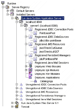

The Server Registry Node
FIGURE 8-1 shows the Runtime window with the nodes you use for server configuration, deployment, and execution. The top level node is the Server Registry node. This node groups the other server-related nodes. It has no commands or properties of its own.
FIGURE 8-1 Server Registry Node
Screenshot of a section of the Runtime window showing the Server Registry Node and its default subnodes.
The Server Registry in FIGURE 8-1 is from an installation of the IDE on the Microsoft Windows platform. This particular installation is a stand-alone installation by a user with administrative, or superuser, privileges. When the IDE is installed by a system administrator for a user who does not have administrative privileges, the host names and port numbers displayed by the nodes are different. The host names and port numbers will also be different for multi-user installations.

The Installed Servers Node
The Installed Servers node groups the server product nodes. It has no commands or properties of its own. In FIGURE 8-1, the Installed Servers node has subnodes for two server products that are included in most installations of the IDE, the Sun Java System Application Server and the Tomcat web server.
The Server Product Nodes
Below the Installed Servers node are nodes for specific web and application server products. Each of these server product nodes represents an installed IDE server plug-in.
The server product nodes have contextual menus and property sheets. The capabilities of each sever product node are determined by the server product and the plug-in module.
Procedures vary with server product, but, in general, to use an application server, configure the appropriate server product node to recognize a specific installation of the server product. You may also use the server product node to create a server instance.
In FIGURE 8-1, the Installed Servers node has subnodes for the two plug-ins that are included in most installations of the IDE, the Sun Java System Application Server Standard Edition 7 plug-in and the Tomcat web server plug-in. The next section describes the Sun Java System Application Server Standard Edition 7 node and its subnodes.

The Sun Java System Application Server Nodes
This section identifies and describes the nodes that represent the Sun Java System Application Server in the Runtime window.
The Sun Java System Application Server 7 Node
The Sun Java System Application 7 server node is for administering the application server.
Installing the IDE creates an application server domain. It also creates an admin server instance that administers the application server domain. In most cases, you can do all of your work in the installed application server domain and admin server.
The Server Registry shown in FIGURE 8-1 contains the application server domain and admin server that were created by installing the IDE. The admin server instance is represented by the node just below the Sun Java System Application Server 7 node that is labeled localhost:4848. You can view the application server domain name by opening the admin server node's property sheet.
If you need to, and if you have root or administrative privileges, you can use the Sun Java System Application Server 7 node to create additional application server domains and admin servers.
The Admin Server Node
Below the Sun Java System Application Server 7 node is an admin server node. In FIGURE 8-1, the admin server node is labeled localhost:4848. Admin server nodes represent instances of the Sun Java System Application Server's admin server. Each admin server instance administers an application server domain.
Application server domains and admin server instances are created by installing the IDE with the Sun Java System Application Server and administering the Sun Java System Application Server. The type of installation you work with determines how the application server domain and server instance are created. Some of the possibilities are described in the following list:
The host name displayed with the admin server node is the name of the machine on which the application server is running. FIGURE 8-1 shows a stand-alone, single-user installation, and the application server domain is running on the local host. In a multi-user installation, the application server might be running on another machine.
The port number that is displayed with the admin server is the port number for communicating with the admin server. This port number is set when the application server domain and admin server instance are created. FIGURE 8-1 shows the default port number for a single-user installation on the Microsoft Windows platform.
Some of the tasks you perform with the admin server node are starting and stopping server instances in the server domain that is controlled by the admin server.
Server Instance Node
Below the admin server node is an application server instance node. In FIGURE 8-1, the application server instance node is labeled server1(localhost:8080). The application server instance node represents a server instance.
When you deploy a module or an application, you deploy to a specific server instance. You must have a server instance node and the instance it represents must be running before you can deploy and execute.
FIGURE 8-1 shows a server instance that was created by installing the IDE. You can also create server instances by administering you application server domain.
Admin Server and Server Instance Startup
To start the admin server and server instance, use the following procedure:
1. If you so choose, you may set the application server home directory. Right-click the application server and choose Properties. Click the Sun Java System Application Server Home ellipses (...) button and choose the preferred home directory.
2. Right-click the Admin Server node and choose Start.
A progress monitor window opens. When the admin server starts, the progress monitor closes. A server instance node is displayed below the admin server node.
3. Right-click server instance node and choose Status.
The Status dialog box opens. The Status field displays the status of the server instance, which is Stopped.
4. Click Start Server.
The Status dialog box displays a message to tell you that it is starting the application server instance. When the server instance starts, the Status field displays Running.
5. Click Close.
The server instance is ready for use.
The contextual menu lists other tasks you can perform with the admin server node.
The Registered Resource Nodes
Below the server instance node is a set of nodes that represent the named resources available to applications running in the server instance. FIGURE 8-1 shows nodes for the resources that are used in and created by the scenarios in this book:
The Deployed Application Nodes
Underneath the registered resource nodes is a set of nodes that represent modules and applications deployed to the server instance. FIGURE 8-1 shows a node for an application named CatalogApp. The scenarios in this manual cover programming and deploying CatalogApp. For the procedure that deploys CatalogApp, see Creating the J2EE Application.
The Unregistered Resource Nodes
Below the deployed application nodes is a set of nodes that represent unregistered server resources. These nodes are subnodes of the admin server node, and they represent resources that are not yet registered with a server instance.
These nodes have menu commands for creating and registering new resources. A scenario in this book uses the Unregistered JMS Resources node to create a queue and queue connection factory. For the procedure that creates resources, see Setting up the Application Server.
The Default Server Nodes
These nodes identify the server instances that are currently designated as the default server instances. When you deploy an application, it is deployed to the default server instance unless you specify otherwise on the application's property sheet.
In FIGURE 8-1, the default nodes show that the default server for Java 2 Platform, Enterprise Edition (J2EE platform) applications is a Sun Java System Application Server.
To make a server instance the default server, use one of the following procedures:
single-step bulletRight-click the server instance node and then choose Set As Default.
single-step bulletRight-click the J2EE Applications node under Default Servers and choose Set Default Server. The Select Default Application Server dialog box opens. Select the server instance to be used as the default Application Server.

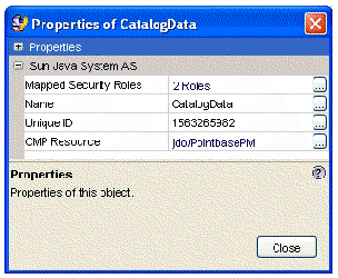

Server-Specific Properties
The modules and applications that you work with have property sheets. You use the property sheets to identify the services your modules and applications need from the application server.
Many property sheets have server-specific sections. The server-specific sections list the properties defined for specific server products.
For example, FIGURE 8-2 shows the Sun Java System AS section of the CatalogData EJB module property sheet. This section has a CMP resource property, and you use this property to identify the data source for the CMP entity beans in the CatalogData module. Notice that the data source named in FIGURE 8-2, jdo/PointbasePM, appears in FIGURE 8-1 as Registered Persistence Manager of the Sun Java System Application Server instance.
FIGURE 8-2 EJB Module's Sun Java System AS Section
Screenshot of the EJB module's property sheet with Sun Java System AS-specific tab selected.
