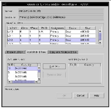

1. Select the array that you want to configure.
2. Choose Configuration
Custom Configure.
| Note - This selection is inactive unless you have selected an array with available physical drives. |
3. Select Add LDs/LVs to the Current Configuration from the Custom Configuration Options window.
4. Verify that the server and controller displayed at the top of the window are correct.
5. Select a disk you want to be included in the new logical drive and click Add Disk.
If you make a mistake or change your mind, select the drive and click Remove Disk.
For definitions of RAID levels, see RAID Basics.
7. Select the Host channel and ID to which you would like the new logical drive to be mapped to from the Channel and the ID list boxes.
The Max Drive Size displays the total capacity of each disk. A smaller logical drive can be created by decreasing this value.
| Note - If you do not change the Max Drive Size but you do change the Partition Size, a new partition is created at the specified partition size. The remaining logical drive size capacity moves to the last partition. Remaining capacity can be used later by expanding the drive (as explained in To Expand the Capacity of a Logical Drive or Logical Volume). The drive capacity is no longer editable after a partition is created. |
| Note - If you want to create another logical drive on the same controller, click New LD. The logical drive you just defined is created and you are returned to the top of the window, enabling you to create another logical drive. For the maximum number of logical drives supported, see TABLE 4-1. |

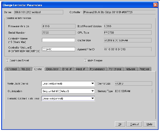

12. Specify Default, Write-through, or Write-back as the Write Policy for the logical drive.
The write policy determines when cached data is written to the disk drives. The ability to hold data in cache while it is being written to disk can increase storage device speed during sequential reads. Write policy options include write-through and write-back.
Using write-through cache, the controller writes the data to the disk drive before signaling the host OS that the process is complete. Write-through cache has lower write operation and throughput performance than write-back cache, but it is the safer strategy, with minimum risk of data loss on power failure. Because a battery module is installed, power is supplied to the data cached in memory and the data can be written to disk when power is restored.
Using write-back cache, the controller receives the data to write to disk, stores it in the memory buffer, and immediately sends the host OS a signal that the write operation is complete, before the data is actually written to the disk drive. Write-back caching improves the performance of write operations and the throughput of the controller card. Write-back cache is enabled by default.
| Note - The setting you specify in the Write Back field on the Cache tab of the Change Controller Parameters window is the default global cache setting for all logical drives. (See Cache Tab.) |

1. Create a logical drive as described in Step 1-Step 15 in To Add a Logical Drive or Logical Volume From New Logical Drives.
| Note - Do not partition the logical drive that you are adding to the logical volume. A logical drive that has been partitioned cannot be added to a logical volume. |
2. Before you click Commit, to add the logical drive to a logical volume, click Add to LV.
The logical drive is added to the LV Definition box. The total size of the logical volume is displayed in the Available Size (MB) field.
| Note - Because the logical volume has not been partitioned yet, the Part Size (MB) and the Available Size (MB) are equal. A single logical volume is considered to be a single partition. |
| Note - Mixing SATA and FC logical drives to create a logical volume is not supported. |
3. To create another logical drive to add to the logical volume, click New LD.
4. Create the logical drive and add it to the logical volume by clicking Add to LV.
Repeat this step for every logical drive you want to add to the logical volume.

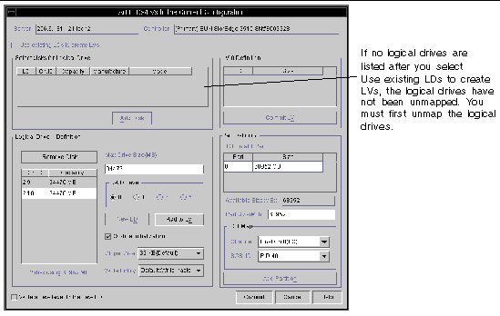

| Note - Before you can add a logical volume from existing logical drives, you must unmap the logical drives. |
Custom Configure.
5. Select Use existing LDs to create LVs.
If you do not see any logical drives listed under Select disks for logical drive, the logical drives have not been unmapped and therefore are unavailable to select. You must unmap the logical drives first.
6. Select a logical drive and click Add to LV.
7. When you have finished adding logical drives to the logical volume, to create another logical volume or an individual logical drive, click Commit LV.

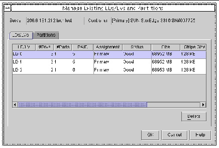

9. Select Manage Existing LDs/LVs and Partitions.
11. Select the logical drive or logical volume you want to delete, click Delete, and click OK.
When deleting a logical volume, after you click Delete, the logical volume is deleted, but the logical drives that make up the logical drive are displayed.
12. Click OK in the Confirm Configuration Operation window to complete the operation, and click Close.
The console refreshes and the array is redisplayed no longer showing the logical drive.

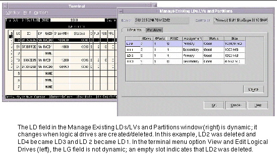

The logical drive/logical volume number referenced with each logical drive is dynamic; it changes when logical drives are created/deleted. This number is displayed in the logical drive (LDs/LVs) field of several windows including Dynamically Grow and/or Reconfigure LDs/LVs, Change Host LUN Assignments, Manage Existing LDs/LVs and Partitions, and the main window.
Used strictly as a placeholder that enables you to visually keep track of logical drives and logical volumes, this number is insignificant to the controller. That is, the controller does not report on the logical drives or logical volumes according to this number. For example, if four logical drives exist, and LD2 is deleted, the existing LD3 dynamically changes to LD2, and LD4 changes to LD3. Only the LD/LV number changes; all LUN mapping and data on the logical drives remains unchanged.
Because the controller reports on the total number of logical drives, which in this case is three, the actual LD/LV number as displayed in the LD/LV field is irrelevant. In this example, if a new logical drive is created, it takes the LD number of the logical drive that was deleted, and the controller reports that there are a total of four logical drives. All existing logical drives return to their original primary/secondary designation.

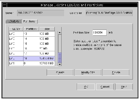

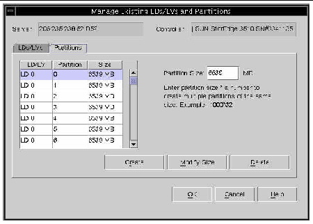

| Note - Before you can create a partition, you need to unmap all assigned LUNs. |
1. Select the array that contains the logical drive(s) you want to partition.
2. View the logical drive(s) you want to create partition(s) on.
3. If any of these logical drives have host LUN assignments, proceed to Step 4; if they do not, proceed to Step 8.
4. Choose Configuration
Custom Configure.
5. Select Change Host LUN Assignments.
6. Select the Host LUN(s) that are attached to the logical drive(s) you want to partition, and click Unmap Host LUN.
7. Click OK, and then click Close.
8. Choose Configuration
Custom Configure.
9. Select Manage Existing LDs/LVs and Partitions from the Custom Configuration Options window.
10. Select the Partitions tab.

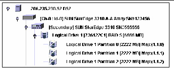

11. Select a logical drive or logical volume you want to partition.
12. Specify the Partition Size in Mbyte and click Create.
To create multiple partitions of the same size, click Add Partition as many times as partitions you want to create. You can also type the partition size in the Part Size field and multiply (*) it by the number of partitions you want to create, for example 100*128. Any remaining Mbyte is added to the last partition.
As you add partitions, the remaining capacity displayed in Available Size (MB) decreases by the amount of the partition size.
13. To change the size of a partition you have already created, select the logical drive or logical volume, and click Modify Size.
14. Specify the new size (in Mbyte) in the Partition Size field, and click OK.
15. Click OK in the Confirm Configuration Operation window to complete the operation, and click Close.

For important information regarding the logical drive/logical volume number displayed in the LDs/LVs field in the Manage Existing LDs/LVs and Partitions window, see The Logical Drive/Logical Volume Number.

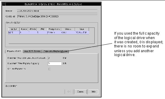

Use this option to expand the capacity of an existing logical drive, or to expand the capacity of a logical volume. For example, you might originally have had a 72-Gbyte drive of which only 36 Gbyte was selected to build a logical drive. To use the remaining 36 Gbyte, you need to expand the logical drive. RAID levels 0, 1, 3, and 5 support expansion.
| Note - To expand a logical volume, you must first expand the logical drives that make up the logical volume. |
Custom Configure.
3. Select Dynamically Grow and/or Reconfigure LDs/LVs from the Custom Configuration Options window.
4. Select the logical drive or logical volume you want to expand.
5. Select the Expand LD/LV tab.
6. Specify the capacity in Mbyte by which you want to expand the logical drive or logical volume in the Maximum Drive Expand Capacity field, and click OK.
The capacity shown in the Maximum Available Drive Free Capacity field is the maximum available free disk space per physical drive, based on the smallest physical drive in the logical drive. The capacity you specify is added to each physical drive in the logical drive.
As described in the following examples, the total amount of capacity that is added to the logical drive is calculated automatically based on the RAID level.
| Note - Spare drives are not included when expanding a logical drive. Do not include spare drives when calculating maximum drive expand capacity. |
If you know the total maximum drive capacity by which you want to expand a logical drive, perform the following calculations based on the RAID level to determine the amount to enter in the Maximum Drive Expand Capacity field:
| Note - The Maximum Drive Expand Capacity cannot exceed the Maximum Available Drive Free Capacity. |
7. To use the logical drive immediately, select OnLine Expansion.
Online expansion enables you to use the logical drive before expansion is complete. However, because the controller is building the logical drive while performing I/O operations, expanding a logical drive online requires more time than offline expansion.
If you do not select OnLine Expansion, you can use the drive only after expansion is complete. Because the controller is building the logical drive without having to also perform I/O operations, offline expansion requires less time than online expansion.
| Note - The Online Expansion option is not available when expanding logical volumes. |
8. Click OK in the Confirm Configuration Operation window to complete the operation, and click Close.
Custom Configure.
4. Select the logical drive to which you want to add a drive.
5. Select the Add SCSI Drives tab.
6. From the list of Available disks, select the drive you want to add to the logical drive.
The drive is moved to the Add disk(s) to LD list.
If you make a mistake or change your mind, select the disk from the Add disk(s) to LD list and click Remove.
8. When you are finished adding the drives, click OK.
9. Click OK in the Confirm Configuration Operation window to complete the operation, and click Close.
For important information regarding the logical drive/logical volume number displayed in the LD/LV field in the Dynamically Grow and/or Reconfigure LDs/LVs window, see The Logical Drive/Logical Volume Number.

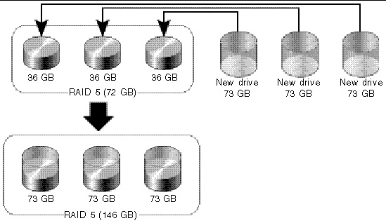

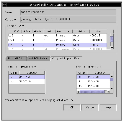

You can copy and replace existing physical drives with drives of the same or higher capacity. Because the logical drive uses the capacity size of its smallest drive, all drives must be replaced with drives of the same or higher capacity. For example, as shown FIGURE 8-1, a logical drive that originally contains three 36-Gbyte member drives can be replaced with new 73-Gbyte member drives.
| Note - To use the additional capacity provided by drives with higher capacity, you need to expand the capacity as explained in To Expand the Capacity of a Logical Drive or Logical Volume. |
FIGURE 8-1 Copying and Replacing Physical Drives
Custom Configure.
4. Select the logical drive for which you are going to perform the copy and replace operation.
5. Select the Copy and Replace Drive tab on the Dynamically Grow and/or Reconfigure LDs/LVs window.
6. From the Drive to Copy Data From list, select the new hard drive.
7. From the Drive to Copy Data To list, select the hard drive that is going to be replaced, and click OK.
9. When the operation is complete, close the progress window.
10. To use the additional capacity provided by the new drives, follow the instructions in To Expand the Capacity of a Logical Drive or Logical Volume.

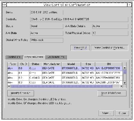

When a SCSI array is powered on, the controller scans all physical drives that are connected through drive channels. Unlike FC and SATA arrays, if a SCSI array has completed initialization and then a physical drive is connected, the controller does not automatically recognize the new drive until the next controller reset. This difference in behavior is due to differences between Fibre Channel and SCSI architectures and protocols.
A SCSI hard drive can be scanned in and made available without having to shut down the array by performing the following steps.
2. The View Controller Configuration window is displayed.
3. Select the Physical Drives tab, and click Scan SCSI Drive.
If a drive fails, the Scan SCSI Drive button is also displayed on the Physical Drive window. You can select a physical drive, select View, and click Scan SCSI Drive from the View Physical Drive window.
4. Select the correct Channel and ID that the drive was input on.
If the scan was successful, the drive is appropriately displayed in the main window and made available.

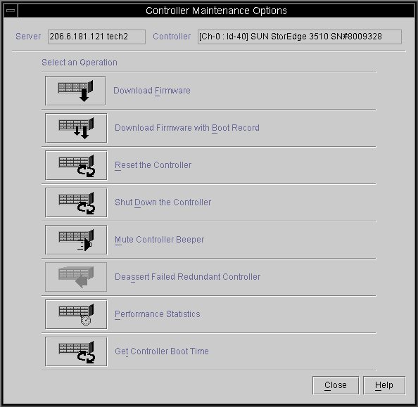

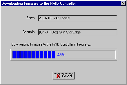

The following procedures are used to upgrade the controller firmware for both a single and redundant controller configuration.
2. Choose Array Administration
Controller Maintenance.
3. If you are not already logged in as ssconfig, a password prompt is displayed; type the ssconfig password.
The Controller Maintenance Options window is displayed.

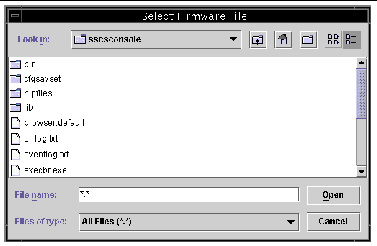

4. If upgrading firmware only (not boot record), select the Download Firmware option.
The Select Firmware File window is displayed.

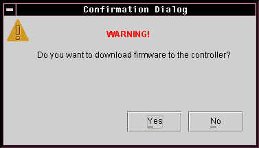

5. Select the firmware you want to download, and click Open.
The Confirmation Dialog prompt is displayed.
The firmware download to the RAID controller displays a progress bar.
7. When the progress bar reaches 100%, click OK.
8. After the firmware has been downloaded, check the settings to make sure they are configured correctly.

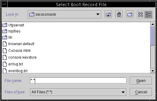

3. Select Download Firmware with Boot Record.
The Select Boot Record File window is displayed.
4. Select the boot record and click Open.
5. Select the appropriate firmware file.
The Select Firmware File is displayed.
The Confirmation Dialog window is displayed.
7. Repeat Steps 6 through 8 in the previous subsection.

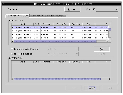

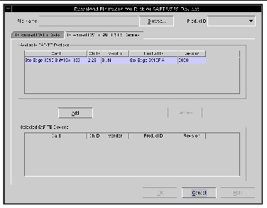

This option enables you to upgrade the firmware on hard drives and SAF-TE/SES devices.
Download FW for Devices.
3. Click the Download FW for Disks tab.
4. Select either To All disks under Controller, and select an array from the menu, or select To All disks under LD, and select the logical drive from the menu.
5. Click Browse and locate the download firmware file.
6. Select the download firmware file, click Open, and click OK.
The firmware starts to download.
7. When the progress reaches 100%, click OK.
8. To verify that the firmware has downloaded successfully, select View
View Physical Drive, and make sure the firmware version has changed in the Product Revision field.
9. So that the console displays properly, you need to probe for new inventory.
Select the server icon and choose View
View Server
Probe to send a command to the selected server to probe for new inventory.
| Note - SAF-TE devices are used by SCSI arrays and SES devices are used by Fibre Channel arrays. |
3. Click the Download FW for SAF-TE/SES Devices tab.
4. Click Browse and locate the download firmware file.
5. Select the download firmware file, click Open, and click OK.
The firmware starts to download and two progress windows are displayed.
6. When the progress reaches 100%, click OK.
7. To verify that the firmware has downloaded successfully, select View
View Enclosure, and make sure the firmware version has changed in the Firmware Rev field.
8. So that the console displays properly, you need to probe for new inventory.
View Server to send a command to the selected server to probe for new inventory.

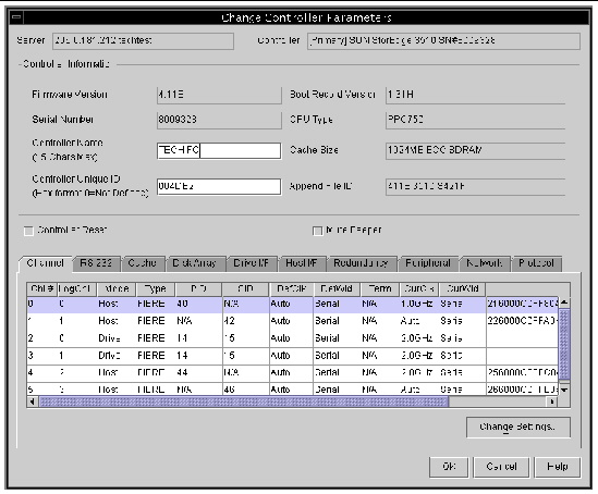

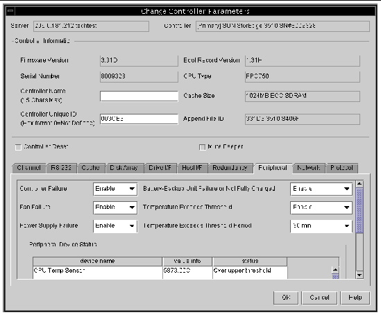

Custom Configure.
If necessary, log in to the configuration level of the program with the ssconfig password. The Custom Configuration Options window is displayed.
3. From the Custom Configuration Options window, select Change Controller Parameters.
The Change Controller Parameters window with the Channel tab selected is displayed.
| Note - For the Sun StorEdge 3510 FC array and the Sun StorEdge 3511 SATA array, the CurClk is 2.0 GHz. |
The options on the Change Controller Parameters window specified in TABLE 8-2 require that the controller be reset so that the changes take effect.
If a change requires a controller reset, the following message is displayed in the lower left side of the window:
[Controller reset is required for changes to take effect.]
To reset the controller and save changed values, you can either select the Controller Reset check box at the time of making the change, or reset the controller later through the Controller Maintenance window (see To Reset the Controller.). If you are making multiple changes, you might not want to stop and reset the controller after each change. If you do not select the Controller Reset check box, and the change requires a reset, when you click OK, a warning message is displayed:
1. Select the Controller Reset check box.
2. Make the changes and click OK.
1. Do not select the Controller Reset check box.
3. Reset the controller later as explained in To Reset the Controller.
1. From the Channel Settings tab, select the channel to be edited.
The Change Channel Settings window is displayed. For the server to recognize the array, a host channel must have an ID assigned to a logical drive and a logical drive mapped to that host channel and ID. This window enables you to configure the host/drive channel.
3. From the Channel Mode list box, select either Host or Drive.
A Drive channel is what the drives are connected to (internal or external). A host channel is what is connected to the server. The most common reason to change the Channel Mode from Host to Drive is to attach expansion units to a RAID array.
| Note - The Sun StorEdge 3310 SCSI array and the Sun StorEdge 3320 SCSI array support a maximum of two host channels. |
| Note - Depending on the controller configuration, you might need to select both primary and secondary channel IDs as described in the following steps. |
4. From the Available SCSI IDs list box, select the primary channel ID, which is designated as PID, and click Add PID.
5. If you have two controllers installed, select a secondary channel ID from the Available SCSI IDs list box, and click Add SID.
| Note - For the Sun StorEdge 3310 SCSI array and the Sun StorEdge 3320 SCSI array, if you add more than four host channel IDs, the LUNs Per Host ID parameter (see Host I/F Tab) must be set to a value less than 32. |
6. For changes to take effect, reset the controller.

1. From the Change Controller Parameters window, select the Cache tab.
2. To specify write back as the default cache, click the Write Back Cache list box and select Enabled.
Using write-through cache, the controller writes the data to the disk drive before signaling the host OS that the process is complete. Write-through cache has lower write operation and throughput performance than write-back cache, but it is the safer strategy, with minimum risk of data loss on power failure. Because a battery module is installed, power is supplied to the data cached in memory and the data can be written to disk when power is restored. When write-back cache is disabled, write- through cache becomes the default write policy.
The setting you specify is the default global cache setting for all logical drives. You can override this setting per logical drive when you create a logical drive.
3. Select an Optimization mode.
The Optimization mode indicates the amount of data that is written across each drive. The controller supports two optimization modes, sequential I/O and random I/O. Sequential I/O is the default mode.
The RAID array’s cache optimization mode determines the cache block size used by the controller for all logical drives:
An appropriate cache block size improves performance when a particular application uses either large or small stripe sizes:
Since the cache block size works in conjunction with the default stripe size set by the cache optimization mode for each logical drive you create, these default stripe sizes are consistent with the cache block size setting. You can, however, specify a different stripe size for any logical drive at the time you create it. See Specifying Non-Default Stripe Sizes for more information.
Refer to the Sun StorEdge 3000 Family RAID Firmware User’s Guide for more information on cache optimization modes.
Depending on the optimization mode and RAID level selected, newly created logical drives are configured with the default stripe sizes shown in TABLE 8-3.
When you create a logical drive, you can replace the default stripe size with one that better suits your application.
| Note - Default stripe sizes optimize performance for most applications. |
Refer to the Sun StorEdge 3000 Family RAID Firmware User’s Guide for information about how to set the stripe size for a logical drive.
Once the stripe size is selected and data is written to logical drives, the only way to change the stripe size of an individual logical drive is to back up all its data to another location, delete the logical drive, and create a logical drive with the stripe size that you want.
The maximum capacity per logical drive supported by the RAID firmware is:
Actual logical drive maximum capacities are usually determined by practical considerations or the amount of disk space available.
Refer to the Sun StorEdge 3000 Family RAID Firmware User’s Guide for details regarding maximum usable capacity of a logical drive, depending on RAID level and optimization mode.
4. Set Periodic Cache Flush Time.
Setting a Periodic Cache Flush Time enables the controller to flush cache to logical drive storage at specified intervals. This safety measure prevents the accumulation of data in cache that could be lost in the event of power loss.
Select one of the following values:
| Note - Setting this value to an interval less than one minute (Continuous Sync or 30 sec) might affect performance. |
5. For changes to take effect, reset the controller.

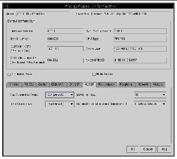

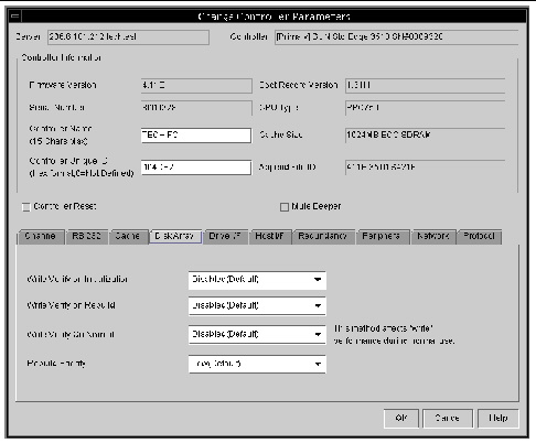

1. From the Change Controller Parameters window, select the Disk Array tab.
2. Select either Disabled or Enabled from the three Write Verify list boxes.
Normally, errors might occur when a hard drive writes data. To avoid the write error, the controller can force the hard drives to verify the written data.
3. Select from the four options available in the Rebuild Priority list box: Low, Normal, Improved, or High.
The RAID controller provides a background rebuilding ability. This means the controller is able to serve other I/O requests while rebuilding the logical drives. The time required to rebuild a drive set largely depends on the total capacity of the logical drive being rebuilt. Additionally, the rebuilding process is totally transparent to the host computer or the OS.

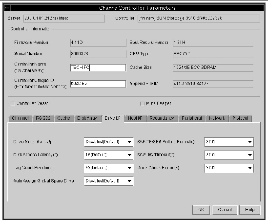

1. From the Change Controller Parameters window, select the Drive I/F tab.
2. From the Drive Motor Spin Up field, select either Disabled or Enabled.
Drive Motor Spin Up determines how the physical drives in a disk array are started. When the power supply is unable to provide sufficient current for all physical drives and controllers that are powered up at the same time, spinning up the physical drives serially requires less current.
If Drive Motor Spin Up is enabled, the drives are powered up sequentially and some of these drives might not be ready for the controller to access when the array powers up. Increase the disk access delay time so that the controller will wait longer for the drive to be ready.
3. Set the Disk Access Latency.
This function sets the delay time before the controller tries to access the hard drives after power on. The default is 15 seconds.
4. Set the Tag Count Per drive.
This is the maximum number of tags that can be sent to each drive at the same time. A drive has a built-in cache that is used to sort all of the I/O requests (tags) that are sent to the drive, enabling the drive to finish the requests faster.
The cache size and maximum number of tags varies between different brands and models of drive. Use the default setting of 32. Changing the maximum tag count to Disable causes the internal cache of the drive to be ignored (not used).
The controller supports tag command queuing with an adjustable tag count from 1 to 128.
5. Select the variable time options shown in the list box from the SAF-TE/SES Polling Period(s) field, or select Disabled to disable this function so that all installed Event Recording Modules (ERMs) are never polled.
If there are remote devices in your RAID enclosure monitored by SAF-TE or SES, use this function to determine the interval after which the controller checks the status of those devices.
6. From the SCSI I/O Timeout(s) field, select from 0.5 through 30 seconds.
The SCSI I/O Timeout is the time interval for the controller to wait for a drive to respond. If the controller attempts to read data from or write data to a drive but the drive does not respond within the SCSI I/O timeout value, the drive is considered a failed drive. The default setting for SCSI I/O Timeout is 30 seconds.
When the drive detects a media error while reading from the drive platter, it retries the previous reading or recalibrates the head. When the drive encounters a bad block on the media, it reassigns the bad block to another spare block on the same disk drive. However, all of this takes time. The time to perform these operations can vary between different brands and models of drives.
During SCSI bus arbitration, a device with higher priority can use the bus first. A device with lower priority sometimes receives a SCSI I/O Timeout when devices of higher priority keep using the bus.
7. From the Drive Check Period(s) field, select from 0.5 through 30 seconds.
The Periodic Drive Check Time is an interval for the controller to check the drives on the SCSI bus. The default value is Disabled, which means if there is no activity on the bus, the controller does not know if a drive has failed or has been removed. Setting an interval enables the program to detect a drive failure when there is no array activity; however, performance is degraded.
8. Auto Assign Global Spare Drive.
This feature is disabled by default. When you enable it, the system automatically assigns a global spare to the minimum drive ID in unused drives. This enables the array to rebuild automatically without user intervention when a drive is replaced.
9. From the Change Controller Parameters window, select the Host I/F tab.
10. Set the Max Queued IO Count.
This function enables you to configure the maximum number of I/O operations per logical drive that can be accepted from servers. The predefined range is from 1 to 1024 I/O operations per logical drive, or you can choose the “Auto Compute” (automatically configured) setting. The default value is 1024 I/O operations per logical drive.
The appropriate setting depends on how many I/O operations the attached servers and the controller itself are performing. This can vary according to the amount of host memory present, the number of drives and their size, and buffer limitations. If you increase the amount of host memory, add more drives, or replace drives with larger drives, you might want to increase the maximum I/O count. But optimum performance usually results from using the “Auto Compute” or “256” settings.
11. (FC and SATA only). Select the type of Fibre Connection.
Sun StorEdge 3510 FC arrays and Sun StorEdge 3511 SATA arrays support the following Fibre connection protocols:
Refer to the Sun StorEdge 3000 Family RAID Firmware User’s Guide for more information about point-to-point and loop protocols.
This function is used to change the maximum number of LUNs you can configure per host ID. Each time a host channel ID is added, it uses the number of LUNs allocated in this setting. The default setting is 32 LUNs, with a predefined range of 1 to 32 LUNs available.
| Note - For the Sun StorEdge 3310 SCSI array and the Sun StorEdge 3320 SCSI array, the maximum number of LUN assignments is 128; therefore, if you use the default setting of 32, you can only add four host channel IDs (4 x 32 = 128). If you added more than four host channel IDs (see Channel Tab), the LUNs Per Host parameter must be set to a value less than 32. |
13. (Optional) To increase the security of the data stored on the array, you can prevent in-band management through a SCSI or FC interface by selecting Disable for In-Band External Interface Management.
Caution - If you are managing the array through in-band, when you select Disable for In-Band External Interface Management, communication with the array is disabled. If you want to continue monitoring this array, select this option only when you are managing the array through out-of-band. For the steps to switch to out-of-band management, see To Use Out-of-Band Management. |
After selecting Disable for In-Band External Interface Management, select the server icon and choose View
View Server
Probe. It takes several minutes for the console to update.
14. If you made changes to the Fibre Connection protocol, for changes to take effect, reset the controller.

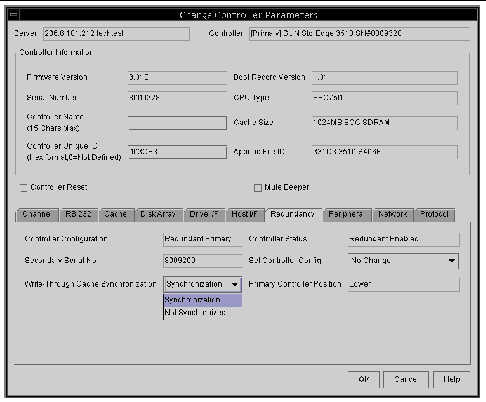

1. From the Change Controller Parameters window, select the Redundancy tab.
2. Select an option from the Set Controller Config field.
3. When an array with redundant controllers is operating with write-back cache enabled, you can disable the synchronization of cache between the two controllers by selecting Not Synchronized from the Write-Through Cache Synchronization list box.
4. For changes to take effect, reset the controller.
5. Click OK to return to the main menu.

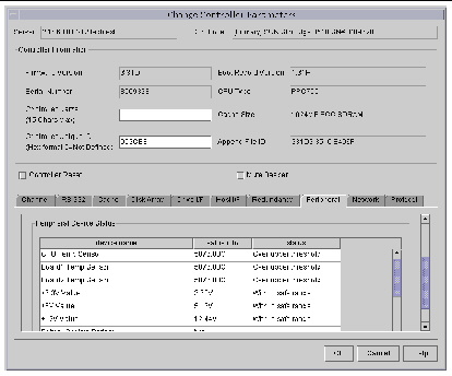

The Peripheral tab enables you to configure the array to dynamically switch write policy from write-back cache to write-through cache when a specified event occurs or threshold is exceeded. Once the problem is corrected, the original write policy is restored. You can also configure the controller to shut down if it exceeds the temperature threshold.
The Peripheral Device Status box enables you to view the status of all environmental sensors for the controller. (For environmental status of the chassis, see View Enclosure.)
1. From the Change Controller Parameters window, select the Peripheral tab.
2. Enable or disable event trigger operations.
If the array is configured with write-back cache enabled, specify whether you want the write policy to dynamically switch from write-back cache to write-through cache when the following events occur:
| Note - Once the problem is corrected, the original write policy is restored. |
If you do not want the write policy to be switched dynamically, set these options to Disable. They are enabled by default.
For more information about write-back and write-through, see To Add a Logical Drive or Logical Volume From New Logical Drives.
3. Enable or disable over-temperature controller shutdown.
If you want the controller to shut down immediately if the temperature exceeds the threshold limit, select Enable in the Temperature Exceeds Threshold field; otherwise, select Disable.
When the controller shuts down, the controller icon in the main window displays a yellow (degraded) device status symbol
4. If you want the controller to shut down after the temperature exceeds the threshold limit but not before a specified interval, select a time from the Temperature Exceeds Threshold Period field:
2. Click the right scroll bar and scroll down until the Peripheral Device Status box is displayed.
3. In the Peripheral Device Status box, click the scroll bar and scroll down to view environmental status information.
The threshold ranges for peripheral devices are set using the firmware application. If a device exceeds the threshold range that was set, its status displays “Over upper threshold.” If a device does not meet the threshold range, its status displays “Under lower threshold.” Both events cause the controller icon in the main window to display a red (critical) device status symbol
For information on how to set the threshold ranges, refer to the Sun StorEdge 3000 Family RAID Firmware User’s Guide.

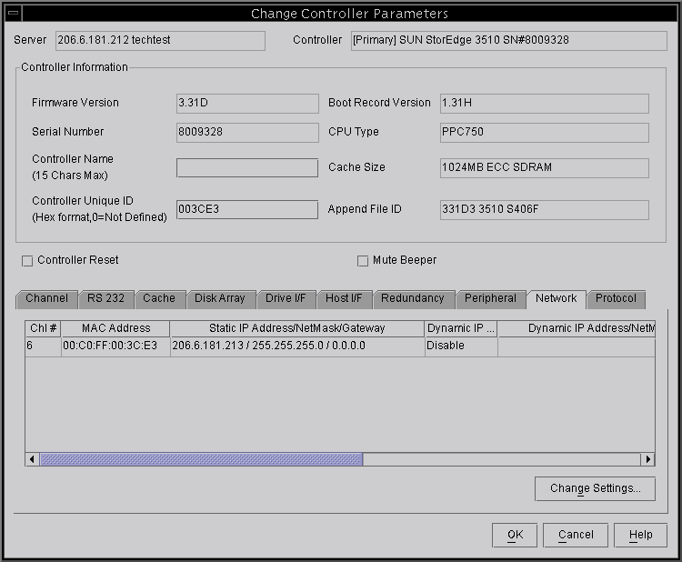

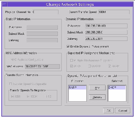

1. From the Change Controller Parameters window, select the Network tab.
1. To manually configure an IP address, subnet mask, or gateway address, click Change Settings.
The Change Network Setting window is displayed.
2. If you have set up an array in an environment with a RARP server:
a. Remove DHCP from the Selected box in the Dynamic IP Assignment Mechanism List.
b. Add RARP to the Selected box in the Dynamic IP Assignment Mechanism List.
| Note - The firmware does not support multiple IP assignment mechanisms. If a protocol is currently selected, you must remove it before adding another protocol. |
3. If you prefer to have a static IP address:
a. Deselect the Enable Dynamic IP Assignment check box.
b. Type the static IP address, the subnet mask, and the gateway IP address into the appropriate boxes under Static IP Information.
5. When prompted to reset the controller, click Yes.

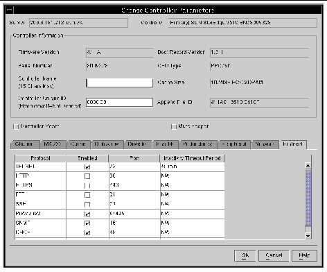

For security reasons, you can enable only the network protocols you want to support, which limits the ways in which security can be breached.
1. From the Change Controller Parameters window, select the Protocol tab.
2. Select which protocols to enable or disable.
The protocols are enabled or disabled by default as follows:
| Note - The PriAgentAll protocol must remain enabled for Sun StorEdge Configuration Service and the CLI to receive information from the controller firmware. Do not disable this protocol. |
When an event occurs that causes the controller to beep, for example, when a logical drive fails, during a rebuild, or when adding a physical drive, you can mute the beeper in one of two ways.
1. Select the desired controller icon in the main window.
4. Click Mute Controller Beeper.
Custom Configure.
3. Select Change Controller Parameters.
| Note - If the alarm is caused by a failed component, muting the beeper has no effect. You need to push the Reset button on the right ear of the array. See View Enclosure for more information about component failure alarms. |

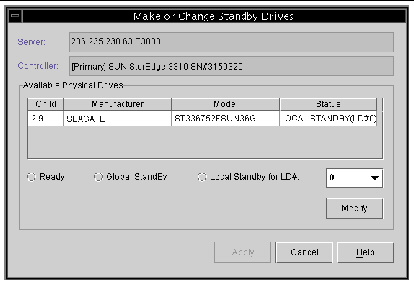

A standby drive acts as a spare to support automatic data rebuilding after a physical drive in a fault-tolerant (non-RAID 0) logical drive fails. For a standby drive to take the place of another drive, it must be at least equal in size to the failed drive and all of the logical drives dependent on the failed disk must be redundant (RAID 1, 3, 5, or 1+0).
With this function you can either assign a global or local standby drive or change a ready drive’s state to standby or a standby drive’s state to ready. A drive that is assigned as a global spare rebuilds if a member of any existing drive fails. You can have one or more standby drives associated with an array controller. Global spares are used in the order in which they are created. A local spare has to be assigned to a particular logical drive and only rebuilds for a member within that logical drive.
1. In the main window, select the desired array controller.
Custom Configure or click the Custom Configuration tool.
If necessary, log into the configuration level of the program with the ssconfig password. The Custom Configuration Options window is displayed.
3. Select Make or Change Standby Drives from the Custom Configuration Options window.
The Make or Change Standby Drives window is displayed.
4. Check the server and the controller IDs at the top of the window.
If you want to select a different server or controller, click Cancel to return to the main window, select the correct server, or controller from the tree view, and repeat Steps 2 and 3.
5. Select a drive to be assigned or changed.
6. Change or assign the drive’s state by selecting Ready, Global StandBy, or StandBy for LD# (local).
8. Click Apply, and then click Close.
9. Whenever you make changes to the configuration, save the new configuration to a file. For details, see Configuration File.

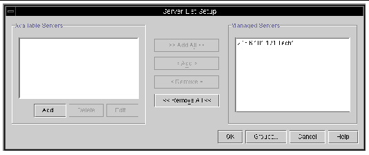

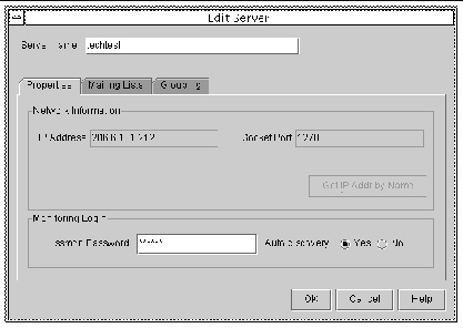

Occasionally, you might need to edit or delete an entry from the Available or Managed Servers lists in the Server List Setup window.
1. Choose File
Server List Setup. The Server Setup window is displayed.
If necessary, move the server name from the Managed Servers list to the Available Servers list in the Server List Setup window. Note that only the server entries in the Available Servers list can be edited.
2. Select the name of the server in the Available Servers list, and click Edit.
The Edit Server window is displayed.
3. Make the necessary changes. Click OK to register your changes.
For descriptions of the fields in this window, see To Add Servers. The Add Server and Edit Server windows contain the same fields.
IP Address Shortcut: If the network address has changed, click Get IP Addr by Name. The program searches for and displays the correct IP address if you typed the name of the server as it is recorded by the name service used by the network.
If the name used for the server is not the same as the server’s network name or if the naming service is not yet updated, delete the server and add it again.
4. Move the server name back to the Managed Servers list.
5. Click OK to exit the Edit Server window.
