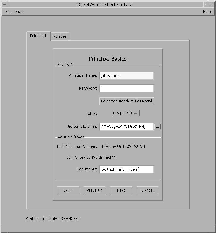

Example--Viewing a Principal's Attributes
The following example shows the first window when viewing the jdb/admin principal.
Graphic

Example--Creating a New Principal
The following example shows the Principal Basics panel when creating a new principal called pak. So far, the policy has been set to testuser.
Graphic

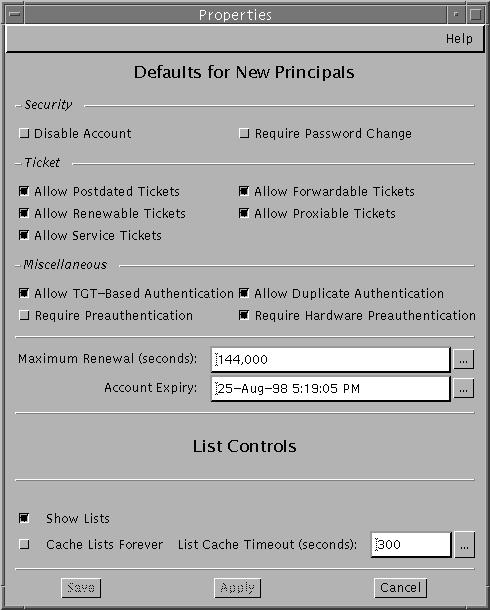

How to Set Up Defaults for Creating New Principals
There is no command-line equivalent for this procedure.
  1. If neccessary, start the SEAM Tool.
    See "How to Start the SEAM Tool" for details.
  2. Choose Properties from the Edit Menu.
    The Properties window is displayed.
    Graphic
  3. Select the defaults you want when you create new principals.
    Choose Context-Sensitive Help from the Help menu to get information about the various attributes in each window.
  4. Click Save.
