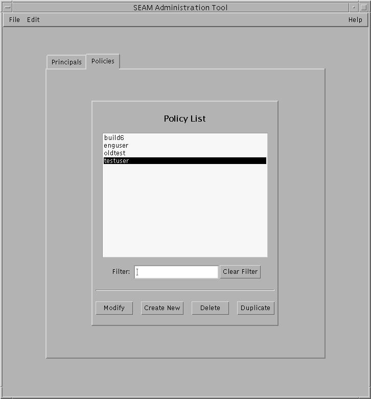

  2. Click the Policies tab.
    The list of policies is displayed.
    Graphic
  3. To display a specific principal or sublist of policies, enter a filter string in the Filter Pattern field and press return. If the filter succeeds, the list of policies matching the filter is displayed.
    The filter string must consist of one or more characters. And, because the filter mechanism is case sensitive, you need to use the appropriate uppercase and lowercase letters for the filter. For example, if you enter the filter string ge, the filter mechanism will display only the policies with the ge string in them (for example, george or edge).
    If you want to display the entire list of policies, click Clear Filter.

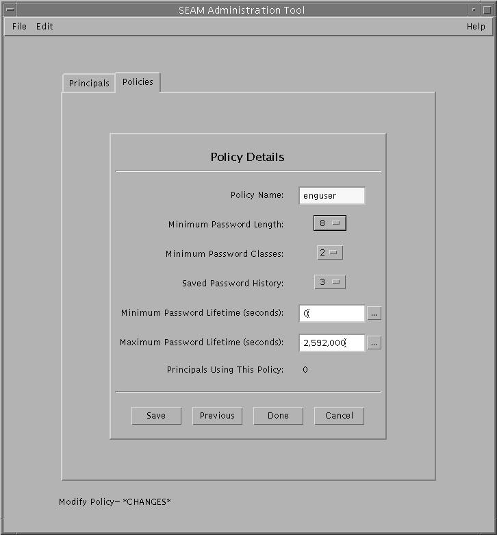

  3. Select the policy in the list that you want to view and click Modify.
    The Policy Details panel is displayed.
  4. When you are finished viewing, click Cancel.
Example--Viewing a Policy's Attributes
The following example shows the Policy Details panel when viewing the test policy.
Graphic
