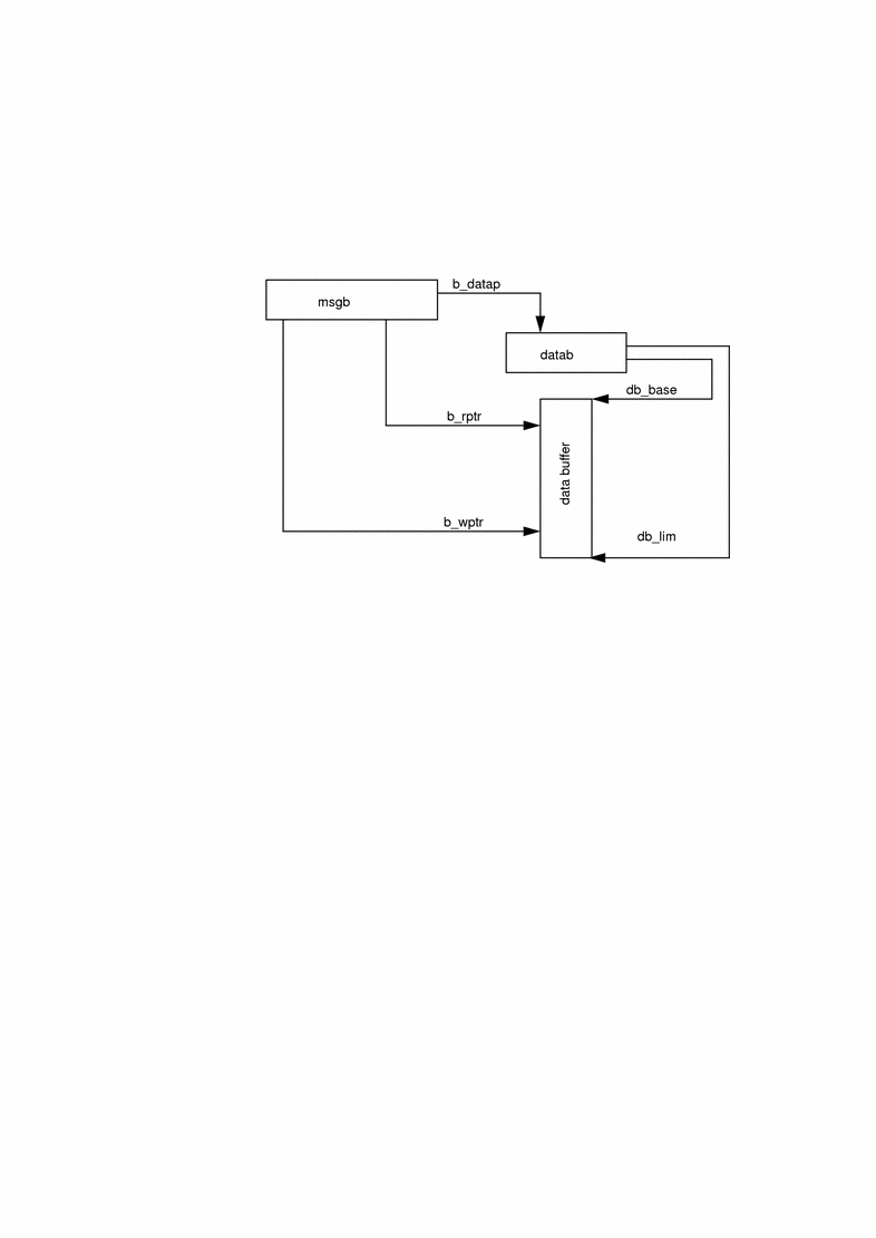

Message Structure
A STREAMS message in its simplest form contains three elements--a message block, a data block, and a data buffer. The data buffer is the location in memory where the actual data of the message is stored. The data block (datab(9S) describes the data buffer--where it starts, where it ends, the message types, and how many message blocks reference it. The message block (msgb(9S)) describes the data block and how the data is used.
The data block has a typedef of dblk_t and has the following public elements:
struct datab {
	unsigned char			*db_base;				/* first byte of buffer */
	unsigned char			*db_lim;					/* last byte+1 of buffer */
	unsigned char			 db_ref;					/* msg count ptg to this blk */
	unsigned char			 db_type;				/* msg type */
typedef struct datab dblk_t;
The datab structure specifies the data buffers' fixed limits (db_base and db_lim), a reference count field (db_ref), and the message type field (db_type). db_base points to the address where the data buffer starts, db_lim points one byte beyond where the data buffer ends, db_ref maintains a reference count of the number of message blocks sharing the data buffer.
Note -
db_base, db_lim, and db_ref should not be modified directly. db_type are modified under certain conditions, such as changing the message type to reuse the nessage block, provided care is taken.
In a simple message, the message block references the data block, identifying for each message the address where the message data begins and ends. Each simple message block refers to the data block to identify these addresses, which must be within the confines of the buffer such that db_base >= b_rptr >=>= b_wptr >= db_lim. For ordinary messages a priority band can be indicated, and this band is used if the message is queued.
Figure 7-1shows the linkages between msgb, datab, and data buffer in a simple message.
Figure 7-1 Simple Message Referencing the Data Block
Graphic
The message block has a typedef of mblk_t and has the following public elements:

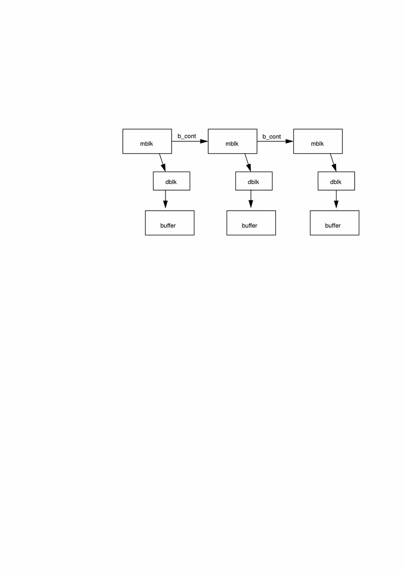

Message Linkage
A complex message can consist of several linked message blocks. If buffer size is limited or if processing expands the message, multiple message blocks are formed in the message, as shown in Figure 7-2. When a message is composed of multiple message blocks, the type associated with the first message block determines the overall message type, regardless of the types of the attached message blocks.
Figure 7-2 Linked Message Blocks
Graphic

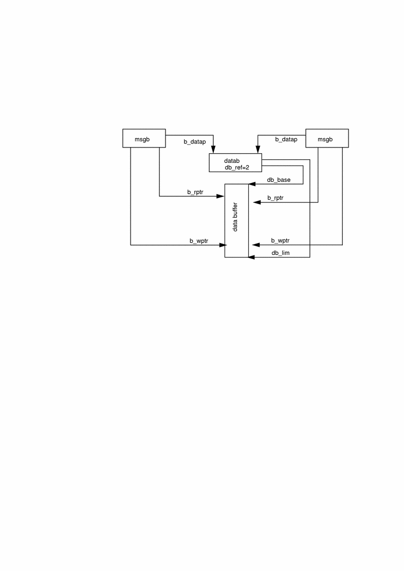

Shared Data
In Figure 7-4, two message blocks are shown pointing to one data block. db_ref indicates that there are two references (mblks) to the data block. db_base and db_lim point to an address range in the data buffer. The b_rptr and b_wptr of both message blocks must fall within the assigned range specified by the data block.
Figure 7-4 Shared Data Block
Graphic
Data blocks are shared using utility routines (see dupmsg(9F) or dupb(9F)). STREAMS maintains a count of the message blocks sharing a data block in the db_ref field.
These two mblks share the same data and datablock. If a module changes the contents of the data or message type it is visible to the owner of the message block.
When modifying data contained in the dblk or data buffer, if the reference count of the message is greater than one, it is recommended that the module copy the message using copymsg(9F), free the duplicated message, and then change the appropriate data.

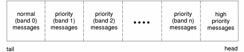

Message Queues and Message Priority
Message queues grow when the STREAMS scheduler is delayed from calling a service procedure by system activity, or when the procedure is blocked by flow control. When called by the schedule,r a module's service procedure processes queued messages in a first-in, first-out (FIFO) manner (getq(9F)). However, some messages associated with certain conditions, such as M_ERROR, must reach their Stream destination as rapidly as possible. This is accomplished by associating priorities with the messages. These priorities imply a certain ordering of messages in the queue, as shown in Figure 7-5. Each message has a priority band associated with it. Ordinary messages have a priority band of zero. The priority band of high-priority messages is ignored, since, after all, they are high priority and thus not affected by flow control. putq(9F) places high-priority messages at the head of the message queue, followed by priority band messages (expedited data) and ordinary messages.
Figure 7-5 Message Ordering in a Queue
Graphic
When a message is queued, it is placed after the messages of the same priority already in the queue (in other words, FIFO within their order of queueing). This affects the flow-control parameters associated with the band of the same priority. Message priorities range from 0 (normal) to 255 (highest). This provides up to 256 bands of message flow within a Stream. An example of how to implement expedited data would be with one extra band of flow (priority band 1) of data, as shown in Figure 7-6. Queues are explained in detail in the next section.
Figure 7-6 Message Ordering with One Priority Band
Graphic
High-priority messages are not subject to flow control. When they are queued by putq(9F), the associated queue is always scheduled even if the queue has been disabled (noenable(9F)). When the service procedure is called by the Stream's scheduler, the procedure uses getq(9F) to retrieve the first message on queue, which is a high-priority message, if present. Service procedures must be implemented to act on high-priority messages immediately. The mechanisms just mentioned--priority message queueing, absence of flow control, and immediate processing by a procedure--result in rapid transport of high-priority messages between the originating and destination components in the Stream.
