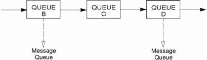

The queue is the fundamental component of a Stream. It is the interface between a STREAMS module and the rest of the Stream, and is the repository for deferred message processing. For each instance of an open driver or pushed module or Stream head, a pair of queues is allocated, one for the read side of the Stream and one for the write side.
The RD(9F), WR(9F), and OTHERQ(9F) routines allow reference of one queue from the other. Given a queue RD(9F) returns a pointer to the read queue, WR(9F) returns a pointer to the write queue and OTHERQ(9F) returns a pointer to the opposite queue of the pair. Also see QUEUE(9S).
By convention, queue pairs are depicted graphically as side- by-side blocks, with the write queue on the left and the read queue on the right (see Figure Figure 7-7).
As previously discussed, messages are ordered in message queues. Message queues, message priority, service procedures, and basic flow control all combine in STREAMS. A service procedure processes the messages in its queue. If there is no service procedure for a queue, putq(9F) does not schedule the queue be to run. The module developer must ensure that the messages in the queue are processed. Message priority and flow control are associated with message queues.

Flow control operates as follows:
Each time a STREAMS message-handling routine (for example, putq(9F)) adds or removes a message from a message queue, the limits are checked. STREAMS calculates the total size of all message blocks (bp->b_wptr - bp->b_rptr) on the message queue.
The total is compared to the queue high and low watermark values. If the total exceeds the high watermark value, an internal full indicator is set for the queue. The operation of the service procedure in this queue is not affected if the indicator is set, and the service procedure continues to be scheduled.
The next part of flow control processing occurs in the nearest preceding queue that contains a service procedure. In Figure 7-12, if D is full and C has no service procedure, then B is the nearest preceding queue.
The service procedure in B uses canputnext(9F) to check if a queue ahead is marked full. If messages cannot be sent, the scheduler blocks the service procedure in B from further execution. B remains blocked until the low watermark of the full queue, D, is reached.
While B is blocked, any messages except high-priority messages arriving at B accumulate on its message queue (recall that high-priority messages are not subject to flow control). Eventually, B can reach a full state and the full condition propagates back to the preceding module in the Stream.
When the service procedure processing on D causes the message block total to fall below the low watermark, the full indicator is turned off. STREAMS then schedules the nearest preceding blocked queue (B in this case). This automatic scheduling is called back-enabling a queue.
