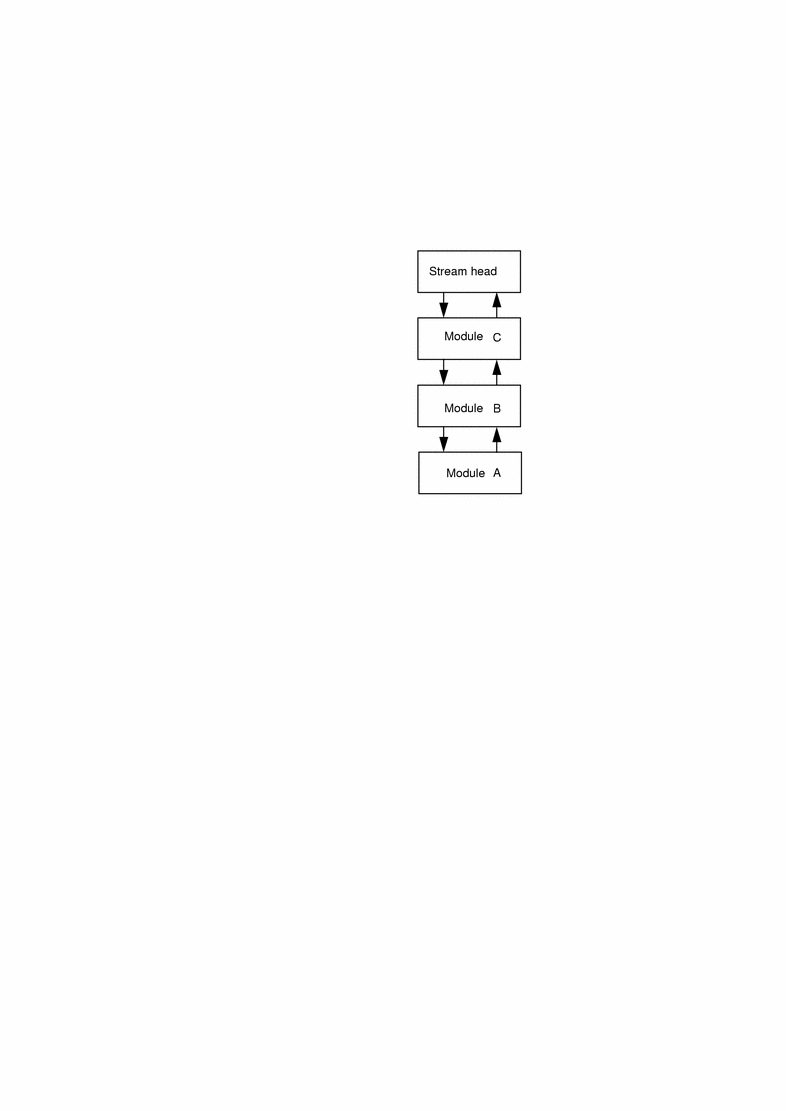

The Stream is analogous to a stack. Initially the driver is opened, and as modules are pushed onto the Stream their open routines are invoked. Once the Stream is built, if a reopen of the Stream occurs, this order reverses. For example, while building the Stream shown in Figure 7-8, device A's open routine is called, followed by B's and C's, when they are pushed onto the Stream. If the Stream is reopened Module C's open routine is called first, followed by B's, and finally by A's.
Usually the module or driver does not check this, but the issue is raised so that dependencies on the order of open routines are not introduced by the programmer. Note that although an open can happen more than once, close is only called once. See the next section on the close routine for more details. If a file is duped (dup(2)) the Stream is not reopened.

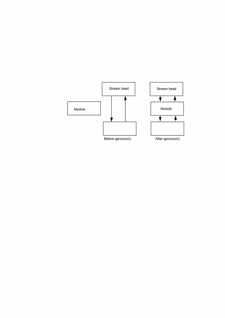

In a multithreaded environment, data can flow up the Stream during the open. A module receiving this data before its open routine finishes initialization can panic. To eliminate this problem, modules and drivers are not linked into the Stream until qprocson(9F) is called. In other words, messages flow around the module until qprocson(9F) is called. Figure 7-9illustrates this process.
The module or driver instance is guaranteed to be single-threaded before qprocson(9F) is called except for interrupts or callbacks which must be handled separately. qprocson(9F) must be called before calling qbufcall(9F), qtimeout(9F), qwait(9F), or qwait_sig(9F).

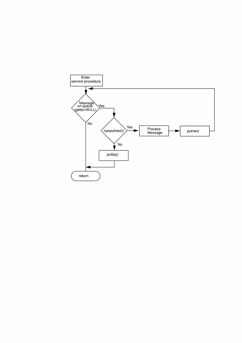

Figure 7-10 shows typical processing flow for a service procedure which works as follows:
When the system goes from kernel mode to user mode, the STREAMS scheduler calls the service procedure.
The service procedure gets the first message (q_first) from the message queue by using the getq(9F) utility.
The put procedure determines if the message can be sent to the next module by the use of canput(9F) or canputnext(9F).
If the next module is flow controlled, the put procedure requeues the message with putbq(9F), and then returns.
If the next module is not flow controlled, the service procedure processes the message and passes it to the put procedure of the next queue with putnext(9F).
The service procedure gets the next message and processes it. This processing continues until the queue is empty or flow control blocks further processing. The service procedure returns to the caller.
