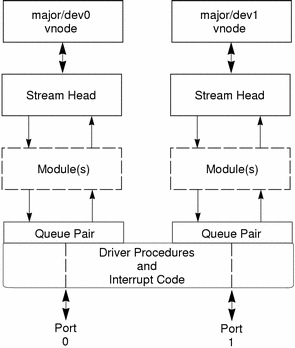

Figure 9-1shows multiple Streams (corresponding to minor devices) connecting to a common driver. There are two distinct Streams opened from the same major device. Consequently, they have the same streamtab and the same driver procedures.
Multiple instances (minor devices) of the same driver are handled during the initial open for each device. Typically, a driver stores the queue address in a driver-private structure "uniquely identified" by the minor device number. (The DDI/DKI provides a mechanism for uniform handling of driver-private structures; see ddi_soft_state(9F)). The q_ptr of the queue points to the private data structure entry. When the messages are received by the queue, the calls to the driver put and service procedures pass the address of the queue, allowing the procedures to determine the associated device through the q_ptr field.
