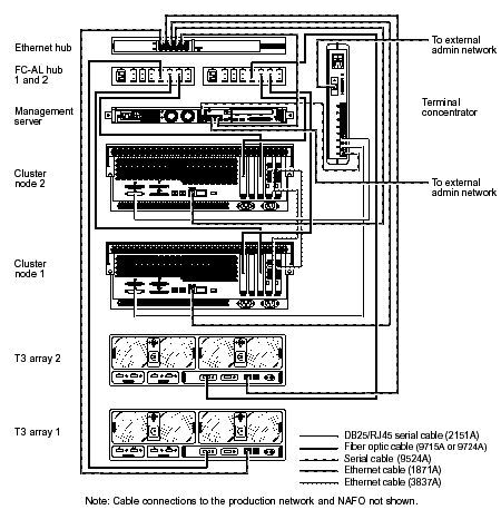

FIGURE A-1 Cluster Platform 280/3 Cabling

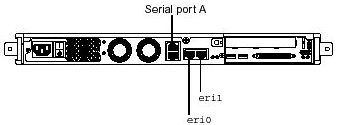

FIGURE A-2 Netra T1 200 Server (Management Server) Rear View Connectors

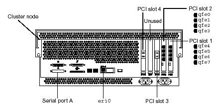

FIGURE A-3 Sun Fire 280R Server (Cluster Nodes) Rear View Connectors

The following tables list factory configured cable connections.
TABLE A-3 Disk Array to Hub Connections
From Device
From Location
To Device
To Location
Cable Length/Type
Disk array 1 (mirror)
FC-AL port
FC-AL hub 1
Port 3
15 m/FC-AL
Disk array 2 (data)
FC-AL port
FC-AL hub 2
Port 3
15 m/FC-AL
10BASE-T
Ethernet hub
Port 1
4 m/Ethernet
Disk array 2 (data)
10BASE-T
Ethernet hub
Port 2
4 m/Ethernet
TABLE A-4 FC100 Hub to Server Connections
From Device
From Location
To Device
To Location
Cable Length/Type
FC-AL hub 1
Port 4
Node 1
PCI slot 3
5 m/FC-AL
FC-AL hub 1
Port 5
Node 2
PCI slot 3
5 m/FC-AL
FC-AL hub 2
Port 5
Node 1
PCI slot 4
5 m/FC-AL
FC-AL hub 2
Port 4
Node 2
PCI slot 4
5 m/FC-AL
TABLE A-5 Management Server Connections
From Device
From Location
To Device
To Location
Cable Type
Management server
Serial port A
Terminal concentrator
Serial port 1
Serial
Management server
eri1
Ethernet hub
Port 5
Ethernet
Management server
eri0
See TABLE A-2
TABLE A-6 Terminal Concentrator Connections
From Device
From Location
To Device
To Location
Cable Type
Serial port 1
Management server
Serial port A
Serial
Serial port 2
Node 1
Serial port A
DB-25 serial/RJ-45
Serial port 3
Node 2
Serial port A
DB-25 serial/RJ-45
Ethernet port
See TABLE A-2
TABLE A-7 Node to Node Connections
From Device
From Location
To Device
To Location
Cable Length/Type
Node 1
PCI slot 2, qfe1
Node 2
PCI slot 2, qfe1
5 m/Null Ethernet
Node 1
PCI slot 1, qfe5
Node 2
PCI slot 1, qfe5
5 m/Null Ethernet
TABLE A-8 Ethernet Hub Connections
From Device
From Location
To Device
To Location
Cable Type
Ethernet hub
Port 1
Disk array 1 (node 1)
10/100 BASE-T port
Ethernet
Ethernet hub
Port 2
Disk array 2 (node 2)
10/100 BASE-T port
Ethernet
Ethernet hub
Port 5
Management server
eri1
Ethernet
Ethernet hub
Port 3
Node 1
eri0
Ethernet
Ethernet hub
Port 4
Node 2
eri0
Ethernet
