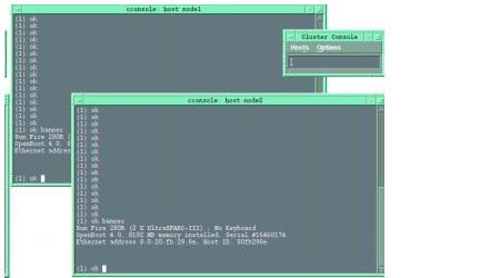

This command displays the Cluster Control Panel (FIGURE 3-3).
5. In the Cluster Control Panel window, double-click on the cconsole icon to display a Cluster Console window for each cluster node (FIGURE 3-4).
To type text into both node windows simultaneously, click the cursor in the Cluster Console window and type the text. The text does not display in the Cluster Console window. This ensures that both nodes execute the commands simultaneously.
6. In the Cluster Console window, type the following command into both nodes simultaneously:
boot net - install |
boot net - You must use spaces before and after the hyphen (-) character in the
