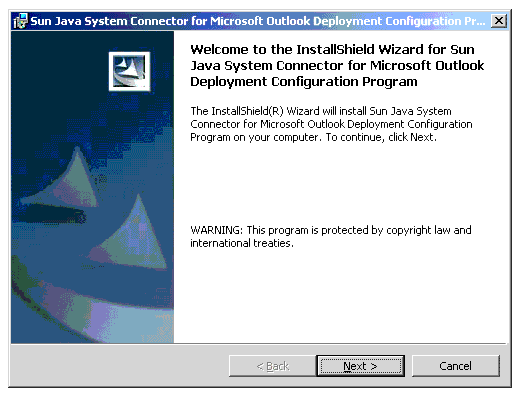

  1. Locate the Sun Java System Connector for Microsoft Outlook setup file, Setup.exe, that you have downloaded or otherwise copied to your computer. Double-click the filename to start the program.
  2. The InstallShield Wizard then welcomes you to the process and prompts you to click the Next button to continue, as shown in Figure 1-1.
    Figure 1-1  The InstallShield Wizard Welcome Screen
  3. Click the Next button.

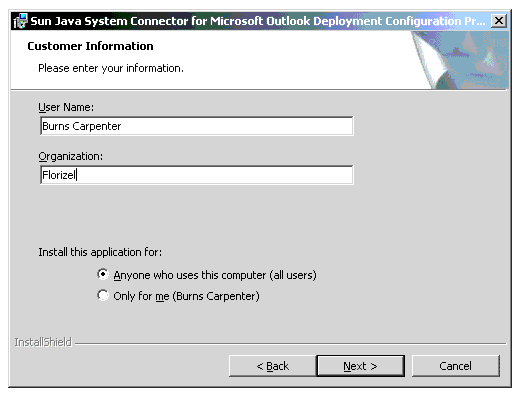

  4. The InstallShield Wizard then prompts you to enter your customer information, as shown in Figure 1-2.
    Figure 1-2  InstallShield Wizard: Customer Information
  5. Enter your User Name and Organization, and choose whether you want the Connector for Microsoft Outlook software to be available to all users of this computer, or only to your User Name. Then click Next.
