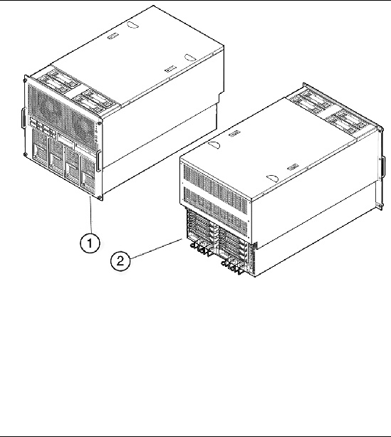

FIGURE 1-2 illustrates the M5000 server.
FIGURE 1-2 M5000 Server
Figure Legend
