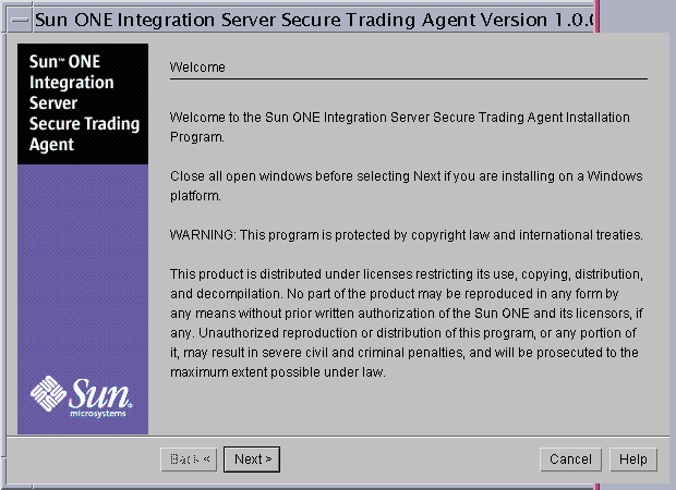

The setup program installs the Sun Management Center and then opens the Secure Trading Agent Installer.
Figure 1    Secure Trading Agent Installation Program
- Select Next to continue, and then read and accept the Software License Agreement.

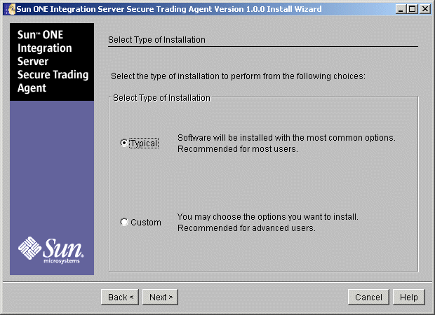

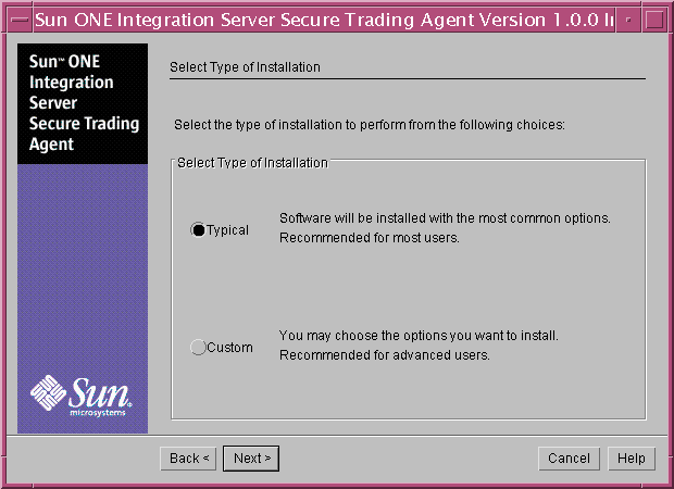

After accepting the Software License Agreement, the installer displays the types of installations.
Figure 2    Select Installation Type
- Select an installation type and select Next.
- Select Typical to install Secure Trading Agent using default startup values.
A Typical install automatically starts Secure Trading Agent services when the installation completes. A Typical install also configures Secure Trading Agent to automatically start Secure Trading Agent at system startup.
- Select Custom to install Secure Trading Agent and disable automatic startup of Secure Trading Agent services. (The Custom options appear after Step 9.)

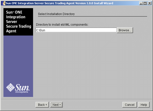

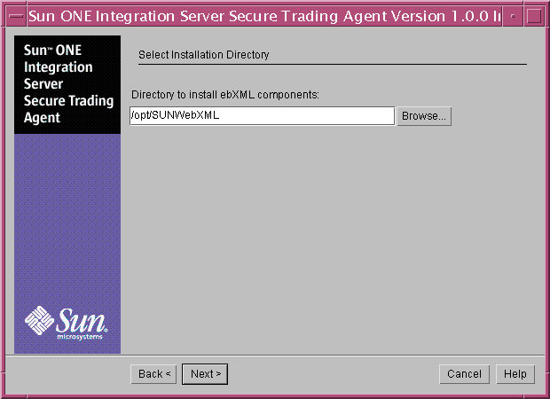

The Installer prompts you for a location for your Secure Trading Agent installation.
Figure 3    Select Installation Directory
- Accept the default location or specify another location and select Next.

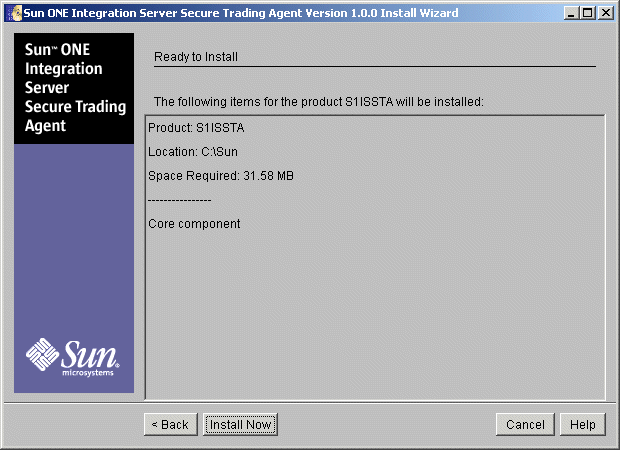

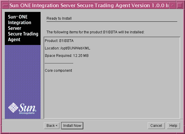

Figure 4    Ready to Install
- Select Install Now to begin the installation.

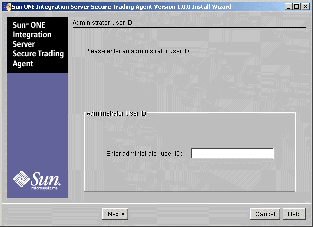

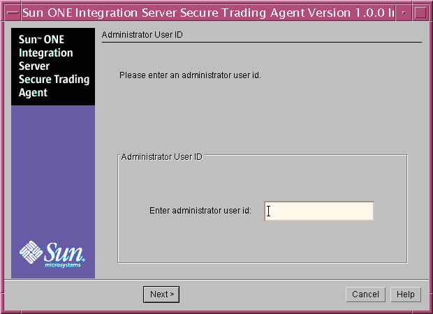

The Installer prompts you for the user name of the Secure Trading Agent administrator.
Figure 5    Administrator User Id
- Enter the user name for the Secure Trading Agent administrator, who should be a valid user on your system, and select Next.
Caution
The Secure Trading Agent installer does not validate the administrator user Id that you specify here. If you specify a user that is not on your system, you will not have administrator access to start up or stop the message handler service. The section "Configuration of Secure Trading Agent" discusses how to reconfigure Secure Trading Agent should this situation occur.

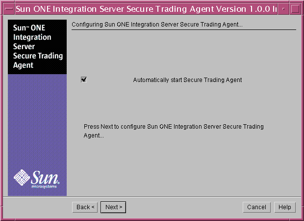

(Custom Install only) If you selected the Custom Install option in Step 6, the installer displays the Custom Option dialog. Select or deselect the Automatically Start Services toggle and select Next.
Figure 6    Custom Installation Startup Option

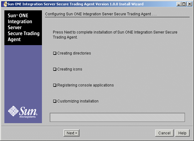

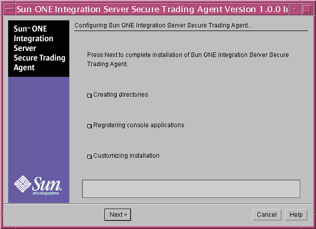

The installer then prompts you to continue with the configuration process.
Figure 7    Configure Secure Trading Agent
- Select Next to configure Secure Trading Agent and complete the installation.
The installation may take several minutes to complete.

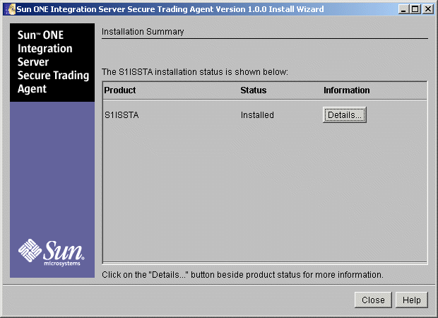

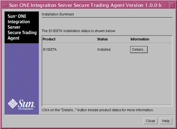

When the installation is complete, the Installer displays a summary of the installation process.
Figure 8    Installation Summary
- Select Details to view the installation log, then select Close to exit the installer.

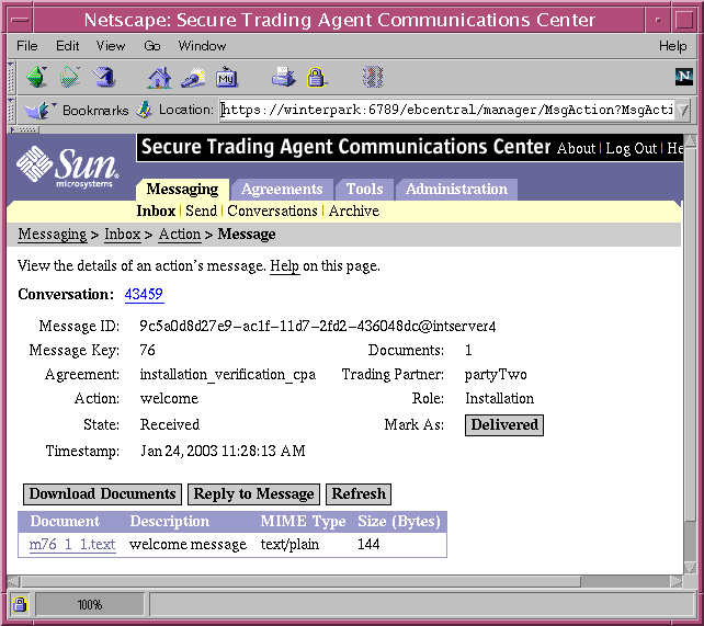

https://<Server>:6789
Server is the machine on which you installed Secure Trading Agent.
From the Sun Management Center, you can launch the Secure Trading Agent Communications Center.

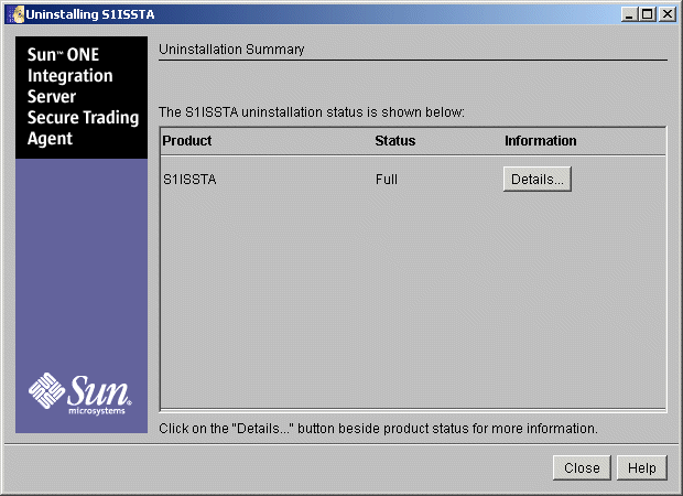

- Run the uninstaller, as illustrated below:
java -cp . uninstall_S1ISSTA
Figure 9    Secure Trading Agent Uninstall Program
- Follow the prompts of the Uninstall program until the uninstall is complete.

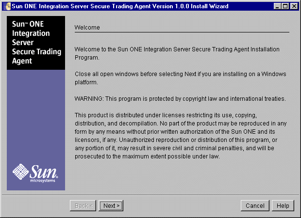

- From the Secure Trading Agent distribution, run the S1ISSTA-1_0_0-win.exe program.
The program extracts the necessary files and launches the Secure Trading Agent Installer.
Figure 10    Secure Trading Agent Installation Program
Figure 11    Select Installation Type
- Select Custom to install Secure Trading Agent and disable automatic startup of Secure Trading Agent services. (The Custom Option dialog appears after Step 9.)
Figure 12    Select Installation Directory
All components must be installed, so continue through the Installer to the Ready to Install screen.
Figure 13    Ready to Install
Figure 14    Administrator User Id
Caution
Figure 15    Automatic Startup Option

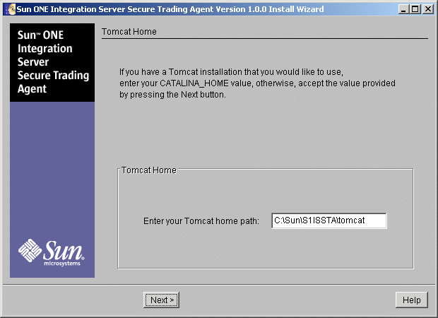

The installer then prompts you to specify the Tomcat web server home directory.
Figure 16    Specify Tomcat Web Server Home Directory
- Specify a path to the Tomcat web server directory and select Next.
The installer prompts you with the default location. After you specify the location for the Tomcat web server directory, the installer prompts you to continue with the configuration process.
Figure 17    Configure Secure Trading Agent
Figure 18    Installation Summary

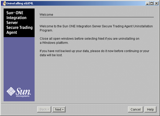

- From the Start > Programs > Sun Microsystems menu, select: Secure Trading Agent > Utilities > Uninstall
The Secure Trading Agent uninstall program window appears.
Figure 19    Windows Uninstall Welcome Screen
- Select Next.

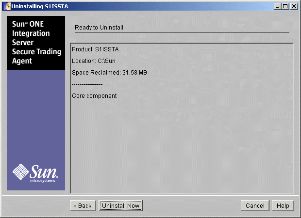

The screen shows all Secure Trading Agent components to uninstall.
Note The Secure Trading Agent uninstall utility does not uninstall the Java 2 SDK.
Figure 20    Windows List of Components to Uninstall
- Select Uninstall Now.

When the uninstall is complete, the Uninstall utility displays a summary of the uninstall process.
Figure 22    Windows Uninstall Details
- Select Details to review details of the uninstall, then select Close to exit the uninstall utility.

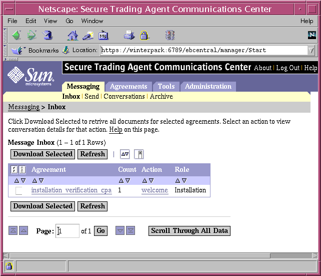

- Log into the Sun Management Center as the Secure Trading Agent administrator, and then select the Secure Trading Agent Communications Center application.
The Messaging Inbox displays a single message.
Figure 24    Secure Trading Agent Messaging Inbox
If the Inbox does not display the message, wait a few moments, then navigate to the Inbox from the Messaging tab and select Refresh.

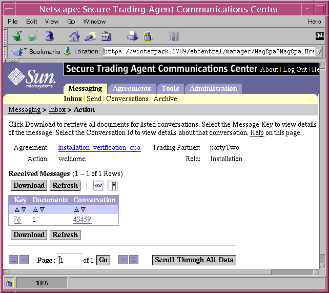

- In the Inbox, select the Welcome action.
Figure 25    Messages Received
- In the Received Messages list, select the Key for the message to view the message details.
Figure 26    Messages Details

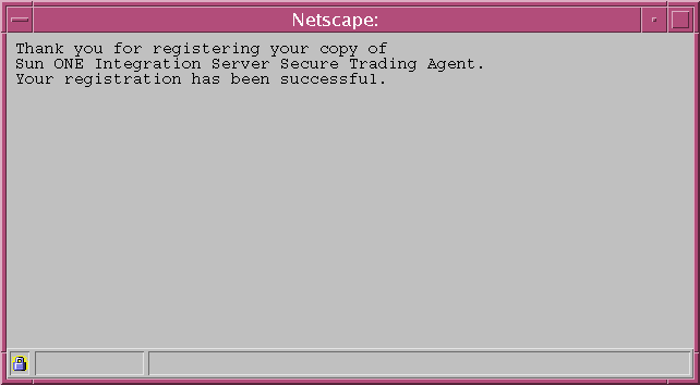

- Select the link for the document to view the Registration Success message from the Sun registration server.
Figure 27    Messages Details
