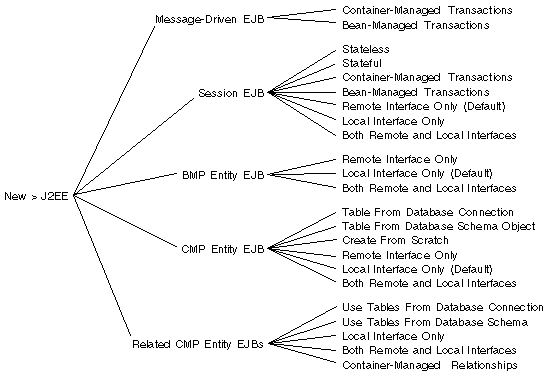

FIGURE 2-1 shows the basic choices before you when you use the IDE's template to create enterprise beans.
 FIGURE 2-1 Basic Choices About Enterprise Beans in the Forte for Java IDE
Figure showing your choices regarding how to create enterprise beans in the EJB Builder wizard.[ D ]
