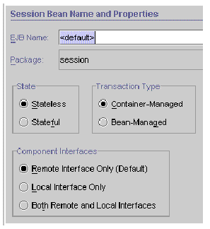

In the EJB Builder's Session Bean Name and Properties pane, you must make choices about state, transaction type, and type of interfaces. Do as follows:
1. Type a name for your session bean, and select the type of session bean you need.
Click the appropriate buttons to specify your bean's state, transaction mode, and which type of interfaces to implement. FIGURE 3-1 shows your choices. Notice the defaults: Stateless, Container-Managed, and Remote Interface Only.
 FIGURE 3-1 Possible Wizard Selections for a Stateless (or Stateful BMT) Session Bean
Screenshot showing the EJB Builder Wizard's first pane and selections for a session bean.
Note - The selections you make in this first pane of the wizard determine the code that the wizard generates. If you later want to change any of these most basic selections, you can use the bean's property sheets, as described in Chapter 8.

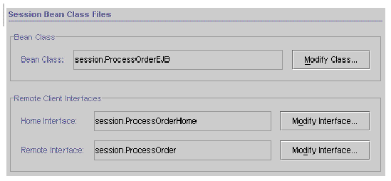

The Session Bean Class Files pane appears as shown next for a stateless session bean.
Screenshot showing the EJB Builder Wizard's second pane, listing the classes about to be generated for a session bean.

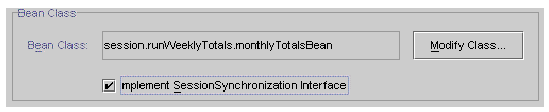

For a stateful session bean, you have an additional selection to make: Session Synchronization.
Screenshot showing part of the EJB Builder Wizard's second pane, with the Implement Session Synchronization Interface checkbox selected.
This selection is explained in TABLE 3-4 and in Using Session Synchronization.
3. Check the bean class and interfaces, and change them if necessary.
The classes that make up your session bean are shown with their paths in this pane.
If you specify any classes outside the named package, the resulting bean classes appear differently than shown in FIGURE 3-2.
Before you change these fields, also consider the following points:
4. Click Finish when you're done.

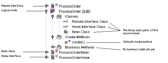

Looking at a Session Bean's Classes
The EJB Builder wizard generates the default session bean classes for you and sets up the relationships between all the classes. FIGURE 3-2 shows how a typical session bean (all of whose classes are in the same package) appears in the Explorer's Filesystems pane.
 FIGURE 3-2 Default Classes of a Typical Session Bean With Remote Interfaces
Screenshot showing the typical classes generated for a session bean.[ D ]
The nodes marked with the class icon Class node icon. represent classes of the session bean. The node marked with the bean icon Bean icon. is a logical node for the session bean. Do all your editing in the logical node. The example bean's primary nodes are described next.

Under the bean's logical node, expand the Classes node, select Bean Class, right-click, and choose Open.

To add the session-synchronization interface to your session bean, make the following choices in the wizard:
1. In the first pane of the session bean wizard, in the State section, choose Stateful.
2. In the second pane of the wizard, choose Implement Session Synchronization Interface.
If you make these selections, code like that shown in CODE EXAMPLE 3-4 is inserted into your session bean class. In the example, checkingBalance and savingBalance variables have been loaded into the afterBegin method.
