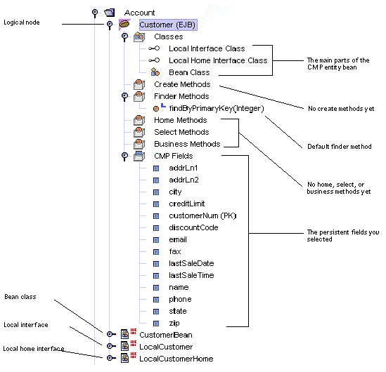

The logical node is the best place from which to work with an entity bean. All logical nodes appear in the Explorer with this icon:Logical node icon.
From an entity bean's logical node, you can validate the bean, add methods to its classes, add fields, specify deployment-related properties for the bean, create an EJB module to facilitate the bean's deployment in a production application. You can also use the IDE's testing feature against your bean.

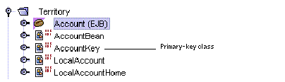

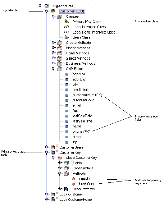

5. If necessary, add a primary-key class.

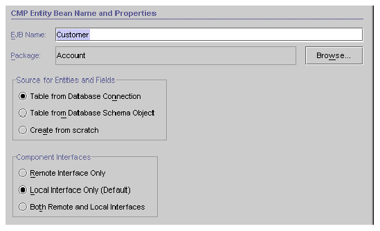

In the EJB Builder`s CMP Entity Bean Name and Properties pane, as shown in FIGURE 4-1, you name your CMP entity bean. Here, you also make choices about where your bean will get its persistent fields and which kinds of interfaces your bean will have. You can also change the bean's package location, if you like.
 FIGURE 4-1 Selections in the EJB Builder Wizard for CMP Entity Beans
Screenshot showing the wizard's first pane and selections for a CMP entity bean. [ D ]
The following tables describe these selections and point to your next instructions in this chapter.
In the radio-button box labeled Source for Entities and Fields, consider the following selections.
Table From Database Connection
Select this if your CMP entity bean will represent a table from an existing database.
See Selecting a Table From a Database Connection.
Table From Database Schema Object
Select this if you have a database schema available, and you don't want to connect to a live database.
See Selecting a Table From a Database Schema Object.
Create From Scratch
Select this if you will specify all the CMP fields yourself.
See Creating Your Bean's Persistent Fields From Scratch.
In the radio-button box labeled Component Interfaces, consider the following selections.
Remote Interface Only
Select this if an external client calls methods on your CMP entity bean, and your bean is never called by local clients.
Local Interface Only (Default)
Leave this selection active if your bean is called only through its local interfaces, never directly by an external client.

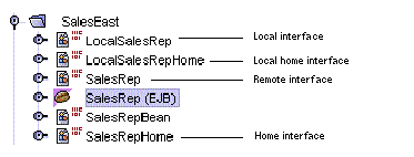

Both Remote and Local Interfaces
Select this if your bean is called by both external and local clients (which can also be other beans).
When you have made your selection, the wizard presents appropriate follow-up tasks, which are described next.

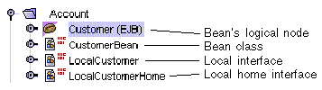

Your CMP entity bean's infrastructure is generated automatically by the EJB Builder. See Looking at a CMP Entity Bean's Classes for more discussion.

7. Click Finish.
Your CMP entity bean's infrastructure is generated automatically by the EJB Builder Wizard. Now let's look at the generated classes.
The EJB Builder wizard generates the default CMP entity bean classes for you and sets up the relationships between all the classes. FIGURE 4-2 shows how a typical CMP entity bean appears in the Explorer's Filesystems pane. In this example, the default, Local Interface Only, is in effect. This bean is called only by other application components running in the same JVM.
 FIGURE 4-2 Default Classes of a Typical CMP Entity Bean
Screenshot showing the classes generated for a typical CMP entity bean with local-type interfaces.[ D ]
Of the four nodes shown in FIGURE 4-2, three represent actual classes (marked with class icons) and one is a logical node (marked with a bean icon). Do all your editing in the logical node. The example bean's primary nodes are described next.
If you created a primary-key class (for example, if your bean has a composite primary key), the Explorer shows an additional node for your bean.
Screenshot showing the classes generated for a CMP entity bean that has a primary key class in addition to a bean class and local-type interfaces.
If you chose Both Remote and Local Interfaces (if your bean might be used both by beans in their own application's JVM and by beans in another JVM), the resulting CMP entity bean has all four interfaces.
Screenshot showing the classes generated for a CMP entity bean that has both local-type and remote-type interfaces.
Expanding the Nodes
When you expand the nodes under your entity bean's package node, you see something like the tree view in FIGURE 4-3. (In this case, the default, Local Interface Only, has been used.)
 FIGURE 4-3 Explorer's Detailed View of a Typical CMP Entity Bean With Local Interfaces
Screenshot showing expanded tree view of the Java package BankData and the nodes of the CMP entity bean it contains.[ D ]
If you generated a new primary-key class, it appears in the Explorer as shown in FIGURE 4-4.
 FIGURE 4-4 Explorer's Detailed View of a Typical CMP Entity Bean With a Composite Primary Key
Screenshot showing the classes generated for another example CMP entity bean that has a primary key class. [ D ]
