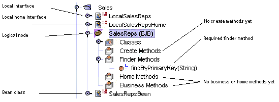

Expanding the Nodes
When you expand the nodes under your BMP entity bean's package node, you see something like the tree view in FIGURE 6-1. In this case, the bean has been assigned local-type interfaces. Notice that a BMP entity bean can have no select methods.
 FIGURE 6-1 Explorer's Detailed View of a BMP Entity Bean
Screenshot showing the expanded nodes of a BMP entity bean in the Explorer window. [ D ]
If you generated a primary-key class, it shows up in the Explorer as another major node.
