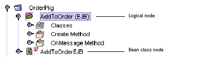

Looking at Your Message-Driven Bean in the Explorer
FIGURE 7-1 shows how a typical message-driven bean appears in the Explorer's Filesystems pane.
 FIGURE 7-1 Default Class and Methods of a Typical Message-Driven Bean
Screenshot showing the generated elements of a message-driven bean as shown in the Explorer window. [ D ]
Of the two primary nodes shown, one is a logical node (marked with a bean icon) and one represents the actual class (marked with a class icon). Do all your editing in the logical node. The bean's two primary nodes are described next.
The Classes node contains the bean class code, which includes both methods. The Create Method node points to the code that initializes your message-driven bean. The OnMessage Method node points to the method that is invoked when a message is received.

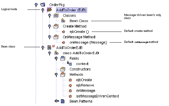

Expanding the Nodes
When you expand the two nodes under your message-driven bean's package node, you see something like the tree view in FIGURE 7-2.
 FIGURE 7-2 Explorer's Detailed View of a Typical Message-Driven Bean
Screenshot showing an expanded tree view of the example message-driven bean AddToOrder.[ D ]
