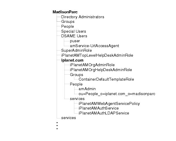

The DSAME base suffix that is created during installation is designed for storing and managing user data. Special object classes identify the user and group entries in the directory that will be managed by DSAME. These object classes make it possible for DSAME to manage only selected datauser dataand not interfere with other aspects of your tree such as servers or hardware.
Figure 2-1    A Default Directory Information Tree (DIT).
Default DITs
A default DIT is simply any DIT that does not comply with the rigid iPlanet-DIT specification. Most DSAME customers choose this option. You should choose the default DIT option if any of these are true:
You plan to install DSAME against an existing directory that is already provisioned with user data.
In Figure 2-1, the root suffix is named MadisonParc.The root suffix can contain groups and userids for MadisonParc's employees and enterprise administration. In Default DIT you can configure the default root suffix to the organization name. A default organization, o=iplanet.com, is created under the root. This might be used to store directory entries for MadisonParc's non-administrator employees, partners, or customers.You will use DSAME in an intranet or extranet environment.
You don't want to use the structure imposed by the iPlanet DIT.
