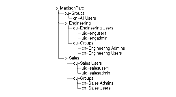

Basic DIT Structure
The examples used in this chapter are based on a simple DIT for a fictitious company. Figure 5-1 shows two organizations, Engineering and Sales, under the root. All groups in this example are static groups. This means that entries for these groups use the groupOfUniqueNames object class, which contains values naming the members of the group.
Figure 5-1    Directory Information Tree (DIT) used in examples in this chapter.
The following summarizes the use of groups in this sample DIT:
There is one group containing the administrators for Engineering, and one group with the administrators for Sales.
Very simple ACIs are set for the groups Engineering and Sales to allow members of these groups to manage their respective organizations.
In each organization, there is a group that contains non-administrator users.
There is another group at the root level, or top level. It contains all users in the directory.

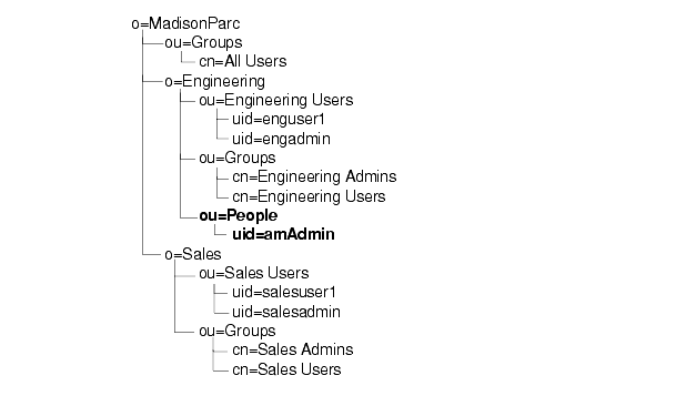

The DSAME administration user amAdmin will be created under the ou=People,o=Engineering,o=madisonparc people container. This is the top level administrator for DSAME. This administrator has read and write access to the entire subtree for o=madisonparc. You can add one of your users to this top level administrator role after the DSAME console is started.

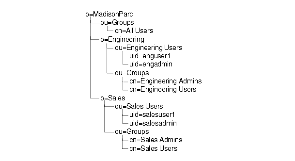

Figure 5-2    Directory Information Tree (DIT) Used in Examples in This Chapter.

The examples used in this chapter are based on the MadisonParc DIT. Figure 5-3 shows two organizations, Engineering and Sales, under the root. All groups in this example are static groups.
Figure 5-3    The MadisonParc DIT.

If you used an existing organization as your default organization during installation, you do not have to make these changes. The installation program automatically added these object classes and attributes. Skip to Step 10b.
Add the following object classes to each organization entry:
In the MadisonParc example, these object classes and attributes were automatically added to the default organization, o=Engineering, which was the organization specified and created during DSAME installation. The object classes and attributes were manually added to the o=Sales organization.Add the following attribute to each organization entry:
Example:

Step 9b: Mark People Containers
To each people container, add the iplanet-am-managed-people-container object class.Example:

Step 10: Load the Modified LDIF Files
After you run the scripts in the previous steps, the various LDIF files are created in the same directory where the Perl scripts are run. Until now, no changes have actually been made in the directory. Before loading the modified files into the directory, it is a good practice to inspect the files to make sure that all DSAME object classes and attributes have been properly added to the existing directory entries. Once you're satisfied that the appropriate changes have been made, load each file using the following ldapmodify command:ldapmodify -h hostname -p port -D bind_user, -w password -a -c -f filename.ldif
Results of DSAME and Directory Modifications
After making the modifications in the previous steps, all entries in the DIT will be manageable by DSAME. The existing ACIs for the organization administrators do not have to be modified. Even though DSAME uses roles and ACIs by default, your existing groups and ACIs will still work.You can convert a groups-based DIT to one that leverages roles and ACIs. If you choose to do this, you can use the DSAME organization administrator roles and assign them to your existing organizationList administrators.
