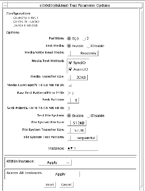

disktest Test Options
To reach the following dialog box, right-click on the test name in the System Map and select Test Parameter Options. If you do not see this test in the System Map, you might need to expand the collapsed groups, or your system may not include the device appropriate to this test. Refer to the SunVTS User's Guide for more details.
FIGURE 10-1 	disktestTest Parameter Options Dialog Box
The following table describes the disktest option menu for different test modes.
   TABLE 10-2 	  disktest     Configurations and Options
| disktest Options
 | Description
| Partition
 | Displays the partition for the Media subtest. If a partition is mounted, its mount point is appended after the partition number, such as 1(/usr), where 1 is the partition number, and "(/usr)" is the mount point.
| Test Media
 | Enables or disables the media subtest.
| Media Write Read Mode
 | Selects Read-Only or Compare after Read, or Read after Write.
| Media Test Method
 | Selects the media test methods (SyncIO and AsyncIO).
| Media Coverage (% TB, GB, MB, KB, B)
 | Tests all or part of a partition (in percentage or in any of TB, GB, MB, KB, B units)
| Raw Test Pattern (P0 to P16)
 | Specifies the write, read pattern.
P0 - Low Frequency Pattern
P1 - Low Transition Density Pattern
P2 - High Transition Density Pattern
P3 - Compliant Jitter Pattern
P4 - Compliant Jitter: RPAT
P5 - Compliant Jitter: CRPAT
P6 - Compliant Jitter: JTPAT
P7 - Compliant Jitter: CJTPAT
P8 - Compliant Jitter: SPAT
P9 - Compliant Jitter: CSPAT
P10 - 8 Bit Cable Pattern
P11 - 16 Bit Cable Pattern
P12 - 8 Bit Xtalk Pattern
P13 - 16 Bit Xtalk Pattern
P14 - MFM Pattern
P15 - Generic Test Patterns
P16 - SATA Test Patterns
| Seek Pattern
 | Specifies the pattern of the disk head movement.
S - Sequential
SR - Sequential Reverse
LS - Low Power Sequential
R - Random
LB - Low Power Butterfly
LR - Low Power Reverse Butterfly
AB - Actuator Butterfly
AR - Actuator Reverse Butterfly
| Seek Point (%, I, O, M, TB, GB, MB, KB, B)
 | Specifies the seek point offset for the I/O. You can specify the offset as a percentage or any of TB, GB, MB, KB, B or and I, M, O (Initial, Middle, Outer).
| Media Transfer Size
 | Displays the transfer size of the Media subtest.
| Test File System
 | Selects the File System subtest.
| File System File Size
 | Specifies the size for each of the two temporary files for File System testing.
| File System Transfer Size
 | Displays the transfer size of the file system subtest.
| File System Test Pattern
 | Test pattern of File System subtest.
| Connection Test for Hard Disk
Option Menu for hard disk partition - 0 - 7 [default]
Test Media - [Enable] 	(fixed to Enable)
Media Write Read Mode - [Read Only] 	(fixed to Read Only)
Media Test Method-[SyncIO] (fixed to SyncIO)
Media Coverage(%) - 1
Media Transfer Size - [2 KB]
Test File System - [Disable] 	(fixed to Disable)
| Online Mode for Hard Disk
Partition - 0 - 7 [default]
Test Media - [Enable] [Disable]
Test Mode - [Read-only~] 	(fixed to Read-only)
Media Coverage (% TB GB MB KB B) - [10~] (fixed to 10%)
Media Transfer Size - [2KB~] (fixed to 2 KB)
Test File System - [Disable~]	 (fixed to Disable)
Media Test Method - [SyncIO] [AsyncIO]
Raw Test Pattern - [P15~] (fixed to P15)
Seek Pattern - [S~] (fixed to S)
Seek Point (% TB GB MB KB B) - [I~] (fixed to I)
| Functional Test for Hard Disk
Media Write Read Mode - [Readonly] [CompareRead] [WriteRead]
Media Test method - [SyncIO] [AsyncIO]
Media Transfer Size - [2KB] [16KB] [32KB] [64KB] [128KB] [256KB] [512KB]
Test File System - [Enable] [Disable]
File System File Size - [512KB] 	[2MB] 	[8MB]	 [20MB] 	[100MB] 	[200MB]
File System Transfer Size - [512B] 	[1024B] [10KB]	 [40KB] 	[80KB]
File System Test Pattern - [sequential] [0x00000000] [0xffffffff] [0x5aa55aa5] [0xdb6db6db] [random]
| Functional Test for Floppy Disk
(under Other-Devices group) - Partition: 0 - 7 [default]
Media Write Read Mode - [Read-only] [BackupWriteRead]
Media Transfer Size - [2KB] [10KB] [20KB]
Floppy File Size - 	[100KB] 	[200KB]
Floppy Transfer Size - [512B] [1024B] 	[10KB]

R - Random
 For example: seekpattern=S
| seekpoint=[i(nner)|m(iddle)|o(uter)|number [TB|GB|MB|KB|B|tb|gb|mb|kb|b]
 | Specifies the seek-point for the I/O. This could be specified either in terms of the range - inner, middle and outer. Or in terms of absolute seek location.
 The absolute location is specified by a number followed by any of the following units [TB|GB|MB|KB|B|tb|gb|mb|kb|b].
 For example:
seekpoint=I, starts the I/O from block 1.
seekpoint=M, starts the I/O from middle offset of the partition.
| iostat=[Enable|Disable]
 | Capture the iostat on to /var/opt/SUNWvts/logs/cxtxdx.iostat
| interval=number
 | Specifies the time interval to capture the log.
The following example shows how to run disktest on a partition "0" (which is mounted under "/") for the disk device c0t0d0. The media subtest is enabled in ReadOnly mode using the SyncIO method. The coverage specified is 30% with 512 KB transfer size. The File System subtest is disabled.
| # /opt/SUNWvts/bin/disktest -f -o partition=0"(/)", rawsub=Enable, rawrw=ReadOnly, method=SyncIO, rawcover=30, rawiosize=512KB, fssub=Disable, dev=c0t0d0
