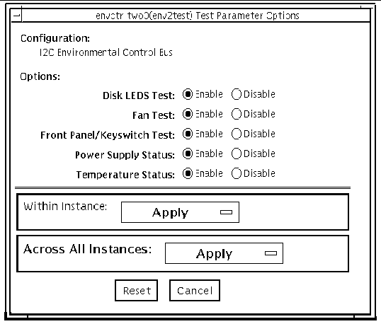

To reach the following dialog box, right-click on the test name in the System Map and select Test Parameter Options. If you do not see this test in the System Map, you might need to expand the collapsed groups, or your system might not include the device appropriate to this test. Refer to the SunVTS User's Guide for more details.
FIGURE 15-1 env2testTest Parameter Options Dialog Box
TABLE 15-1 env2test Options
env2test Options
Description
Disk LEDs test
Determines the number of disks that are present and the state of each disk. Illuminates each LED on the disk backplane to amber, and then back to the original state. The test then illuminates all disk LEDs to amber, and then back to the original state. This test is only enabled in Functional mode.
Fan test
Sets the fanbank speed to halfway between the current speed and max speed, then verifies the correct speed. Next, the fanbank speed is set to max speed, and the speed is verified. The fanbank speeds are then returned to normal, and then verified. This test is only enabled in Functional mode.
Front Panel and Keyswitch test
Flashes each individual LED on the front panel to on (green or amber), then off, and then back to the original state. The test then illuminates all front panel LEDs then sets them back to their original state. The Power On LED is read-only and is not cycled. The test then displays the current keyswitch position. This test is only enabled in Functional mode.
Power Supply Status
Identifies the number of power supplies that are in the system and the state of each power supply. This test is enabled in all modes.
Temperature Status
Identifies the current temperature of each CPU in the system, the ambient temperatures of the system, the temperature on the SCSI and power distribution boards, and verifies that all temperatures are within normal operating parameters. This test
