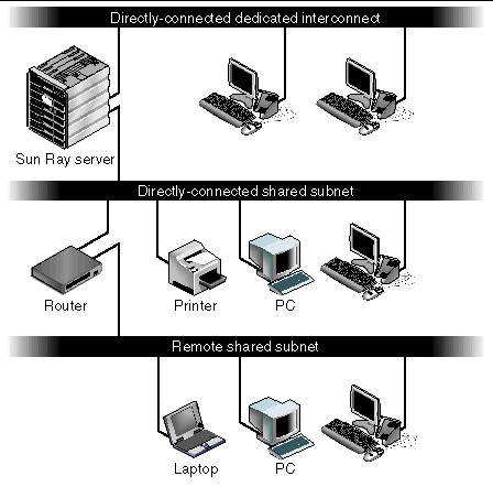

Network Topology Options
There are three basic topology options for Sun Ray deployment. DTUs can be deployed on:
A Sun Ray server can support any combination of these topologies, which are shown in FIGURE 7-1.
FIGURE 7-1 Network Topologies for Sun Ray DTU Deployment
Note - Sun Ray traffic on shared networks is potentially more exposed to an eavesdropper than traffic on a dedicated Sun Ray interconnect. Modern switched network infrastructures are far less susceptible to snooping activity than earlier shared technologies, but to obtain additional security the administrator may choose to activate Sun Ray's encryption and authentication features. These capabilities are discussed in Encryption and Authentication.

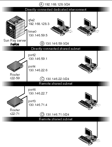

Network Configuration Tasks
The addition of directly-connected and remote shared subnet support allows DTUs to be deployed virtually anywhere on the enterprise intranet, subject only to the provision of DHCP service and a sufficient quality of service between the DTU and the Sun Ray server.
The following sections explain how to configure a network to support these deployment scenarios:
FIGURE 7-2 shows the overall topology and configuration tasks.[3]
Preparing for Deployment
Before deploying a DTU onto any subnet, the administrator must answer three questions:
1. From which DHCP server will DTUs on this subnet get their basic IP networking parameters?
2. From which DHCP server will DTUs on this subnet get additional configuration parameters to support features such as firmware download?
3. How will DTUs on this subnet locate their Sun Ray server?
The answers to these questions determine what configuration steps will let DTUs placed on this subnet initialize themselves and offer Sun Ray sessions to users.
The following sections present examples of DTU deployment on the directly-connected dedicated interconnect A, the directly-connected shared subnet B, and the remote shared subnets C and D shown in FIGURE 7-2.
FIGURE 7-2 Sun Ray Network Topology
Deployment on a Directly-Connected Dedicated Interconnect
Subnet A in FIGURE 7-2 is a directly-connected dedicated interconnect. Its subnet will use IP addresses in the range 192.168.128.0/24. The Sun Ray server named helios is attached to the interconnect through its qfe2 network interface, which will be assigned the IP address 192.168.128.3.

Deployment on a Directly-Connected Shared Subnet
Subnet B in FIGURE 7-2 is a directly-connected shared subnet that uses IP addresses in the range 130.146.59.0/24. The Sun Ray server helios is attached to the interconnect through its hme0 network interface, which has been assigned the IP address 130.146.59.5. The answers to the three pre-deployment questions are:

Directly-Connected Shared Subnet: Example 2
In this example, the answers to the three pre-deployment questions are:
From an external DHCP service.
The DTUs will not be supplied with additional parameters.
By using the local subnet broadcast discovery mechanism.

Deployment on a Remote Subnet
Subnets C and D in FIGURE 7-2 are remote shared subnets.
Subnet C uses IP addresses in the range 130.146.22.0/24. Subnet D uses IP addresses in the range 130.146.71.0/24. The Sun Ray server named helios has no direct attachment to either of these subnets; it is this characteristic that defines them as remote. The answers to the three pre-deployment questions are:
In a shared subnet scenario, the administrator must choose whether a DHCP service on the Sun Ray server or some external DHCP service will provide the DTU with basic network parameters.
If the enterprise already has a DHCP infrastructure that covers this subnet, it probably supplies basic network parameters. If no such infrastructure exists, configure the Sun Ray server to provide basic network parameters.
The administrator must choose whether additional configuration parameters will be supplied to the DTU, and if so whether they will be supplied by a DHCP service on the Sun Ray server or by some external DHCP service.
Administrators of an established DHCP infrastructure may be unable or unwilling to reconfigure it to provide additional Sun Ray configuration parameters, so it is usually more convenient to have the Sun Ray server provide them.
Even when the established infrastructure is capable of delivering the additional parameters, it may be desirable to have the Sun Ray server provide them. This enables you to use Sun Ray Server Software commands to manage the values of the additional configuration parameters, when those values need to be changed in response to software upgrades or patch installations on the Sun Ray server. For instance, a patch that delivers new DTU firmware could automatically update the firmware version string delivered to the DTU. However, if the firmware version parameter is supplied by some external DHCP service, an administrator must manually edit the firmware version parameter string in the external DHCP configuration rules to reflect the new firmware version delivered by the patch. This kind of activity is time-consuming and error-prone as well as unnecessary.
Use one of the optional additional configuration parameters to report the location of the Sun Ray server to the DTU. If additional configuration parameters are not supplied to the DTU at all, the DTU cannot locate a Sun Ray server, so it tries to discover the location of a Sun Ray server by using a broadcast-based mechanism. However, the DTUs broadcast packets propagate only on the local subnet; they cannot reach a Sun Ray server located on a remote subnet, and cannot establish contact.
The next two examples illustrate representative remote shared subnet configurations. In the first example, an external DHCP service provides basic networking parameters, and the Sun Ray server provides additional parameters. This is by far the most likely configuration for a Sun Ray deployment in an enterprise that has an established DHCP infrastructure.
In the second example, basic networking parameters and a bare minimum of additional parameters--just enough to enable the DTU to contact a Sun Ray server--are supplied by an external DHCP. In this case, it is the DHCP service in a Cisco router. This scenario is less than ideal.
No firmware parameters are delivered to the DTU, so it cannot download new firmware. The administrator must make some other arrangement to provide the DTU with new firmware, for instance, by rotating it off this subnet periodically onto an interconnect or onto some other shared subnet where a full set of additional configuration parameters is offered.
Note - For examples of shared subnet deployments in which both basic networking parameters and additional parameters are delivered by the Sun Ray server and basic networking parameters are supplied by an external DHCP service (with no additional DTU parameters provided), see Directly-Connected Shared Subnet.
Remote Shared Subnet: Example 1
In this example, in which DTUs are deployed on subnet C in FIGURE 7-2, the answers to the three pre-deployment questions are:
From the Sun Ray server.
The DTUs will be informed of the location of the Sun Ray server through an additional configuration parameter delivered in Step 2.
Use the utadm -A subnet command as follows to configure DHCP service for DTUs on a shared subnet.

Remote Shared Subnet: Example 2
In this example, deploying DTUs on subnet D in FIGURE 7-2, the answers to the three pre-deployment questions are:
The DTUs will not be supplied with the additional parameters required to support firmware download or to activate other advanced DTU features.
The external DHCP service will supply a single additional parameter to inform the DTU of the location of a Sun Ray server.
In this example, the Sun Ray server does not participate in DTU initialization at all. Why, then, are configuration steps required on the Sun Ray server? The Sun Ray server responds by default only to DTUs located on directly connected dedicated interconnects. It responds to DTUs on shared subnets only if the utadm -L on command has been executed. Running the utadm -A subnet command to activate DHCP on the Sun Ray server for a shared subnet, as in this example, implicitly executes utadm -L on. If utadm -A subnet has not been run, the administrator must run utadm -L on manually to allow the server to offer sessions to DTUs on the shared subnet.
