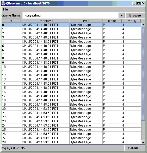

Use the QBrowser demo application to look at the DMQ contents. The QBrowser demo is in an operating system-specific location; for the location, see Appendix A, "Platform-Specific Locations of Message Queue Data" and look in the tables for “Example Applications and Locations.”
This is an example of invocation on Windows:
cd \MessageQueue3\demo\applications\qbrowser java QBrowser
When the QBrowser main window appears, select the queue name mq.sys.dmq and then click Browse. A list like the following appears.
Figure 12-1 QBrowser Window
Double click a message to display details about that message.

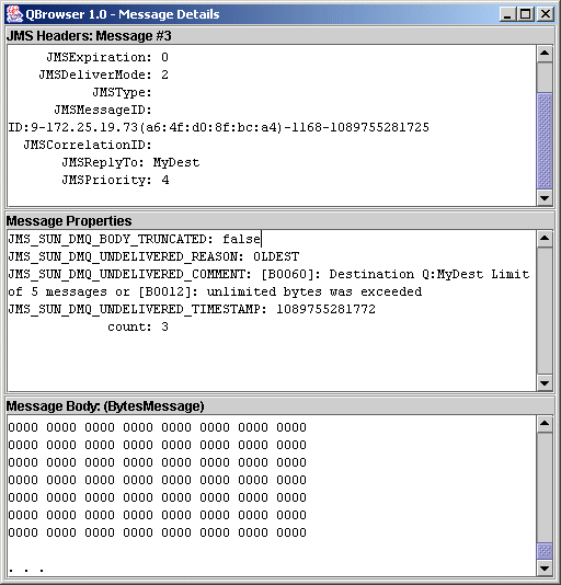

Note whether the JMS_SUN_DMQ_UNDELIVERED_REASON property for messages has the value EXPIRED.

Use the QBrowser demo application to look at the contents of the dead message queue. The QBrowser demo is in an operating system-specific location; for the location, see Appendix A, "Platform-Specific Locations of Message Queue Data" and look in the tables for “Example Applications and Locations.”
When the QBrowser main window appears, select the queue name mq.sys.dmq and then click Browse. A list like the one shown in Figure 12-1 appears.
Double click any message to display details about that message. The window shown in Figure 12-2 appears.
Note the values for the following message properties:
Under JMS Headers, note the value for JMSDestination to determine the destination whose messages are becoming dead.

An unexpected broker error occurred
To confirm this cause of the problem
Use QBrowser to examine a message, as described under Producers are faster than consumers.
If the value for JMS_SUN_DMQ_UNDELIVERED_REASON is ERROR, a broker error occurred.
To resolve the problem
