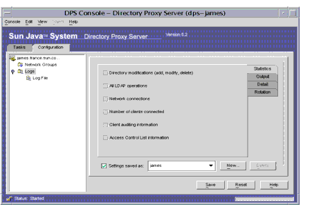

- In the Statistics tab, specify the kind of information to be logged.
Check the boxes referring to the type of logging messages desired. By default none of the options are selected. Log messages are classified into the following groups: directory modifications, all LDAP operations, network connections, number of clients connected, and client auditing information.
Directory modifications. Statistics about operations that write to the directory, like add, modify, and delete will be logged.
All LDAP operations. Statistics about all LDAP operations will be logged.
Network connections. Statistics about network connections will be logged.
Number of clients connected. General statistics such as how many clients are connected will be logged.
Client auditing information. Audit information such as the DN of client that just completed a bind/unbind will be logged.
Access Control List Information. This contains a list of users that have access to log information.

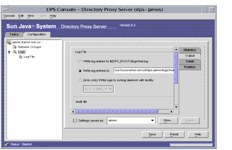

- Select the Output tab and specify where log entries should be sent and whether to log audit traces.
Log file. Displays options governing where Directory Proxy Server will write its log entries.
Write log entries to $(dps_ROOT)/logs/fwd.log. This is the default setting in which Directory Proxy Server will write its log entries to the file $(dps_ROOT)/logs/fwd.log where $(dps_ROOT) is the ServerRoot.
Write log entries to. Specify an alternative file to which Directory Proxy Server will direct its log entries. The file separator must follow UNIX conventions regardless of platform.
Write logs to syslog daemon with facility. (UNIX only) Choose a syslog facility code that Directory Proxy Server will use to log entries. This setting should be chosen only if this log property is to be used by Directory Proxy Server installed on a UNIX machine.
Audit File. Displays options governing where Directory Proxy Server will write its audit log entries. For this feature to work, audit logging must be enabled by selecting the "Client auditing information" option in the Statistics tab.
Write audit entries with other log entries. This is the default setting in which Directory Proxy Server will write its audit log entries to the same output specified in the log file settings above.
Write log entries to. Specify an alternative file to which Directory Proxy Server will direct its audit log entries. The file separator should follow UNIX conventions regardless of platform.
Write audits to syslog daemon with facility. (UNIX only) Choose a syslog facility code that Directory Proxy Server will use to log audit entries. This setting should be chosen only if this log property is to be used by Directory Proxy Servers hosted on a UNIX machine.

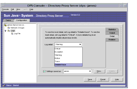

- Select the Detail tab and specify the log levelthe amount of logging detail desired.
Choose the logging level from the drop-down menu.

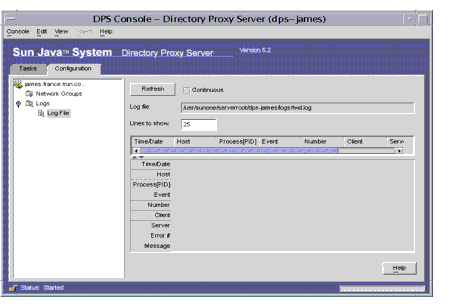

The Directory Proxy Server Console provides a simple mechanism for viewing the contents of log files. The contents of the log file you choose to view are displayed in the form of a table. The table is split; the top pane shows log records in tabular format and the bottom pane shows the currently-selected record in detail. Each log record contains information such as the date and time the message was logged, the severity of the message, and a general description of the log.
Once you open a log file for viewing, you can read its contents partially by specifying the number of records or entries to be displayed.
To View Log Records in a File
- Access the Directory Proxy Server Console as described in Accessing the Directory Proxy Server Consoles.
- Select the Configuration tab, and then, in the navigation tree, expand Logs.
- Select Log File.
The right pane shows viewing options for entries logged to a file. You can select any of the log files specified in the current log property; Directory Proxy Server can contain separate files for logging and auditing information, if configured to do so.
Description of the form elements are as follows:
Refresh. Reads the log and displays the records in the table below.
Continuous. Select this setting to have this view continuously refreshed with the most current log records.
Log file. Displays the name of the file currently being viewed.
Lines to show. Specifies the maximum number of lines to read from the log file.
