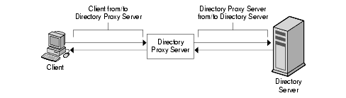

Directory Proxy Server has two separately configurable communication links. Each communication link can be plaintext or encrypted using Transport Layer Security (TLS) or Secure Sockets Layer (SSL) protocol. Availability of the two separate communication links enables you to configure TLS- or SSL-enabled communication between an LDAP client and Directory Proxy Server and between Directory Proxy Server and an LDAP directory. Figure 12-1 illustrates this capability of Directory Proxy Server.
Figure 12-1 Two Separate Communication Links in Directory Proxy Server

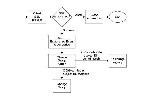

Directory Proxy Server can verify both client and server certificates, provided the trusted root CA certificate for the certificate being validated is installed and is available to Directory Proxy Server.
Figure 12-2 illustrates how Directory Proxy Server can verify the certificates presented to it by the clients after they establish an SSL session.
Figure 12-2 Certificate-Based Authentication of Clients

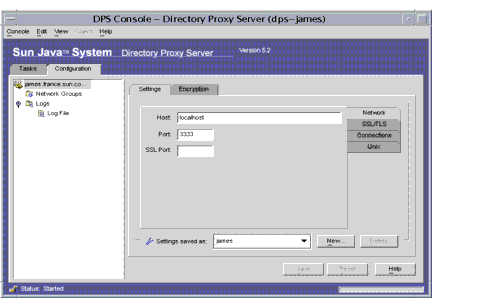

To Make Changes to the Directory Proxy Server System Configuration
The Settings and Encryption tabs in the Directory Proxy Server Console window enable you to define SSL-enabled communication criteria for Directory Proxy Server. For details, see Creating System Configuration Instances.
Make the following changes to the appropriate system configuration instances, and save your changes.
- In the Settings tab, specify a value in the "SSL port" field. Directory Proxy Server will listen on the port number you specify for LDAPS (LDAP over SSL) connections. By default, Directory Proxy Server does not listen for connections from LDAPS clients. This value must be present to enable LDAPS connections from clients that use the alternative port 636 method to establish TLS/SSL. This value must be different from the value in the Port field. (This option also requires TLS/SSL configuration found on the Encryption tab.)

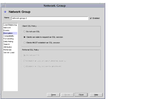

To Make Changes to the Directory Proxy Server Network Groups
Directory Proxy Server uses network groups to identify clients and determine their access privileges to the information contained in an LDAP directory; for details, see Creating and Managing Groups.
In each group that you've configured, set the appropriate options in the Encryption tab to indicate whether you want to force the client to start a TLS session before sending any LDAP operation, leave the decision to the client, or disallow the client to start a TLS session. For example, you might want to enable "SSL is available" and "Clients MUST establish an SSL session" options. For more information about the options presented in the Encryption tab, see Step 9 of To Create a Network Group in Directory Proxy Server.
If referral following is enabled, you should check the Referral SSL Policy. Referral following is enabled by selecting Referrals in the list on the left side of the window.
