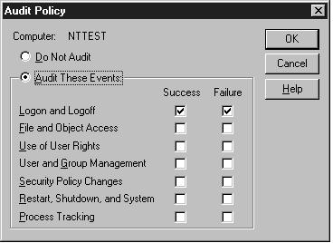

Next, under Policies, choose Audit, select Audit These Events, and check the boxes for both Success and Failure for the Logon and Logoff Events.
