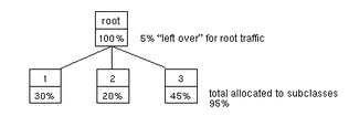

Share the bandwidth allocated to the root class with the child classes of the root class, 1, 2, and 3:
The root class itself requires some bandwidth to handle traffic allocated to it, therefore, do not allocate 100% of the bandwidth to the child classes. The root class will use the 5% that is left.

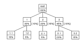

For each child class, share the bandwidth allocated with their own child classes. For example, share the 30% allocated to class 1 with child classes 1.1 and 1.2. The figure in brackets shows the amount of bandwidth left-over once you have allocated bandwidth to the child classes. This left-over bandwidth effectively becomes the guaranteed minimum bandwidth for the parent class.

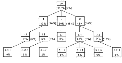

Continue sharing the bandwidth allocated to each class with its child classes until all classes have an allocation:
When specifying the bandwidth allocated to a class in the configuration file or using batool, you must specify the aggregate bandwidth allocated to a class and all its descendants. For example, for class 3.1, specify 20%, and for class 1, specify 30%.
