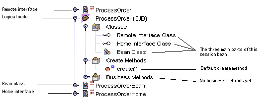

Looking at a Session Bean's Classes
The EJB Builder wizard generates the default session bean classes for you and sets up the relationships between all the classes. FIGURE 3-2 shows how a typical session bean (all of whose classes are in the same package) appears in the Explorer's Filesystems pane.
 FIGURE 3-2 Default Classes of a Typical Session Bean With Remote Interfaces
Screenshot showing the typical classes generated for a session bean.[ D ]
The nodes marked with the class icon Class node icon. represent classes of the session bean. The node marked with the bean icon Bean icon. is a logical node for the session bean. Do all your editing in the logical node. The example bean's primary nodes are described next.
Expanding the Nodes
When you expand the four nodes under your session bean's package node, you see something like the tree view in FIGURE 3-3.
 FIGURE 3-3 Explorer's Detailed View of a Typical Session Bean With Remote Interfaces
Screenshot showing an expanded view of the typical classes generated for a session bean.[ D ]
