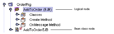

Your newly created message-driven bean appears in the Filesystems pane of the IDE's Explorer. The bean's infrastructure (its basic bean class and its two component methods) has been generated automatically by the EJB Builder.
FIGURE 7-1 shows how a typical message-driven bean appears in the Explorer's Filesystems pane.
[ D ]
Of the two primary nodes shown, one is a logical node (marked with a bean icon) and one represents the actual class (marked with a class icon). Do all your editing in the logical node. The bean's two primary nodes are described next.
The Classes node contains the bean class code, which includes both methods. The Create Method node points to the code that initializes your message-driven bean. The OnMessage Method node points to the method that is invoked when a message is received.

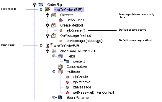

When you expand the two nodes under your message-driven bean's package node, you see something like the tree view in FIGURE 7-2.
[ D ]The wizard automatically places certain default methods in each message-driven bean: a create method, an onMessage method, and two life-cycle methods. As shown in TABLE 7-2, the create method, ejbCreate, behaves much like create methods in other types of enterprise beans, but onMessage is a new and different kind of method.
The wizard also adds the default life-cycle methods described in TABLE 7-3.
