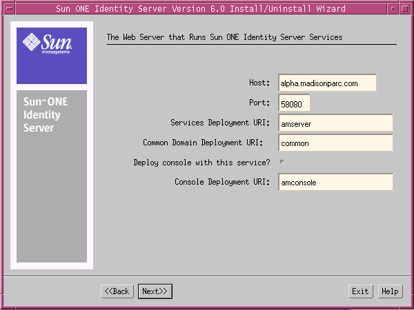

  15. In the Web Server that Runs Sun ONE Identity Server Services panel, provide the following information, and then click Next:
  16. Host: This field displays the fully qualified domain name of the computer where the Identity Server components and a dedicated web server will be installed together.
    Port: Type the port number of the Web Server that runs the Identity Server services. The default port is 58080.
    Services Deployment URI: The Universal Resource Identifier (URI) prefix tells the Web Server where to look for HTML pages associated with a service and also for web application-specific information such as classes and jars.
    The default URI prefix is amserver. You can type a different name.
    Common Domain Deployment URI: The URI for accessing the common domain services on the Web Server. The default URI is common, which you may change, if required.
    Deploy console with this service? By default, this check box is clicked to indicate that the Identity Server Console will be installed with the Identity Server services. However, if you have an existing console and hence do not want to deploy the console now, click the check box to clear the selection. In this case, the installation program will display another panel to seek more information about the existing console. See the next step for details.
    Console Deployment URI: This URI prefix tells the Web Server where to look for HTML pages associated with the Identity Server console and also for other web application-specific information like classes and jars. The default URI prefix is amconsole. You can type a different name. This field is not available, if you cleared the check box Deploy Console with this Service?.
  17. If, in the previous panel, you did not choose to deploy the console with this service, provide the following information, and then click Next:

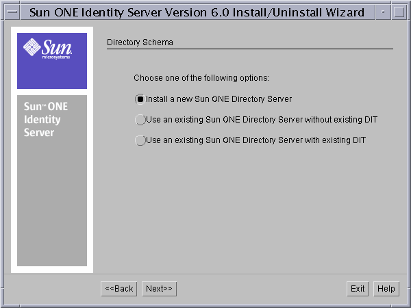

  19. In the Directory Schema panel, select “Install a new Sun ONE Directory Server,” and then click Next.
  20. Figure 4-3  Directory Schema Panel
