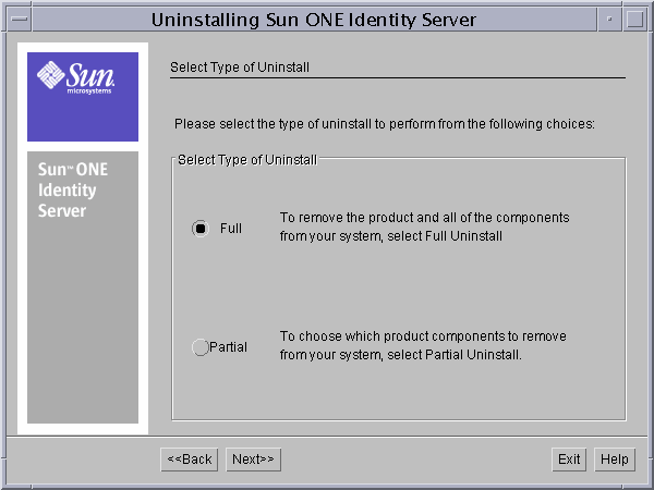

- In the Welcome window, click Next.
- In the Select Type of Uninstall window, select the type of uninstallation you want to perform, and then click Next.
Figure 10-1 Select Type of Install Panel
Full: Select this type to remove the product and all the components from your system.
Partial: Select this type if you want to remove only certain components of the Identity Server. When you click Next, you’ll see a list of all components that were installed with the services. In the Ready to Uninstall window, review the uninstallation information. If you need to make changes, click Back. Otherwise, click Uninstall Now. The program uninstalls the product or components based on your selection.

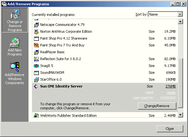

Uninstalling Identity Server On Windows
You must have Administrator privileges to run the Sun ONE Identity Server Uninstallation program. Be sure all web browsers are closed before starting the program.
To launch the Uninstallation wizard from the command line, in the Identity Server root directory, run the following command:
java uninstall_Sun_ONE_Identity_Server
The Sun ONE Identity Server Uninstallation program starts.

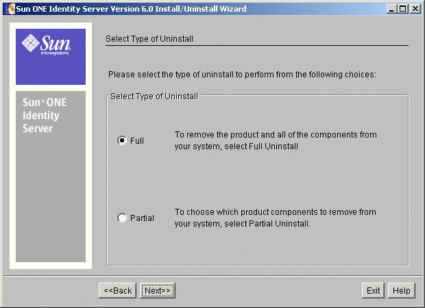

- In the Select Type of Uninstall window, select one of the following options.
Figure 10-3 Select Type of Uninstall Panel
Full. Select this option if you want to remove Identity Server services and Directory Server installed on the local computer system.
Partial. Select this option if you want to remove only some of the components of Sun ONE Identity Server. When you click Next in this window, the program will display all the components that are installed. Click those you want to uninstall.
- In the Ready to Uninstall window, click Uninstall Now.
