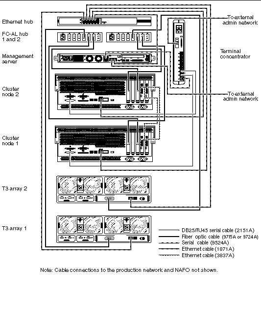

This appendix describes the arrangement of the cables in the Cluster Platform 280/3 system. This information is provided to assist in restoring the hardware to its original configuration after service.
FIGURE B-1 Cluster Platform Cables

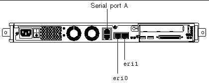

FIGURE B-3 Netra T1 AC200 Server (Management Server) Rear View Connectors

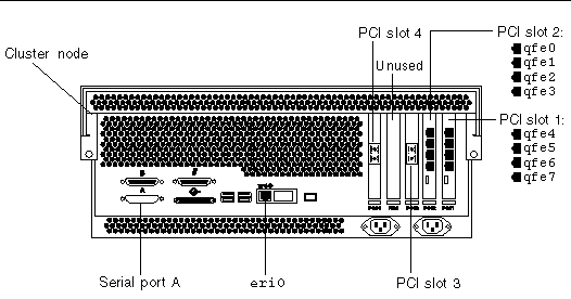

FIGURE B-4 Sun Fire 280R Server (Cluster Nodes) Rear View Connectors
The following table lists the connections you make when you install the Cluster Platform in your network environment as described in Chapter 2 and in FIGURE 2-2.
TABLE B-1 Connections Made On Site
From Device
From Location
To Customer Network
Cable Type
Management server
eri0
Administration network1
Ethernet
Terminal concentrator
Ethernet port
Ethernet
Node 1
qfe0
Production network
Ethernet
Node 1
qfe4
Production network
Ethernet
Node 2
qfe0
Production network
Ethernet
Node 2
qfe4
Production network
Ethernet
The following tables list factory configured cable connections.
TABLE B-2 Disk Array to Hub Connections
From Device
From Location
To Device
To Location
Cable Length/Type
Disk array 1 (mirror)
FC-AL port
FC-AL hub 1
Port 3
15 m/FC-AL
Disk array 2 (data)
FC-AL port
FC-AL hub 2
Port 3
15 m/FC-AL
10BASE-T
Ethernet hub
Port 1
4 m/Ethernet
Disk array 2 (data)
10BASE-T
Ethernet hub
Port 2
4 m/Ethernet
TABLE B-3 FC100 Hub to Server Connections
From Device
From Location
To Device
To Location
Cable Length/Type
FC-AL hub 1
Port 4
Node 1
PCI slot 3
5 m/FC-AL
FC-AL hub 1
Port 5
Node 2
PCI slot 3
5 m/FC-AL
FC-AL hub 2
Port 5
Node 1
PCI slot 4
5 m/FC-AL
FC-AL hub 2
Port 4
Node 2
PCI slot 4
5 m/FC-AL
TABLE B-4 Management Server Connections
From Device
From Location
To Device
To Location
Cable Type
Management server
Serial port A
Serial port 1
Serial
Management server
eri1
Ethernet hub
Port 5
Ethernet
Management server
eri0
See TABLE B-1
TABLE B-5 Terminal Concentrator Connections
From Device
From Location
To Device
To Location
Cable Type
Serial port 1
Management server
Serial port A
Serial
Serial port 2
Node 1
Serial port A
DB-25 serial/RJ-45
Serial port 3
Node 2
Serial port A
DB-25 serial/RJ-45
Ethernet port
See TABLE B-1
TABLE B-6 Node to Node Connections
From Device
From Location
To Device
To Location
Cable Length/Type
Node 1
PCI slot 2, qfe1
Node 2
PCI slot 2, qfe1
5 m/Null Ethernet
Node 1
PCI slot 1, qfe5
Node 2
PCI slot 1, qfe5
5 m/Null Ethernet
TABLE B-7 Ethernet Hub Connections
From Device
From Location
To Device
To Location
Cable Type
Ethernet hub
Port 1
Disk array 1 (node 1)
10/100 BASE-T port
Ethernet
Ethernet hub
Port 2
Disk array 2 (node 2)
10/100 BASE-T port
Ethernet
Ethernet hub
Port 5
Management server
eri1
Ethernet
Ethernet hub
Port 3
Node 1
eri0
Ethernet
Ethernet hub
Port 4
Node 2
eri0
Ethernet
