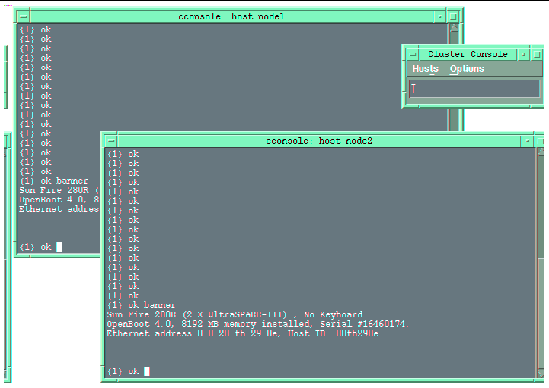

7. Launch the Cluster Console for both nodes.

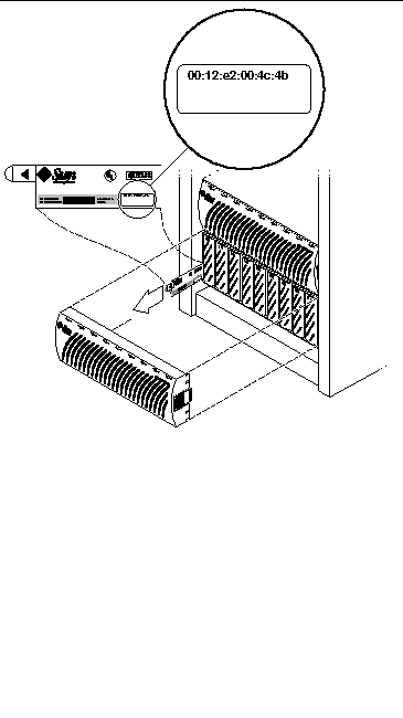

Use FIGURE 2-1 to record site-specific information that is needed to complete the procedures in this guide. Names and addresses shown in the center column represent the examples used in this guide. Assign names and addresses (routed or non-routed) that are appropriate for your site.
FIGURE 2-1 shows the location of the Ethernet address for the T3 arrays.

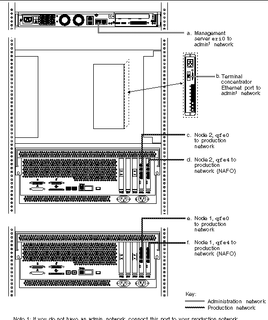

2. Connect the Cluster Platform 280/3 to your network(s) as described in the following steps and shown in FIGURE 2-2:
a. Connect the eri0 port of the management server to your administration network.
If you do not have an administration network, connect eri0 to your production network.
b. Connect the Ethernet port on the terminal concentrator to your administration network.
If you do not have an administration network, connect the Ethernet port to your production network.
c. Connect the qfe0 port on node 2 to your production network.
d. Connect the qfe4 port on node 2 to your production network.
This connection provides connectivity for network automatic failover (NAFO).
e. Connect the qfe0 port on node 1 to your production network.
f. Connect the qfe4 port on node 1 to your production network.
Note - For details on the internal cable connections see Appendix B. |

4. Type the following command to launch the Cluster Control Panel:
# ccp $CLUSTER & |
When the ccp $CLUSTER & command is executed, the Cluster Control Panel window is displayed (see FIGURE 2-4).
5. In the Cluster Control Panel window, double-click the Cluster Console (cconsole) icon to display a Cluster Console window for each cluster node (see FIGURE 2-5).
To type text into both node windows simultaneously, type commands in the Cluster Console window.
The text does not display in the Cluster Console window, but displays in both node windows. This ensures that both nodes execute the commands simultaneously.
The console windows for both cluster nodes are grouped (the three windows move in unison--FIGURE 2-5). To ungroup the Cluster Console window from the cluster node console windows, select Options from the Hosts menu (FIGURE 2-6) and deselect the Group Term Windows checkbox.
1. Use the Cluster Console window to type the following command into both nodes simultaneously:
boot net - install |
boot net - You must use spaces before and after the dash (-) character in the
