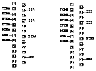

    Figure B-2 Serial Ports A and B Connector (DB-25) Pinouts
