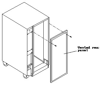

Follow these steps to remove the vented rear panel:
Figure 7-5 Removing the Vented Rear Panel
Set the vented rear panel aside.

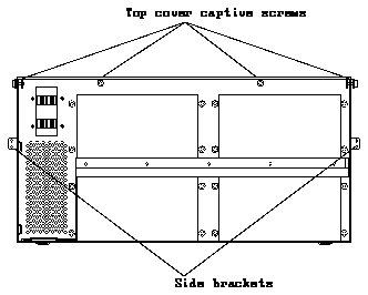

Follow these instructions to prepare the Multi-Tape Backup Tray for installing or removing the 5.0 Gbyte 8 mm tape drive:
Do not remove the terminator from the OUT port

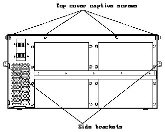

Figure 7-7 Removing the Tray Assembly in the Cabinet
There are three at each side and two at the front and back.

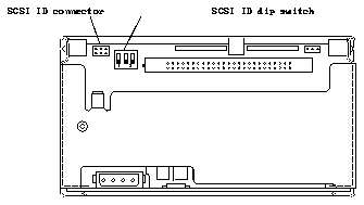

A jumper is a small sleeve that slides over two adjacent pins in the SCSI ID connector to provide an electrical connection. If the jumpers have not been removed, use the needle-nose pliers to remove them from the SCSI ID connector at the rear of the tape drive.
Figure 7-8 Location of the SCSI ID Connector and the SCSI ID Dip Switch for the 5.0 Gbyte 8 mm Tape Drive

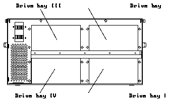

The 5.0 Gbyte 8 mm tape drives must be installed in the drive bays in the following order:
See Figure 7-10 for the location of each drive bay. The drive bays are also labelled on the tray.

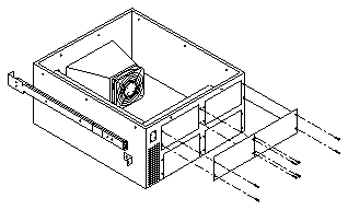

Figure 7-11 Removing the Plate from the Tray

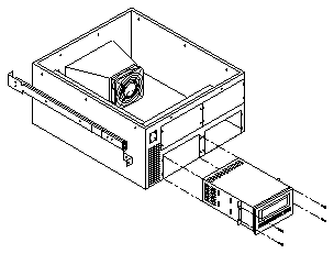

Figure 7-13 Securing the Tape Drive to the Tray

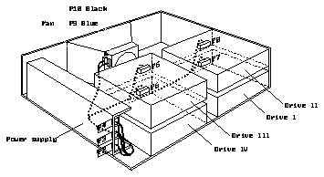

Table 7-2 gives the correct DC harness connections for each 5.0 Gbyte 8 mm tape drive in the Multi-Tape Backup Tray, and Figure 7-15 shows how the DC harness cables should be routed in the tray.
Tape Drive Location DC Harness Connector ------------------------------------------
I P7
II P8
III P5
IV P6
Figure 7-15 Connecting the DC Harness Cable

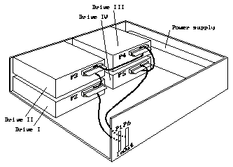

Table 7-3 gives the correct SCSI connections for each 5.0 Gbyte 8 mm tape drive in the Multi-Tape Backup Tray, and Figure 7-16 shows how the SCSI data cables should be routed in the tray. The connector is keyed so that you cannot install the cable incorrectly.
Tape Drive Location SCSI Data Connector -----------------------------------------
I P2
II P3
III P4
IV P5
Figure 7-16 Connecting the SCSI Data Cable

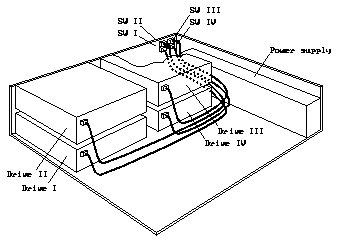

Table 7-4 gives the correct SCSI ID connections for each 5.0 Gbyte 8 mm tape drive in the Multi-Tape Backup Tray, and Figure 7-17 shows how the address cables should be routed in the tray. Position the address cable so that the black wire is located at the lower right corner of the SCSI ID connector (see Figure 7-18).
Tape Drive Location Address Connector ---------------------------------------
I SWI
II SWII
III SWIII
IV SWIV
Figure 7-17 Connecting the Address Cable
Figure 7-18 Positioning the Address Cable

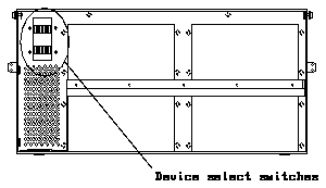

There are four device select switches at the front of each Multi-Tape Backup Tray, one for each drive within the tray. The addresses range from 0 to 7, but you can only use addresses from 0 to 5 for the drives within the Multi-Tape Backup Tray. Figure 7-19 shows the location of the device select switches on the Multi-Tape Backup Tray.
To set the SCSI address for the 5.0 Gbyte 8 mm tape drive, press the button
marked "+" to increment the address shown, or press the button marked
"-" to decrement the address shown until you see the proper address in the
window.

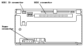

Figure 7-20 shows the three connectors that should have cables installed.
For the cables connected to the SCSI ID and power connectors, grasp each cable connector on both sides and firmly, but gently, pull the cable away from the connector at the rear of the tape drive.
For the cable connected to the SCSI connector, press out on the ejectors at the sides of the SCSI connector on the 5.0 Gbyte 8 mm tape drive to release the SCSI data cable from the tape drive (see Figure 7-21). Then grasp the cable connector by the attached strain relief tab and firmly, but gently, pull the cable away from the SCSI connector on the tape drive (see Figure 7-22).

Figure 7-23 Removing the Tape Drive from the Tray

Figure 7-26 Installing the Plate on the Tray

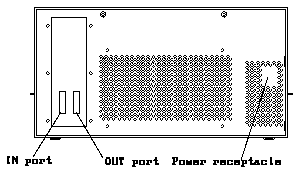

Figure 7-28 Location of the Power Receptacle on the Tray
The OUT port should have a terminator already installed.

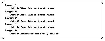

The command you enter to probe your system for SCSI devices will vary depending on which SCSI port you have the Multi-Tape Backup Tray connected to:
The "Target #" lines will tell you the SCSI addresses of the devices you have connected to your system.

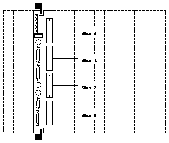

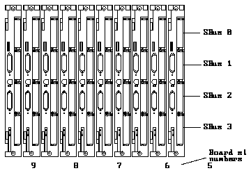

Figure 7-33 shows the board slot numbers for the SPARCcenter 2000 system.
Figure 7-33 Location of Boards and SBus Slot in the Boards
Figure 7-33 shows the SBus slot numbers in the system board.
Enter the following command to probe your system for SCSI devices, leaving a space after every quotation mark ("), where A is the board slot number (given in Step 5) and B is the SBus slot number within the board (given in Step 6):
For example, if the tray is connected to a card installed in SBus slot 1 in a board, and the board is installed in board slot 2 in the SPARCcenter 2000 card cage, you would enter the following command:
