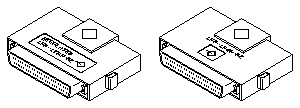

You must attach a SCSI terminator to the SCSI port at the end of the SCSI bus. Recent model Sun systems and peripherals (including the SunCD Plus DSPP) are supplied with new regulated SCSI terminators. Previously, Sun supplied standard SCSI terminators. The new terminators provide the improved impedance matching required for fast SCSI. A terminator holds the bus at a predetermined signal level when the bus is not active and maintains impedance matching. All SCSI systems must be terminated at the first and last units attached to the SCSI bus. A terminator is built in to all SBus SCSI cards and to all host systems. (So in most cases, the system terminates one end of the bus.)
Figure B-3 Regulated and Standard SCSI Terminators
Follow these SCSI termination rules:
If Fast SCSI devices and old-style connector devices must be used in the same system, the old-style connector devices should be connected to a separate SCSI port that contains no Fast SCSI devices. The mixing of Fast SCSI devices and old-style connector devices in the same daisy chain is not recommended.
