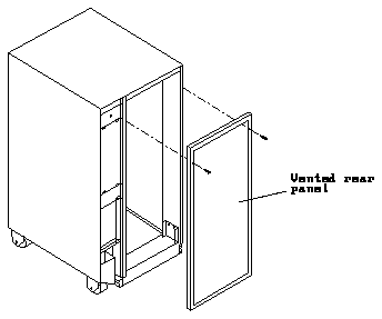

Figure 3-2 Removing the Vented Rear Panel

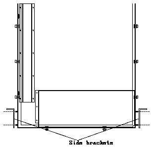

Use the side brackets that were shipped with your auto-loader.
Figure 3-5 Side Brackets on a 56-Inch Expansion Cabinet

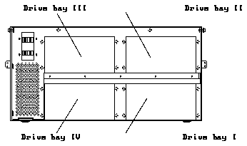

There are four locations for tape drives in the Multi-Tape Backup Tray. See Figure 3-6.
Figure 3-6 Drive Bays in the Multi-Tape Backup Tray

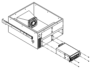

Figure 3-7 Drive Bay Mounting Screws
Figure 3-8 Removing the Drive from the Tray

Auto-loaders must be installed in the drive bays in the following order:
See Figure 3-6 for the location of each drive bay. The drive bays are also labelled on the tray.

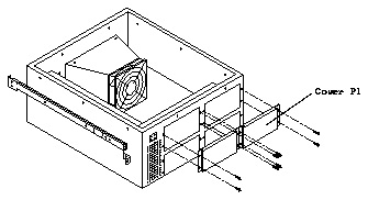

Use the 7 mm hex-head socket to remove the screws that secure the plate to the tray. See Figure 3-9.
Figure 3-9 Removing the Cover Plate from the Drive Bay
If another cover plate is already secured to the top of the fan assembly, put the cover plate you just removed in a safe place.
Figure 3-10 Attaching the Cover Plate to the Fan Assembly
Use the 7 mm hex-head socket.

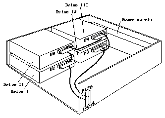

Table 3-2 gives the correct SCSI connections for each auto-loader in the tray, and Figure 3-12 shows how the SCSI data cables should be routed in the tray. The connector is keyed so that you cannot install the cable incorrectly.
Drive Location SCSI Data Connector ------------------------------------
I P2
II P3
III P4
IV P5
Figure 3-12 Connecting the SCSI Data Cable

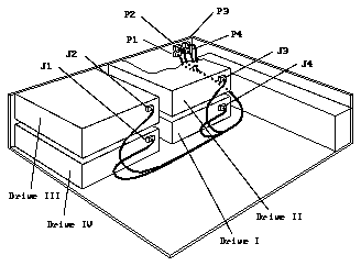

I (J1) P1
II (J2) P2
III (J3) P3
IV (J4) P4
Figure 3-13 Connecting the Address Cable

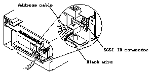

Position the address cable so that the black wire is located at the lower right corner of the SCSI ID connector. See Figure 3-14.
Figure 3-14 Positioning the Address Cable

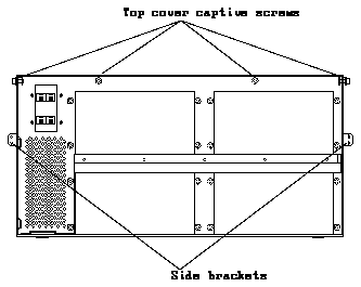

Use the flat-head screwdriver to tighten the ten top cover captive screws.
