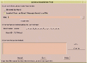

    Figure 4-1 License Installation Tool Window
    Graphic
  2. In the File text box in the License Installation Tool window, type the pathname to the file where you saved the license information that the Sun License Center emailed to you, or click the browse button (...) to use a file chooser to find the saved file.
  3. Click Load File.
    Your licenses listed in the email you received from the Sun License Center appear in the Licenses to be Installed pane.
