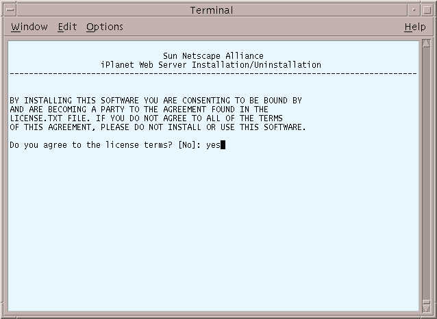

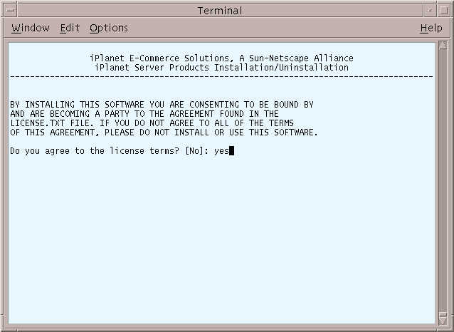

The Licensing Agreement screen displays. Type Yes to continue.

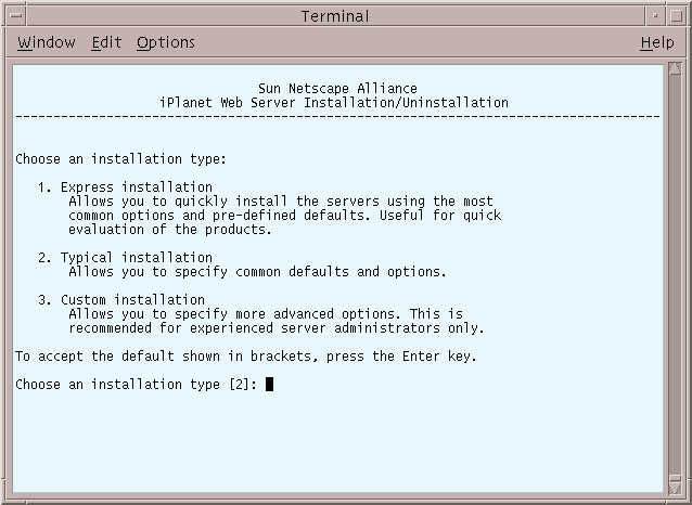

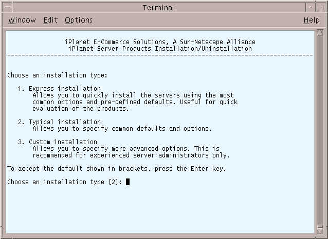

The Installation Type screen displays. Press Enter to accept a typical install.

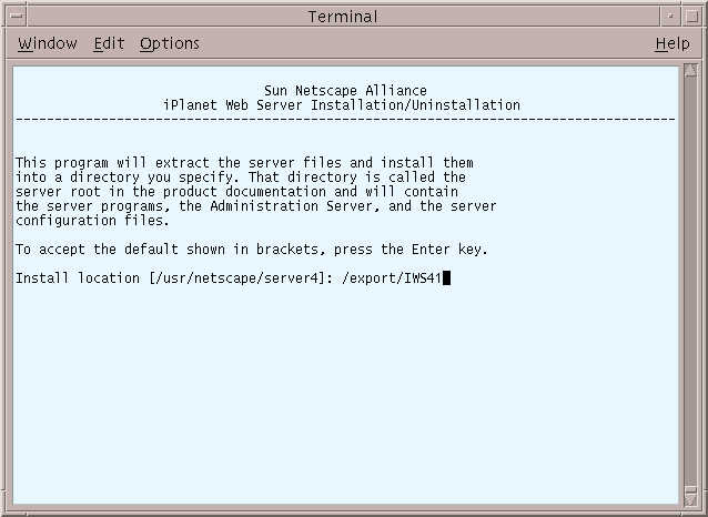

The Extracting Server Files screen displays. Type the location where you want to install iWS. The installer will create this directory.

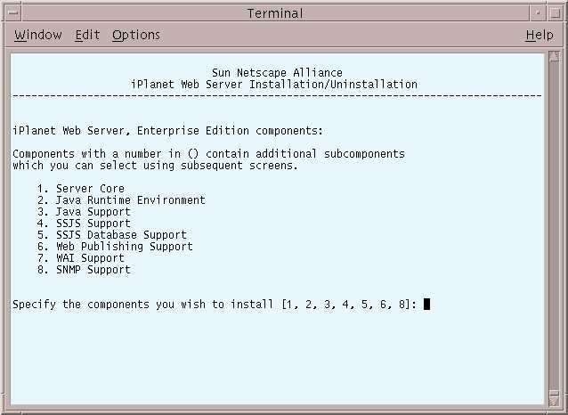

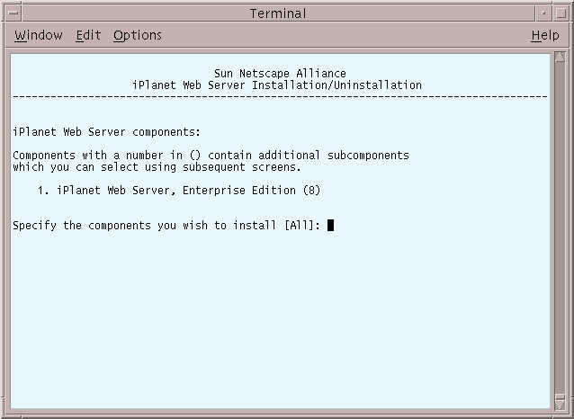

The Web Server Component screen displays. Press Enter to specify all the components.
The Additional Web Server Components screen displays. Press Enter to specify all the components listed.

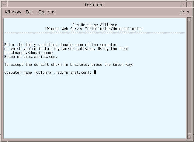

When this screen displays, read the instructions, verify that this is the correct computer name and press Enter. If it is not, enter the correct domain and press Enter.

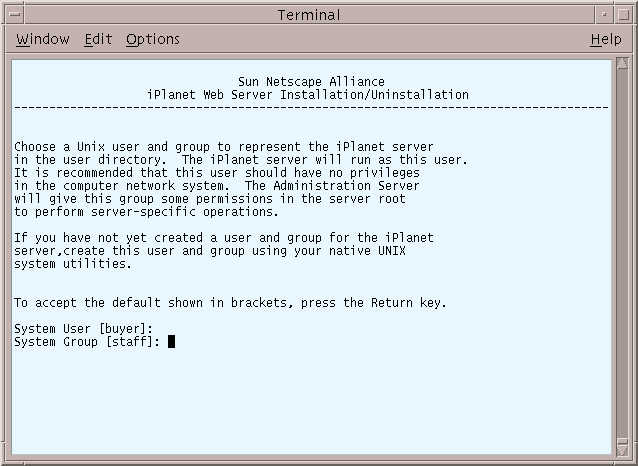

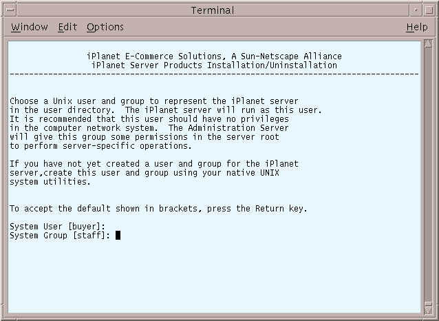

The Choosing a Unix User and Group screens display. The default should be chosen only if you want iWS to use the displayed Unix user and group to run iWS. Press Enter to accept the default or enter a Unix user and group.

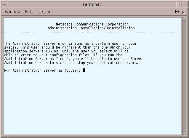

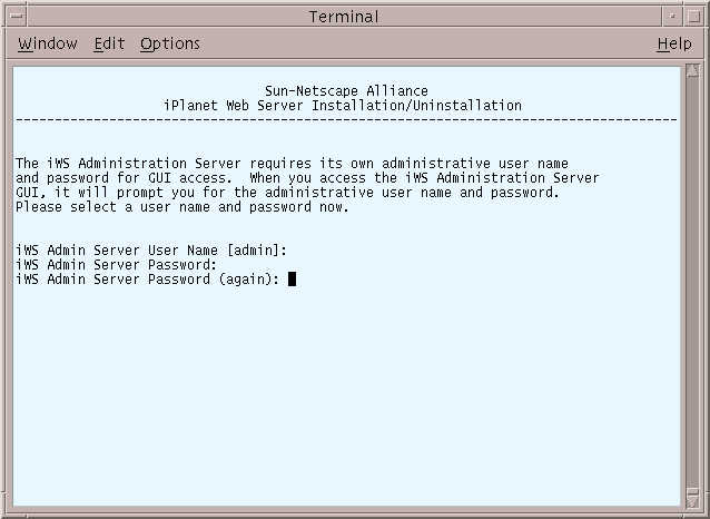

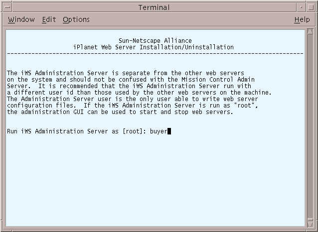

The iWS Administration Server User Name screen displays. Press Enter to accept the default, or enter a new iWS username (buyer is the example shown).
Create a password and enter it twice. This password will be used to access the administration of iWS.

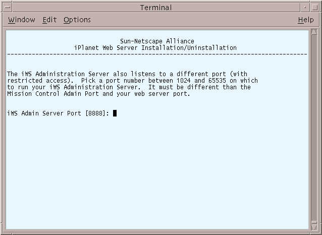

At the next screen, type your iWS administration server port number. You can use the default port number, 8888.

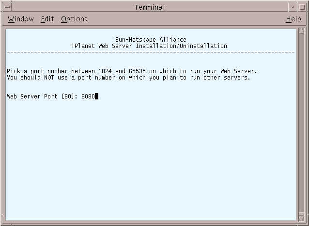

At the next screen, enter your iWS port number. The default shown is 8080.

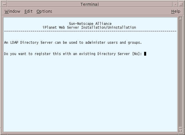

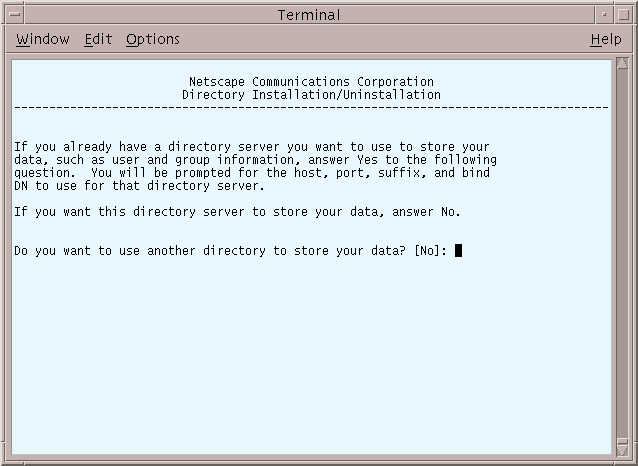

The LDAP Directory Server screen displays. If other iPlanet products have been installed on this network, you can unify the administration of the separate servers by typing Y and entering the necessary information.

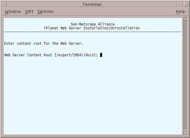

At the next screen, press Enter to accept the default, which is the location of the documents for iWS.

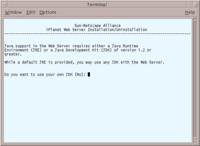

The Java Support screen displays. BuyerXpert does not run from the Java Development Kit (JDK) that is installed with this step and will not be affected by what you select from this screen. Press Enter if you want to use the JDK provided. Type Y if you want to use your own JDK.

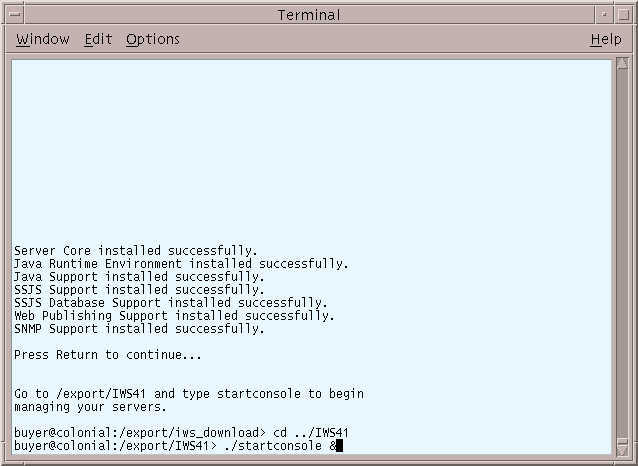

At the end of installation, the following messages display:

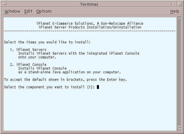

The Install Items screen displays. Press Enter to accept iPlanet servers.
The Installation Type screen displays. Press Enter to accept a typical installation.

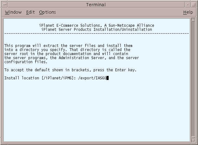

The Extract Server Files screen displays. Type /export/IAS60 or the location you want to install iAS.

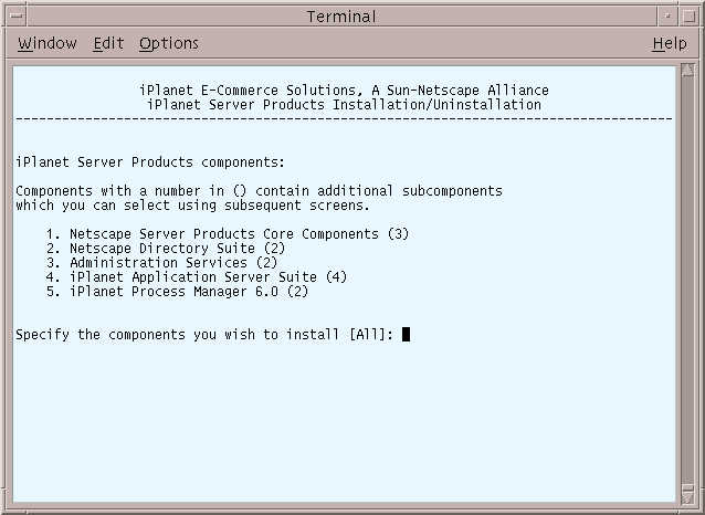

The Server Products screen displays. Since BuyerXpert will need all the components listed, press Enter.

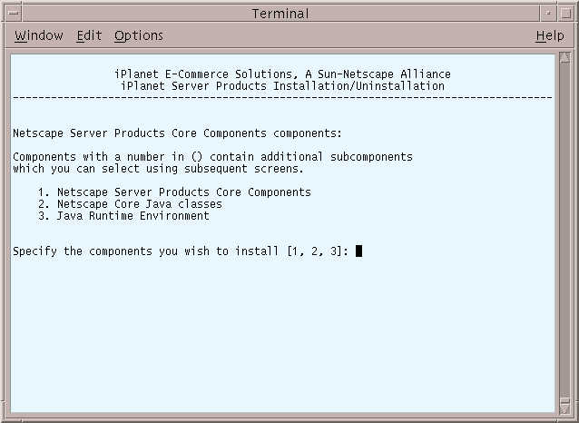

The Server Family Core Components screen displays. Press Enter to specify all the components listed.

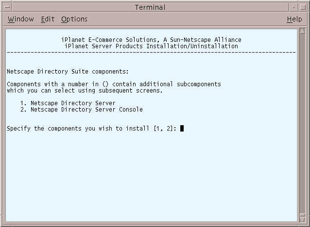

The Directory Suite Components screen displays. Press Enter to specify all the components listed.

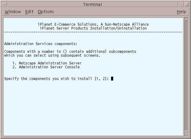

The Administrative Services screen displays. Press Enter to specify all the components listed.

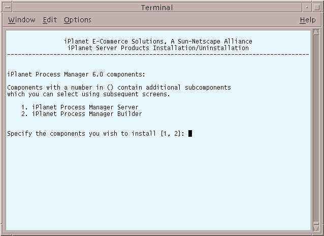

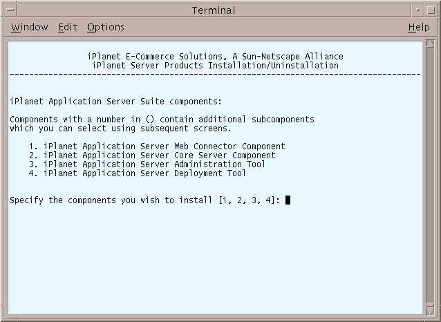

The Application Server Suite Components screen displays. Press Enter to specify all the components listed.
The Process Manager Components screen displays. Press Enter to specify all the components listed.

The Unix User and Group screen displays. Enter the system user and group name that was created in the section, Installing iPlanet Web Server (iWS), Step 9.

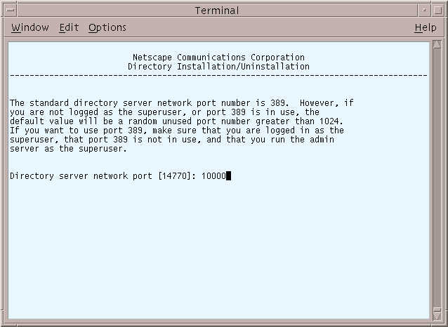

The Directory Server Network Port screen displays. Type 10000 or other port number.

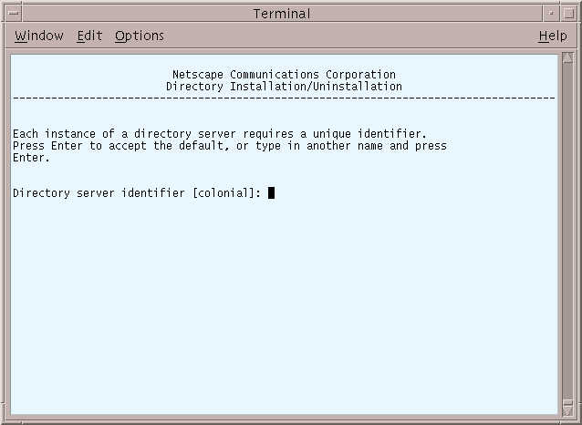

The Directory Server Identifier screen displays. Press Enter to accept the default.

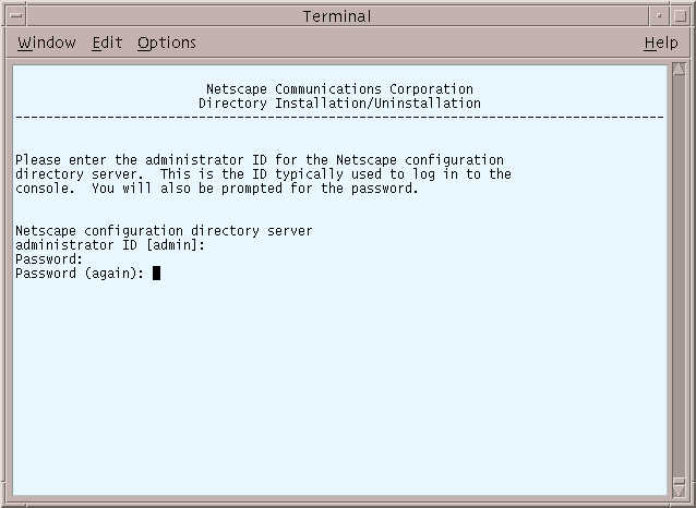

The Administrator ID screen displays. Enter your administrator ID, your password, and the password again.

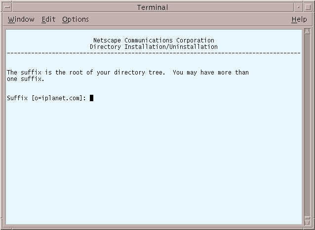

The Directory Tree Suffix screen displays. Enter a suffix for this installation, for example, o=bxinstall.com.

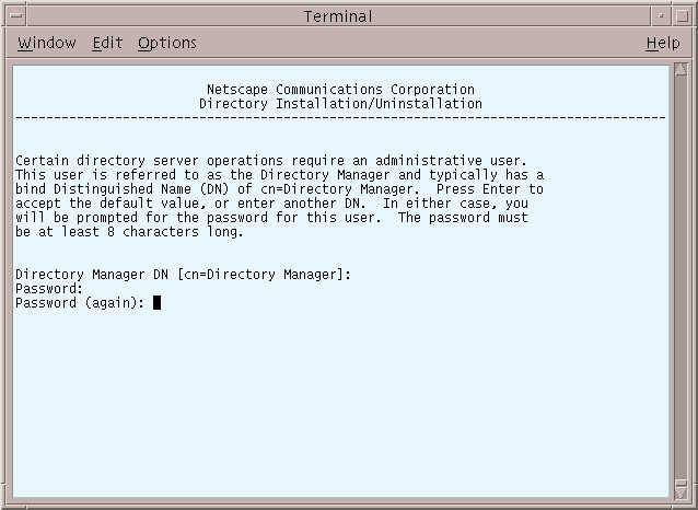

The Directory Manager Distinguished Name (DN) screen displays. Press Enter to accept the default Directory Manager DN, then enter your password and the password again.

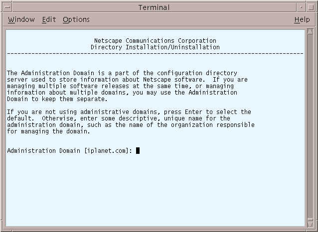

The Administration Domain screen displays. You must use iplanet.com.

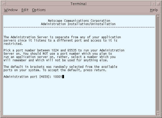

The Administration Server Port screen displays. Type 10001 or your port number.

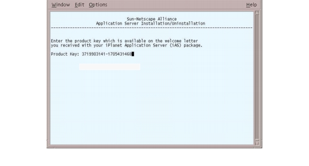

At the next screen, enter your product key (iAS serial number).

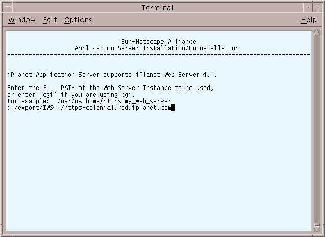

The Web Server Instance screen displays. Enter the web server instance location where iWS is installed.

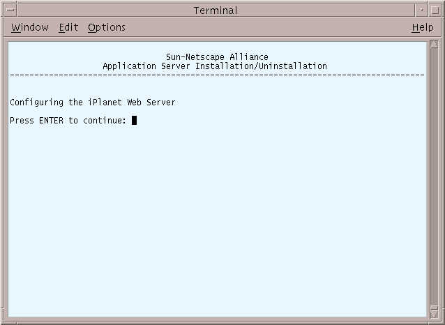

The next screen displays with this message: Configuring the iPlanet Web Server. Press Enter to continue.

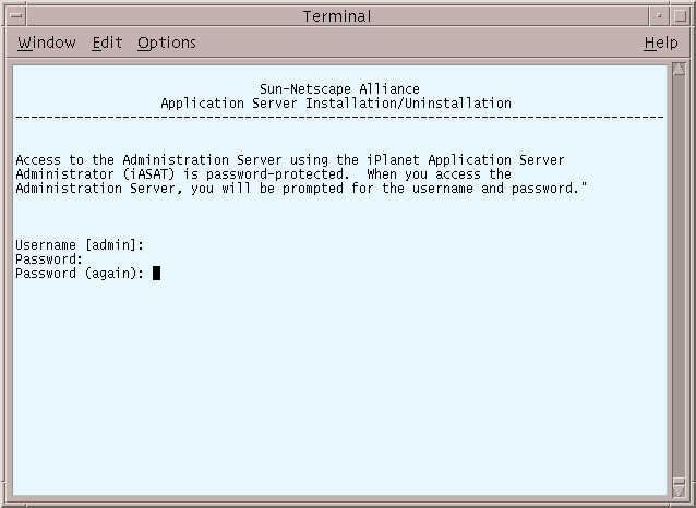

The Administration Server Username and Password screen displays. Enter your administration server username, your password, and the password again.

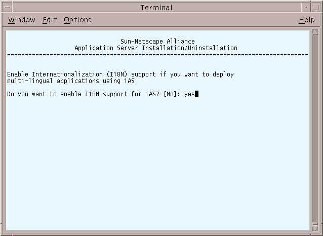

The Enable Internationalization screen displays. Type Yes to enable international support for iAS.

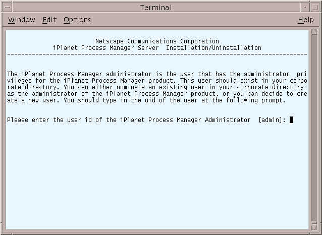

The Process Manager Administrator User ID screen displays. Enter the user ID of the Process Manager administrator or press Enter to accept the default.

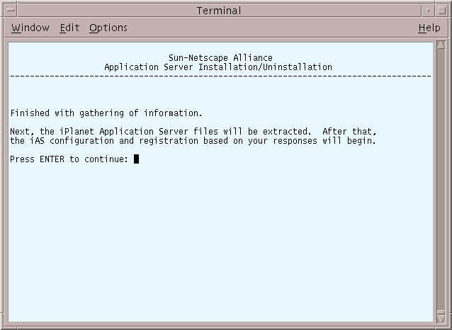

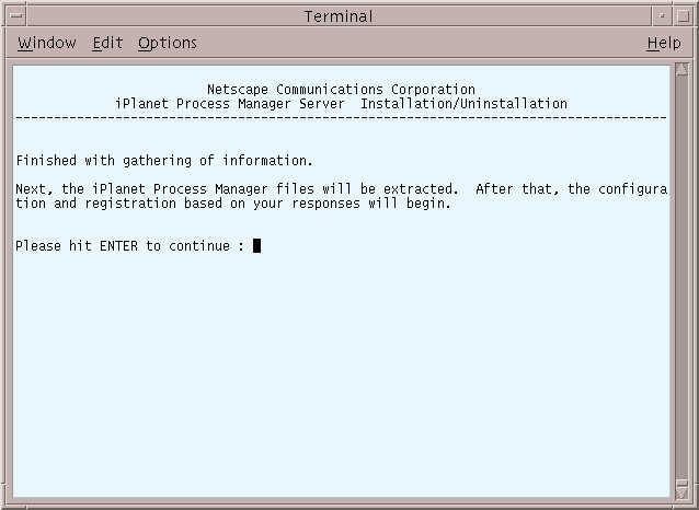

The installer has finished gathering information. Press Enter to continue.

Run startconsole from IWS_ROOT.

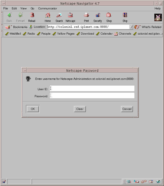

The browser is launched and the login screen displays. Enter the username and password you created in Step 11.

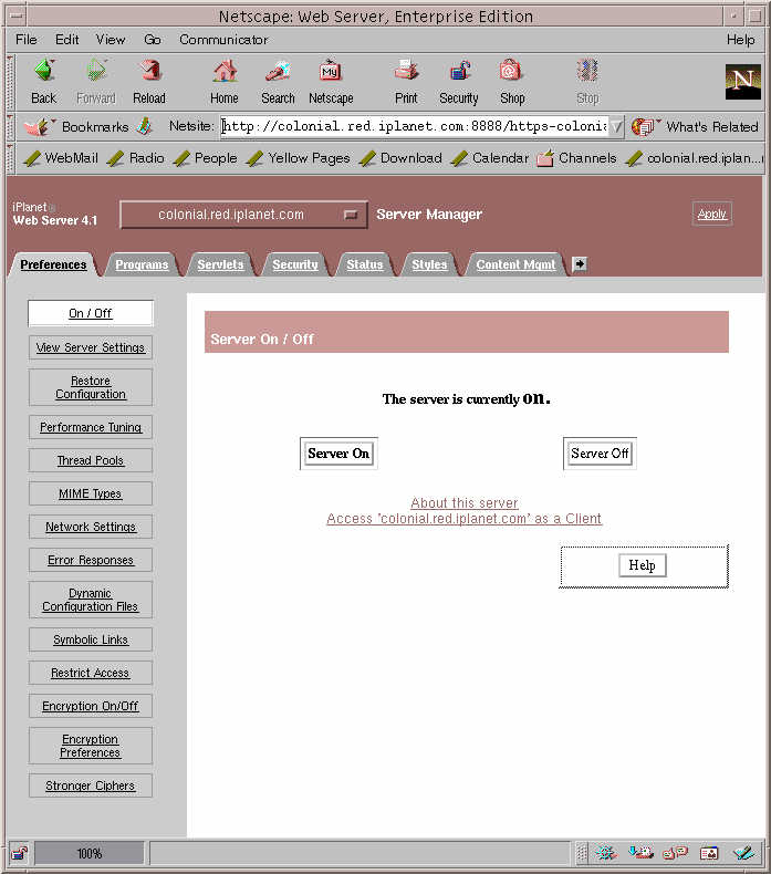

The Manage Server screen displays. Click the server name (located next to Select a Server) and then click Manage.
The Server On/Off screen displays with this message: Click Server Off.
A message displays Warning: manual edits not loaded. Apply the changes by clicking Load Configuring Files.
The Server On/Off screen displays with this message: The server is currently on.

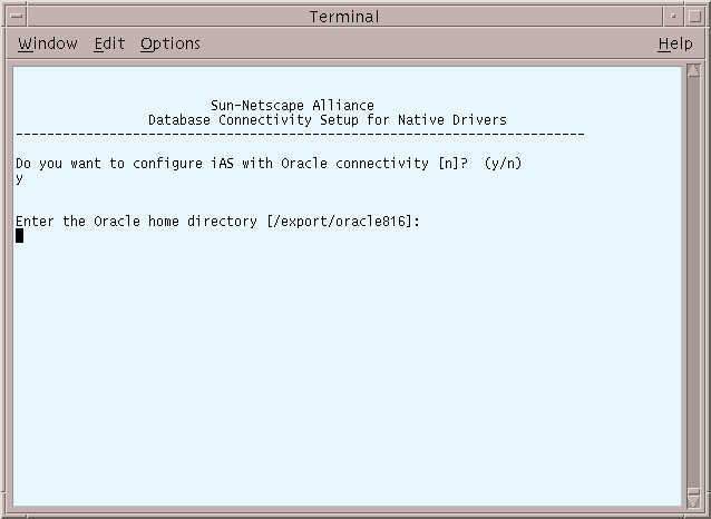

Enabling the Database with iAS

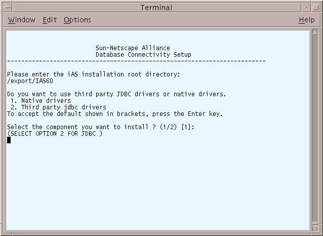

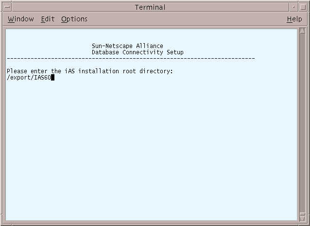

Set up the database session script:
The Database Connectivity Setup prompt displays. Enter the location where iAS is installed (shown as /export/IAS60 in the example).
The Driver Installation screen displays. Press Enter to continue.

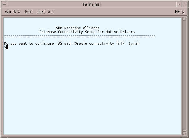

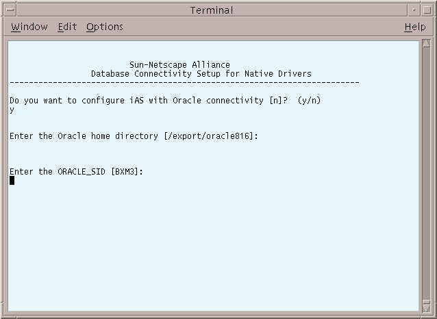

The Configuring with Oracle prompt displays. Type Y to configure iAS with Oracle.
The Oracle prompt displays. Enter your Oracle home directory.
The next Oracle prompt displays. Enter your Oracle SID that you wish to connect to.

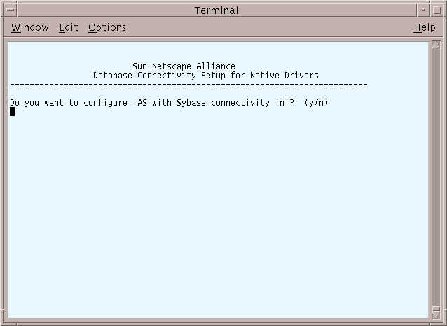

The Sybase prompt displays. Press Enter to continue.

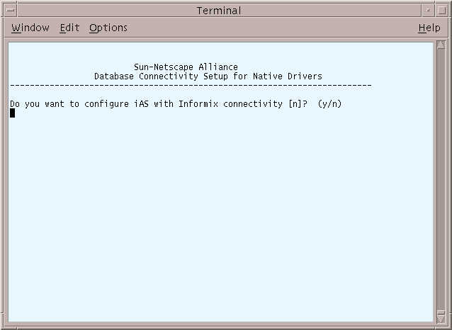

The Informix prompt displays. Press Enter to continue.

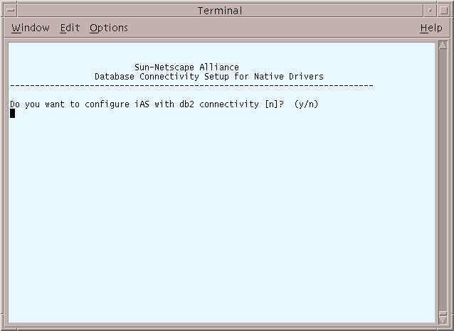

The db2 prompt displays. Press Enter to continue.

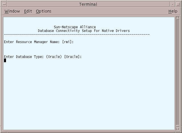

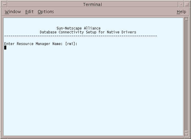

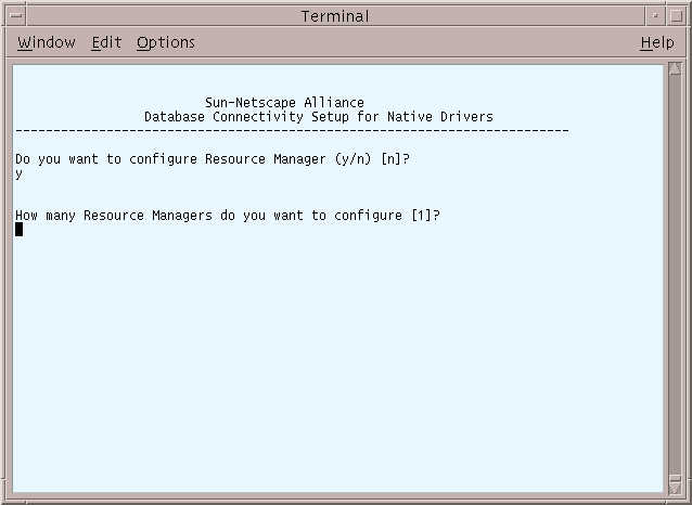

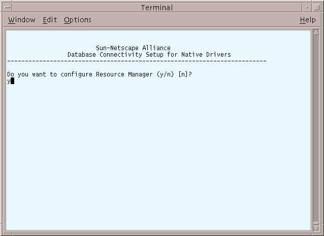

The next prompt displays. Type Y to configure the Resource Manager.
The next prompt displays. Press Enter to accept the default.

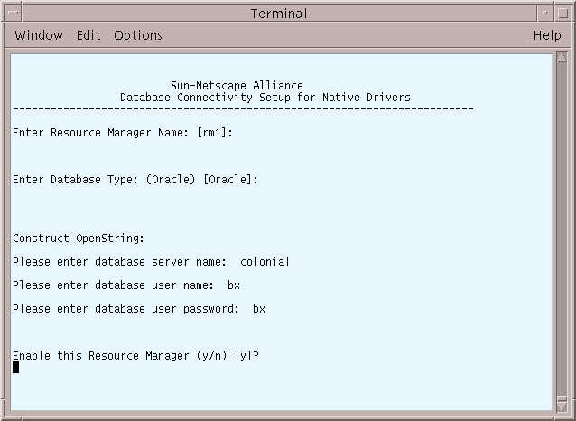

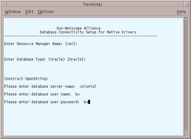

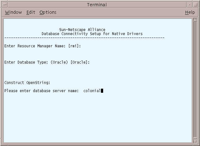

The next prompt displays. Enter the database server name (the machine where Oracle is installed).
The next prompt displays. Enter the database user name and password.
Note During BuyerXpert installation, you will need to specify this Oracle user name and password. The BuyerXpert installer will create this user in Oracle.
The next prompt displays. Press Enter to enable the Resource Manager.

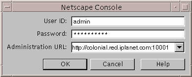

Start console using this command:
When this screen displays, enter your password and click OK. This is the password you specified in Step 19 of the iAS installation.

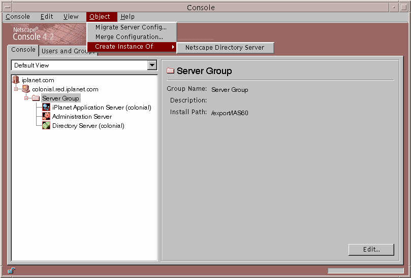

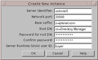

Choose the Server Group, located on the left side of the screen. Click Object, then from the drop-down menu, choose Create Instance of Netscape Directory Server.
The Create New Instance window displays.
In the network port number field, type 20000 or your specific port number.
Create a password and then re-enter it again to confirm.
Note The network port number and root DN password will be required entries when installing SellerXpert.

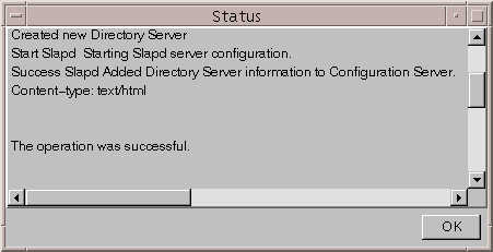

Click OK. The following screen displays. Click OK.

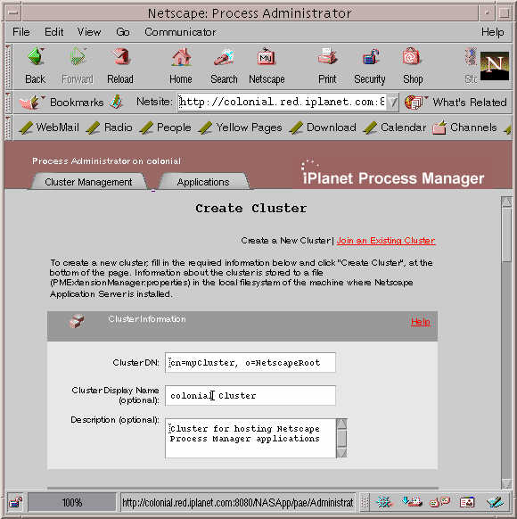

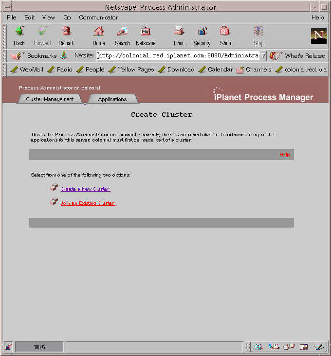

Enter the URL:
Enter your iAS user ID and password.
- http://machine-name.domain-name:iWS-port-number/Administrator.apm
Select create new cluster and the Cluster Information screen displays.
In the Cluster Name field, type the name of your choice.

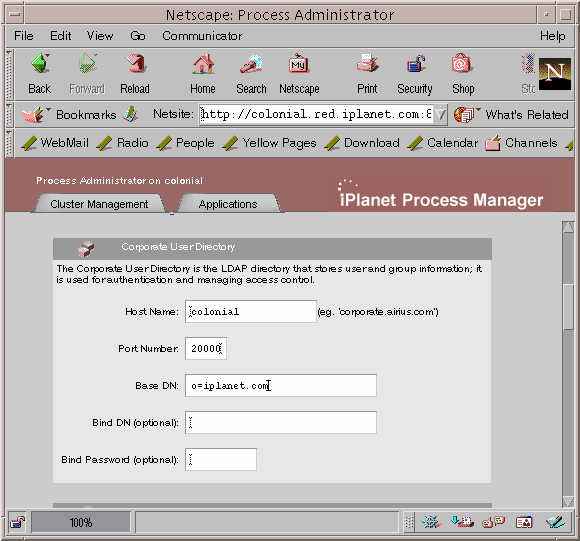

Scroll down to the Corporate User Directory Information part of the screen.
In the Host Name field, type your host name.
In the Port field, type 20000. This is the network port number that you created in Chapter 3, Section Creating an iPlanet Directory Server (LDAP) Instance, Step 5.
In the User Directory Base DN field, specify the DN for the root directory. For example, enter o=iplanet.com if your BuyerXpert configuration setting directory root DN is set to o=iplanet.com.

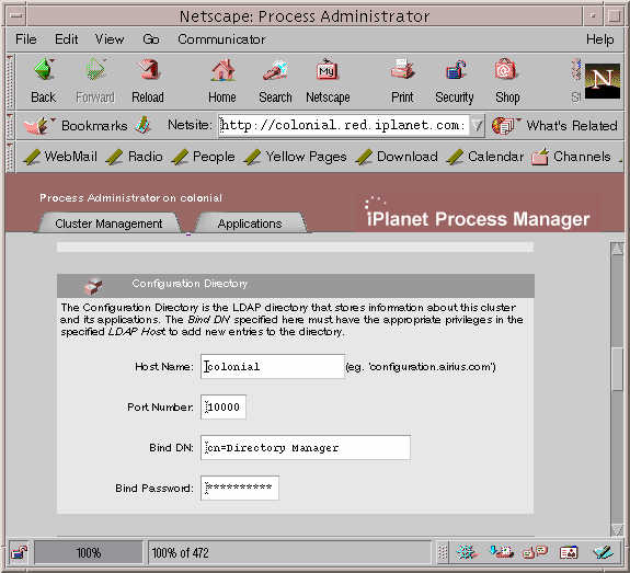

Scroll down to the Configuration Directory Information.
Enter the iAS directory server network port.
Type the bind password (your iAS password).

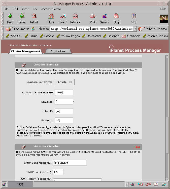

Scroll down to display the Database Screen.
Select DB Server Type, then select Oracle.
In the DB Server Identifier field, type your Oracle SID.
Note The Database field (displayed with a *) should be kept blank.
Type the Oracle database user ID and the password that was created earlier.
The Mail Server Information screen displays.
Type your SMTP e-mail server name.

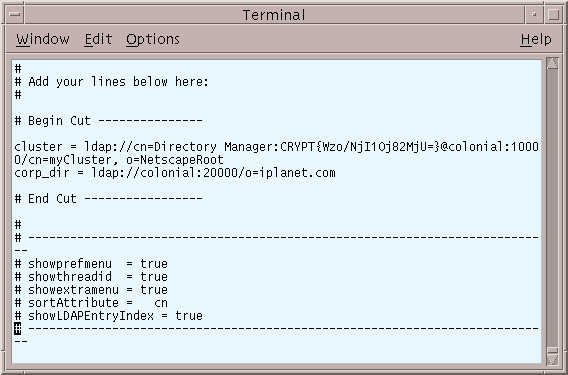

After the cluster has been created, from any text editor, copy the lines that start with # Begin Cut -------------- to the end (End Cut ------).
Open the iAS installation dir/builder/preferences.ini file.
Add the lines copied in Step 23 to just below this line.
Verify that your file looks like the following:
