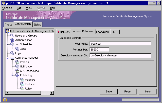

Log in to the CMS window (see "Logging In to the CMS Window").
Select the Configuration tab, and then in the right pane, select the Internal Database tab.
Identify a Directory Server instance by providing the following details:
To save your changes, click Save.
- Host name. Type the full host name of the machine on which Netscape Directory Server is installed. Certificate Management System uses this name to access the directory. The format for the host name is as follows:
- <machine_name>.<your_domain>.<domain>
- By default, the host name of the Directory Server instance being used as the internal database is shown as localhost instead of the actual host name (for example, certificates.netscape.com). This is done on purpose to insulate the internal database from being visible outside the systemthat is, a server on localhost can only be accessed from the local machine. Thus, the default configuration minimizes the risk of someone connecting to this Directory Server instance from outside the local machine.
- You can configure the host name to something other than localhost if you know what you are doing and you think you can limit the visibility of the internal database to a local subnet. For example, if you installed Certificate Management System and Directory Server on separate machines for load balancing, you will have to specify the host name of the machine in which Directory Server is installed.
- Port number. Type a TCP/IP port number; Certificate Management System uses this port for non-SSL communications with the Directory Server instance that is functioning as the internal database. Make sure that the port you specify is unique on the host system.
- Directory manager DN. Type the distinguished name (DN) of an entry in your LDAP directory that has read and write permission to the entire directory tree. Certificate Management System will use this DN when it accesses the directory tree to communicate with the directory. Keep in mind that the access control set up for this DN determines whether Certificate Management System can communicate with the directory. Typically, you would want to enter the directory manager's DN (the root DN) because this DN will have read/write permission to the entire directory tree.
- The CMS configuration is modified. If the changes you made require you to restart the server, you will be prompted accordingly. In that case, restart the server.

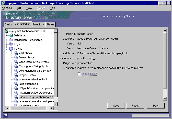

Log in to Netscape Console (see "Logging In to the CMS Window").
In the Console tab, select the server group that contains the CMS instance you want.
Select the entry that corresponds to the internal database to which you want to restrict access, and click Open.
Select the Configuration tab.
- The Directory Server window appears.
In the navigation tree, expand Plugins, and then select Pass Through Authentication.
In the right pane, uncheck or disable the "Enable plugin" option.
Click Save to save your changes.
Click the Tasks tab and click "Restart the Directory Server."
- You are prompted to restart the server.
Close the Directory Server window.

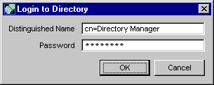

When the server is restarted, from Netscape Console, open the Directory Server window.
- The "Login to Directory" dialog box appears; the Distinguished Name field displays the Directory Manager DN and you're required to enter the password that corresponds to this entry.
- The Directory Server window (for the internal database) opens only if you enter the correct password.
