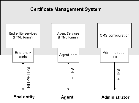

Certificate Management System listens to different ports for requests from different users. As illustrated in Figure 11-1, it listens to the administration port, the agent port, and end-entity ports.
Figure 11-1    CMS ports for administration, agent, and end-entity operations ![]()

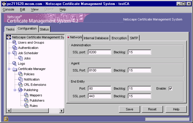

To change the administration, agent, or end-entity port numbers used by a CMS instance:
Log in to the CMS window (see "Logging In to the CMS Window").
To change the administration port number, enter the port number in the Administration section:
To change the end-entity port numbers, enter the port numbers in the End Entity section.
- SSL port. Type a TCP/IP port number. Certificate Management System uses this port for SSL-enabled communications with the CMS windowthat is, HTTPS requests from administrators. Make sure the port number you specify is unique on the host system.
- Backlog. Type the number of connections that can be waiting to be serviced at the administration port. The default number is 15. The number you enter in this field is passed to the operating system's listen() call.
- To change the agent port number, enter the port number in the Agent section:
- SSL port. Type a TCP/IP port number. Certificate Management System uses this port for SSL-enabled communications with the Agent Services interfacethat is, HTTPS requests from agents. Make sure the port number you specify is unique on the host system.
- Backlog. Type the number of connections that can be waiting to be serviced at the agent port. The default number is 15. The number you enter in this field is passed to the operating system's listen() call.
To save your changes, click Save.
- Certificate Management System is capable of simultaneous SSL and non-SSL communications at the end-entity port. This means that you do not have to choose between SSL and non-SSL communications; you can use both at the same time. But if you prefer, you can disable the non-SSL port by unchecking the "Enable" option.
- Port. Type a TCP/IP port number that is unique on the host system. Certificate Management System uses this port for non-SSL communications with the end entity services interface.
- This port is provided to allow enrollments of end entities that do not support SSL; for example, HTTP requests from end entities such as routers. You can use the Enable check box to turn this port on or off. Keep in mind that if this port is enabled, end entities will be able to enroll over HTTP too, which means their certificate requests could be intercepted and replayed to the server.
- If the CMS instance includes a Certificate Manager and if the Certificate Manager is configured to service OCSP requests from OCSP-compliant clients, then this port must be enabled so that OCSP-compliant clients can successfully query the Certificate Manager for the revocation status of a certificate. For details, see "Setting Up a Certificate Manager with OCSP Service".
- Backlog. Type the number of connections that can be waiting to be serviced at the end entity HTTP port. The default number is 15. The number you enter in this field is passed to the operating system's listen() call.
- Enable. This check box allows you to enable or disable the HTTP port. Uncheck the option if you want to disable the port.
- For issuing certificates to routers (using the CEP protocol), the port must be enabled. For details, see Chapter 25 "Setting Up CEP Enrollment."
- SSL port. Type a TCP/IP port number. Certificate Management System uses this port for SSL-enabled communications with the end entity services interface (that is, HTTPS requests from end entities during certificate enrollment, renewal, and revocation). Make sure the port number you specify is unique on the host system.
- If you don't want end-entity interaction with a subsystem, for example, if you don't want end entities to interact with a Certificate Manager, you can disable this port too (in addition to the HTTP port). See "Step 6. Enable End-Entity Interaction".
- Backlog. Type the number of connections that can be waiting to be serviced at the end-entity HTTPS port. The default number is 15. The number you enter in this field is passed to the operating system's listen() call.
