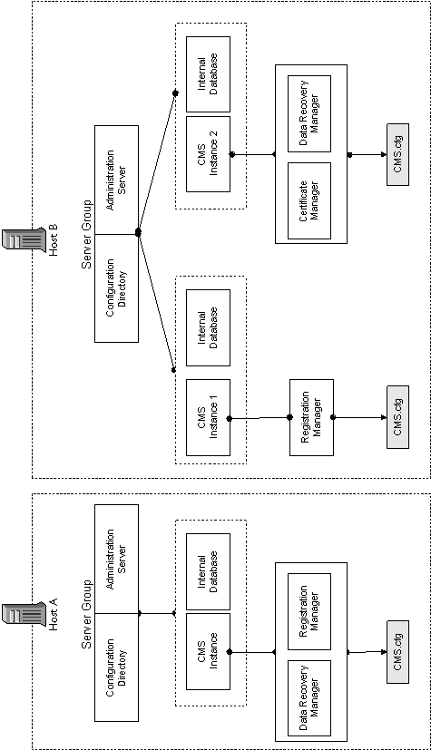

For each instance of Certificate Management System there is a configuration file, named CMS.cfg. The configuration file controls the runtime properties of the corresponding CMS instance.A CMS instance can include a single subsystem or two subsystems in one of the following combinations:
A single Certificate Manager, Registration Manager, Data Recovery Manager, or Online Certificate Status Manager
Figure 10-1 illustrates a deployment scenario involving two instances of Certificate Management System running on the same host (Host A) and a single instance running on another host (Host B). Notice the two separate configuration files for the instances running on Host A, one for each CMS instance.Although the names of both the configuration files are the same, the information included in the files differs according to the subsystems installed in each instance. For example, the configuration file for CMS Instance 1 includes only those parameters that govern the Registration Manager, whereas the configuration file for CMS Instance 2 includes parameters that control both the Certificate Manager and Data Recovery Manager.
It is also important to understand that subsystems installed in a CMS instance share certain parts of the configuration. They use the same
Administration, agent, and end-entity ports for interaction
Internal token and trust database
SSL ciphers during SSL negotiation
Figure 10-1    How installation affects configuration ![]()

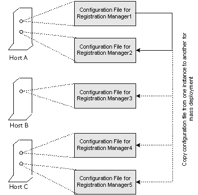

Duplicating Configuration From One Instance to Another
If you have deployed a large number of CMS instances that are identicalfor example, multiple Registration Managersand you want all these instances to have the same configuration, you can accomplish this by configuring one of the instances and then replacing the configuration files of the other instances with the one that contains the required configuration. Figure 10-2 illustrates this quick way of deploying multiple Registration Managers with the same configuration.
Figure 10-2    Duplicating a configuration ![]()
