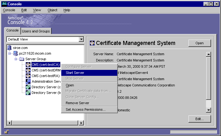

You can use Netscape Console to start an instance of Certificate Management System running on a local or remote host.To start Certificate Management System from Netscape Console:
Log in to Netscape Console (see "Logging In to Netscape Console").
In the Console tab, select the Server Group that contains the CMS instance you want to start.
In the navigation tree, locate the CMS instance you want to start.

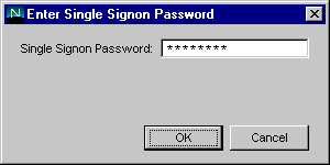

Select the instance, right-click, and select the Start Server option from the pop-up menu.
Type the single sign-on password you specified during installation and click OK.
- When you start Certificate Management System, you are prompted to supply the single sign-on password for the server.
- Certificate Management System won't start until you provide this password. For more information, see "Required Start-up Information".

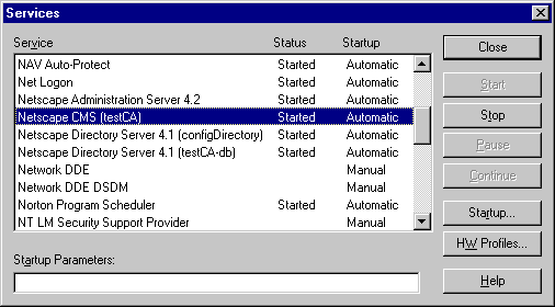

Starting From the Windows NT Services Panel
If you have installed Certificate Management System on a Windows NT system, you can start the server (as a service) from the Windows NT Services panel (see Figure 8-1). The CMS service has the following name:
Figure 8-1    CMS service in the Windows NT Services panel ![]()
To start Certificate Management System from the Windows NT Services panel:
Click the Start button on your desktop.
Select Control Panel from Settings.
In the Control Panel window that appears, click Services.
Select the CMS instance and click Start.
Enter the single sign-on password you specified during installation and click OK.

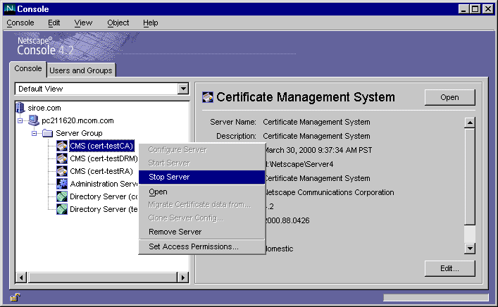

Stopping From Netscape Console
You can use Netscape Console to stop an instance of Certificate Management System running on a local or remote host.To stop Certificate Management System from Netscape Console:
In the Console tab, select the Server Group that contains the CMS instance you want to stop.
In the navigation tree, select the CMS instance you want to stop, right-click, and select the Stop Server option from the pop-up menu.

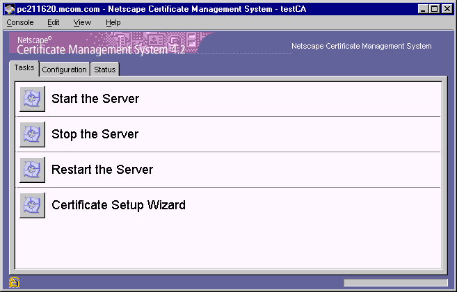

Restarting From the CMS Window
You can use the CMS window to restart an instance of Certificate Management System on a local or remote host.To restart Certificate Management System from the CMS window:
Log in to the CMS window (see "Logging In to the CMS Window").
In the Tasks tab, click Restart the Server.
- When you restart Certificate Management System, you are prompted to supply the single sign-on password for the server.
- Certificate Management System won't restart until you provide this password. For more information, see "Required Start-up Information".

When prompted, enter the single sign-on password.

You can use Netscape Console to find out whether a particular instance of Certificate Management System is running.
In the Console tab, select the instance that corresponds to the CMS instance you want to check.
In the right pane, check the Server Status field.
