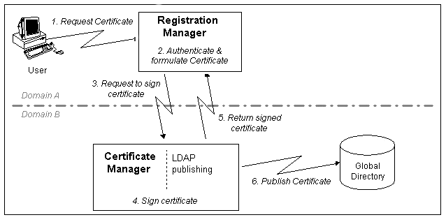

Figure 19-3 illustrates how certificates requested via a Registration Manager get published to the directory.
Figure 19-3    Publishing of certificates requested via a Registration Manager ![]()

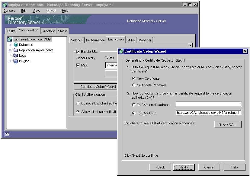

Generate an SSL server certificate request for Directory Server.From the Console menu, choose the Manage Certificates option.
Scroll through the list to see if it contains the SSL server certificate that you want to use.
- The Certificate Management dialog box appears showing a list of all the certificates installed for Directory Server.
- If the server has an SSL server certificate, check the CA that has issued the certificate. If this CA is trusted by the Certificate Manager, you can configure Directory Server to use the same certificate. If the CA is untrusted by the Certificate Manager and you want the Certificate Manager to trust it, you need to check the Certificate Manager's certificate database for the CA certificate, add it if it isn't present, and specify that it be trusted. For instructions on manipulating the Certificate Manager's certificate database, see "Changing the Trust Settings of a CA Certificate".
- After you've made sure that the CA is trusted by the Certificate Manager, go to Step 10.
- If the server does not have an SSL server certificate, or if you don't want the Certificate Manager to trust the CA that has issued the Directory Server's certificate, you must get an SSL server certificate for the Directory Server from a CA that is trusted by the Certificate Manager. You may get this certificate from the Certificate Manager itself. The instructions that follow (Step 2 through Step 9) explain how to do this.
- The steps below explain in general how to generate a certificate signing request (CSR) using the Certificate Setup Wizard, which is built into the Directory Server window available within Netscape Console. For detailed instructions on each step of the wizard, you should read the on-screen instructions and view the online help by clicking the Help button.
- In the first step of generating the CSR, you will be asked to specify whether the certificate is for a new key pair or an exiting key pair and the method for submitting the CSR to the CA.
- If you want to request the certificate from an external CA, you should click the Show CA button to see whether the CA of your interest is listed there. If it is listed, you can open the SSL server enrollment interface of that CA so that you can paste the CSR the wizard will generate.
- If you want to request the certificate from the Certificate Manager, there are three possible ways in which you can submit the CSR to the Certificate Manager:
Submit the CSR directly from the wizard; in this method, you do not need to copy the CSR the wizard generates.
Submit the CSR as an email to the CA's administrator; to use this method, you need to know the email address of the person who processes certificate requests for the CA and you need to copy the CSR the wizard generates.
Submit the CSR manually by pasting it into the Certificate Manager's SSL server enrollment form; to use this method, you need to copy the CSR the wizard generates.
In the Directory Server window, select the Tasks tab, and then click the Certificate Setup Wizard button.
Submit the request to a CA and get the SSL server certificate.Select the token for generating the key pair (and for storing the certificate). Since you don't have the certificate, select No.
When prompted for the password, enter the password.
- If you're generating the certificate for the first time, the wizard informs you that it needs to create a trust database (cert7.db and key3.db files) for Directory Server.
You are asked to specify whether the certificate is for a new key pair or an existing key pair and the method for submitting the CSR to the CA.
- Remember this password because you will be required to supply it when starting Directory Server from now on. Once the trust database is generated, the wizard steps for generating the CSR begin.
When the wizard displays the CSR, if you are running the wizard on a Windows NT system, copy the CSR (displayed in its base-64 encoded format) to a text file. The information you copied should look similar to the sample shown below. Do not make any changes to it. (As indicated in the message, a copy of this information is also saved to the /temp file in the host machine's file system.)
- The choices for submitting the CSR to the CA include the following:
- To CA's email address. Select this if you want to send the CSR to the CA administrator's email address. Type the administrator's email address (for example, jdoe@siroe.com) in the adjoining field. The administrator will then be required to submit the request to the CA by pasting the CSR in the CA's server enrollment form.
- To CA's URL. Select this if you want to submit the CSR to the Certificate Manager directly. Depending on the end-entity port that's enabled, type either of the following URL:
- http://<CA_hostname>:<end_entity_port>/enrollment or https://<CA_hostname>:<end_entity_SSL_port>/enrollment
- Note that the request submitted to the CA's URL gets queued for approval by the Certificate Manager agent.

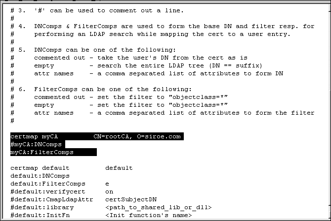

Step F. Modify the Certificate Mapping File
This step explains how to modify the certmap.conf file to add a certificate mapping rule for the CA's entry you created. You need to go through this step only if you configured the directory for SSL client authenticated communication. Otherwise, skip to "Step G. Restart Directory Server".When the Certificate Manager presents its certificate for SSL client authentication, Directory Server uses the mapping rule specified in the certmap.conf file to locate the corresponding entry in the directory and then determine the access privileges set for the entry. The certificate mapping file is located in the <server_root>/shared/config directory, where <server_root> is the directory in which the Directory Server binaries are installed.
The certmap.conf file specifies the following:
Where in the directory tree the server should begin its search for locating the entry in the directory
The file contains one or more named mappings, each applying to a different CA. A mapping has the following syntax:What certificate attributes the server should use as search criteria when searching for the entry in the directory
Whether the server needs to go through any additional verification process
certmap <name> <issuerDN>
<name>:<property1> [<value1>]
<name>:<property2> [<value2]
<name>:<propertyn> [<valuen]The first line specifies a name for the entry and the DN of the issuer of the client certificatein this case, the issuer of the certificate the Certificate Manager will present during client authentication. (By default, the Certificate Manager uses its SSL server certificate generated during installation.) The name is arbitrary; you can define it to be whatever you want. However, the issuer DN must exactly match the issuer DN of the CA that has issued the certificate the Certificate Manager will use for client authentication. For example, the following two issuer DN lines differ only in the number of spaces separating the attribute value assertions (AVAs), but the Directory Server will treat these two entries as different:
certmap moz CN=myCA,OU=myDept,O=myCompany,C=US
certmap moz CN=myCA,OU=myDept,O=myCompany, C=USThe second and subsequent lines in the named mapping match properties with values. The certmap.conf file has six default properties, but the ones that should be of use to you are explained below. For in depth detail about the certmap.conf file, see Managing Servers with Netscape Console.
DNCompsThis is a list of comma-separated DN attribute tags used to determine where in the directory the server should start searching for directory entries that match the Certificate Manager's information (that is, the owner of the client certificate). The Directory Server gathers values for these tags from the certificate presented by the Certificate Manager during client authentication and uses the values to form an LDAP DN, which then determines where the server starts its search in the directory. For example, if you set DNComps to use the <O=org> and <C=country> DN attribute tags (DNComps=O,C) the server starts the search from the O=<org>, C=<country> entry in the directory, where <org> and <country> are replaced with values from the values specified in the subject DN of the certificate presented for client authentication.
The following two examples illustrate two different ways you can use the certmap.conf file.
If the DNComps entry is present but has no value, the server searches the entire LDAP tree for entries matching the filter.
If there isn't a DNComps entry in the mapping, the server uses either the CmapLdapAttr setting (if present) or the entire subject DN in the Certificate Manager's certificate.
FilterCompThis is a list of comma-separated DN attribute tags used to create a filter by gathering information from the subject DN in the certificate presented during client authentication. Directory Server uses the values for these tags to form the search criteria for matching entries in the directory. If Directory Server finds one or more entries in the directory that match the Certificate Manager's information gathered from the certificate, the search is successful and the server optionally performs a verification. For example, if FilterComps is set to use the attribute tags E and UID (FilterComps=E,UID), the server searches the directory for an entry whose values for E and UID match the Certificate Manager's information gathered from the client certificate. Email addresses and user IDs are good filters because they are usually unique entries in the directory.
- The following component tags are supported for DNComps: CN, OU, O, C, L, ST, E, and Mail. Case is ignored. You can use E or Mail, but not both.
verifycertThis tells the server whether it should compare the certificate the Certificate Manager presents during client authentication with the certificate found in the Certificate Manager's entry in the directory. It takes one of the two values: on or off. It is recommended that you set this to on for a complete single sign-on solution. This ensures that Directory Server will authenticate the Certificate Manager unless the certificate presented exactly matches the certificate stored in the directory.
- Note that the filter needs to be specific enough to match only the Certificate Manager's entry in the LDAP directory. The following component tags are supported for FilterComps: CN, OU, O, C, L, ST, E, and Mail. Case is ignored. You can use E or Mail, but not both.
certmap default default
default:dnComps
default:filterComps E, UIDcertmap MyCA CN=CA,OU=MyGroup,O=MyCompany,C=US
MyCA:dnComps OU,O,C
MyCA:filterComps E
MyCA:verifycert onThis file has two mappings: a default one and another for MyCA. When the Directory Server gets a certificate from anyone other than MyCA, the server uses the default mapping, which starts at the top of the LDAP tree and searches for an entry matching the client's email address and user ID. If the certificate is from MyCA, the server starts its search at the LDAP branch containing the organizational unit and searches for matching email addresses. Also note that if the certificate is from MyCA, the server verifies the certificate with the one stored for the entry in the directory; other certificates are not verified. Note that the issuer DN in the certificate must be identical to the issuer DN listed in the first line of the mapping. Even an extra space after a comma will cause a mismatch.
To modify the certmap.conf file:
In the Directory Server host machine, go to this directory: <server_root>/shared/config
Open the certmap.conf file in a text editor.
Follow the instructions in the file and add the mapping information for the entry you added.
Save your changes, and close the file.
- The figure above shows the following mapping rule being added to the file:
- certmap myCA CN=rootCA, O=siroe.com
#myCA:DNComps
myCA:FilterComps
- This mapping rule specifies that if the name of the CA that signed the certificate used for SSL client authentication by the Certificate Manager is myCA and that the issuer name or DN of the CA is CN=rootCA, O=siroe.com, the server should use the FilterComps attributes to locate the entry.
- If you determine that the certmap.conf file needs an empty DNComps mapping (because your certificate subject name has no overlap with the corresponding directory DN), you may need to modify the default base DN in Directory Server by adding the following to the Directory Server configuration file:
- dn: cn=config
changetype: modify
replace: nsslapd-certmap-basedn
nsslapd-certmap-basedn: dc=siroe, dc=com

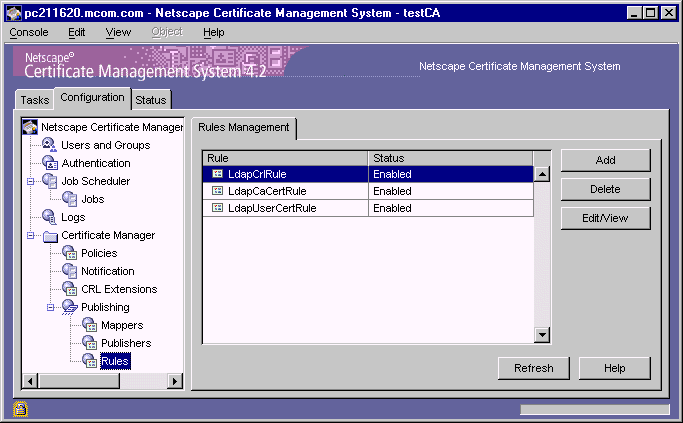

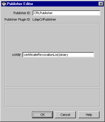

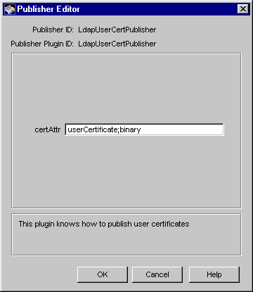

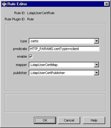

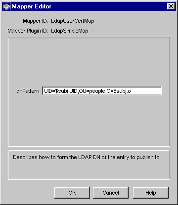

Step A. Modify the Default Mappers, Publishers, and Publishing Rules
Complete this step if you decided to use any of the default mappers, publishers, and publishing rules created during installation. If you want to create new mappers, publishers, and publishing rules, skip to the next step, "Step B. Add Mappers, Publishers, and Publishing Rules".During installation, the Certificate Manager automatically creates a set of mappers that you would most likely want to use. The names of the default mappers are as follows:
LdapUserCertMapfor locating the correct attribute of user entries in the directory in order to publish user certificates.
Similar to mappers, the Certificate Manager also creates a set of publishers for your convenience. The names of the default publishers are as follows:LdapCrlMapfor locating the correct attribute of the CA's entry in the directory in order to publish the CRL.

Modifying the Default Mappers
You can modify a mapper by editing its configuration parameter values; you cannot change the name of a mapper. To change the name of a mapper, you need to create a new mapper exactly like the mapper you want to rename, except with a new name, and delete the old mapper.
Log in to the CMS window for the Certificate Manager (see "Logging In to the CMS Window").
In the navigation tree, select Publishing, and then select Mappers.
In the Mapper list, select a mapper that you want to modify.
Click Edit/View.
- For the purposes of completing this instruction, assume that you selected the mapper named LdapUserCertMap.
Make the necessary changes and click OK.
To modify the remaining mappers, repeat steps Step 4 through Step 6.

In the navigation tree, select Publishing, and then select Rules.
In the Rule list, select a publishing rule that you want to modify.
Click Edit/View.
To modify the remaining rules, repeat steps Step 2 through Step 4.

Select the module named LdapCaCertPublisher.
Click Next.
- Only this module publishes the CA certificate to caCertificate;binary attribute in the CA's directory entry. (If you have registered any custom publisher modules, they too will be available here for selection.)
Enter the appropriate information:
Click OK.
- Publisher ID. Type a unique name for the publisher that will help you identify it later; be sure to use an alphanumeric string with no spaces.
- caCertAttr. The field shows caCertificate;binary, the directory attribute to publish the CA certificate. Leave it as it is. If the field is empty, type caCertificate;binary.
- caObjectClass. The field shows certificationAuthority, the object class for the CA's entry in the directory. Leave it as it is. If the field is empty, type certificationAuthority.
Click OK.
- Rule ID. Type a name for the rule; use an alphanumeric string with no spaces.
- enable. Select this option.
- predicate. Type HTTP_PARAMS.certType==client, indicating that the rule be applied to client certificates only (see Table 19-2).
- type. Select certs.
- mapper. Select the mapper you added for locating end-entity entries in the directory.
- publisher. Select the publisher you added for publishing end-entity certificates (to the userCertificate;binary attribute of an end-entity entry in the directory).

Select the module named LdapCrlPublisher.
Click Next.
- Only this publisher module enables the Certificate Manager to publish the CRL to the certificateRevocationList;binary attribute of the CA's directory entry. (If you have registered any custom publisher modules, they too will be available for selection.)
Click OK.
- Publisher ID. Type a name for the rule; use an alphanumeric string with no spaces. For example, CRLPublisher.
- crlAttr. Make sure this field shows the directory attribute to publish the CRL, certificateRevocationList;binary. If necessary, type it in.

Modify the default publishing rule for user certificates by changing the value of the predicate parameter to HTTP_PARAMS.certType!=ca.
Use the LdapCaCertPublisher publisher plug-in module to add another rule, with the predicate parameter set to HTTP_PARAMS.certType==ca, for publishing subordinate CA certificates.
