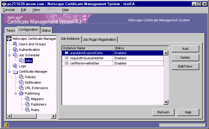

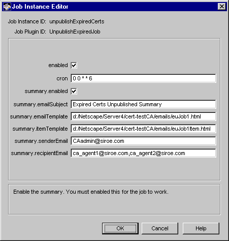

To modify a configured job in the CMS configuration:
Log in to the CMS window (see "Logging In to the CMS Window").
In the navigation tree, select Job Scheduler, then select Jobs.
In the Instance Name list, select a job that you want to modify.
- The Job Instance tab appears (Figure 17-1) showing the default jobs.
Click Edit/View.
Make the necessary changes and click OK.
- The Job Instance Editor window appears, showing how this job is currently configured. An example is shown below.

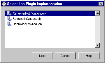

To add a job to the CMS configuration:
In the Job Instance tab, click Add.
Select a module.
Click Next.
Enter the appropriate information.
- The Configure Job Instance Parameters window appears. It lists the configuration information required for this job.
Click OK.

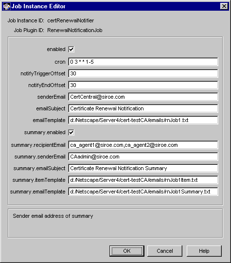

- Job Instance ID. Type a unique name that will help you identify the job. Be sure to formulate the name using any combination of letters (aA to zZ), digits (0 to 9), an underscore (_), and a hyphen (-). For example, you can type My_Job or MyJob as the instance name, but not My Job.
- enabled. To enable the job, type true; to disable the job, type false.
- cron. Specifies the cron specification for when this job should be run. In other words, it specifies the time at which the Job Scheduler daemon thread should check the certificates for sending renewal notifications. For example, 03**1-5.
- notifyTriggerOffset. Type the number of days before certificate expiration the first notification should be sent. For example, if you want the server to send renewal notifications to users 30 days before their certificates expire, type 30.
- notifyEndOffset. Type the number of days after the certificate expire notifications will continue to be sent, if the certificate is not renewed. For example, if you want the server to continue sending renewal notifications to users (if they don't renew their certificates) 30 days after their certificates expire, type 30.
- senderEmail. Type the complete email address to which the server should send notifications regarding any delivery problems. For example, CertCentral@siroe.com.
- emailSubject. Type the subject line of the notification message; the subject line must be an alphanumeric string of up to 255 characters. For example, Certificate Renewal Notification.
- emailTemplate. Type the path, including the filename, to the directory that contains the template to be used for formulating the message content. For example: C:/Netscape/Server4/cert-testCA/emails/renewJob.txt.
- summary.enabled. Type true if you want the server to compile a summary report of renewal notifications and send. Type false if you don't want the server to compile a summary report of renewal notifications.
- summary.recipientEmail. Type the email addresses of recipients of the summary report; when specifying multiple recipients, separate addresses by commas. These can be, for example, agents who need to know the status of user certificates. For example, ca_agent1@siroe.com, ca_agent2@siroe.com.
- summary.senderEmail. Type the full email address of the sender (of the summary message); in case of a delivery problem, the server will send a notification to this address. For example, CAadmin@siroe.com.
- summary.emailSubject. Type the subject line of the summary message; the subject line must be an alphanumeric string of up to 255 characters. For example, Certificate Renewal Notification Summary.
- summary.itemTemplate. Type the path, including the filename, to the directory that contains the template to be used for formulating the content and format of each item to be collected for the summary report (see the summary.emailTemplate parameter below). For example, C:/Netscape/Server4/cert-testCA/emails/renewJobItem.txt.
- summary.emailTemplate. Type the path, including the filename, to the directory that contains the template to be used for formulating the summary report. For example, C:/Netscape/Server4/cert-testCA/emails/
renewJobSummary.txt.

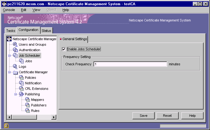

Step 5. Schedule the Frequency
The Certificate Manager and Registration Manager can execute a job only if the Job Scheduler is turned on (or enabled). As a part of turning the Job Scheduler on, you also specify the frequency at which the Job Scheduler daemon should check if any of the configured jobs need to be executed.To schedule the interval for executing the job:
In the navigation tree, click Job Scheduler.
Enter information as appropriate:
- The General Settings tab appears. It shows whether the Job Scheduler component is currently enabled or disabled.
To save your changes, click Save.
- Enable Job Scheduler. Check this option to enable the Job Scheduler. To disable the Job Scheduler uncheck the option; disabling turns off all the jobs.
- Check Frequency. Type the frequency at which the Job Scheduler daemon thread should wake up and call the configured jobs that meet the cron specification. By default, it is set to one minute.

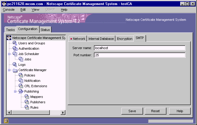

Step 6. Verify Mail Server Settings
The Certificate Manager and Registration Manager use the mail server specified in the SMTP tab (of the CMS window) for routing or sending email notifications automatically. If you've already set it up, you should verify that the host name and port number of the mail server are accurate. Otherwise, follow the procedure below to specify the mail server details.To identify the mail server that the Certificate Manager or Registration Manager should use for routing email notifications:
In the CMS window, select the Configuration tab, and then in the right pane, select the SMTP tab.
Identify the mail server by providing the following details:
- Server name. Make sure the field shows the correct host name for your mail server. Otherwise, type the full host name of the machine on which your mail server is installed. Certificate Management System uses this name to access the mail server. The format for the host name is as follows:
- <machine_name>.<your_domain>.<domain>
- By default, the host name of the mail server is shown as localhost instead of the actual host name (for example, mail.siroe.com).
- Port number. Make sure that the field shows the correct port number at which the mail server is listening for requests. Otherwise type the port number.

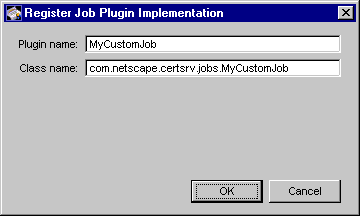

To register a job module in the CMS framework:
Select the Job Plugin Registration tab.
Click Register.
Specify information as appropriate:
Click OK.
- Plugin name. Type a name for the plug-in module.
- Class name. Type the full name of the class for this modulethat is, the path to the implementing Java class. If this class is part of a package, be sure to include the package name. For example, if you are registering a class named myJob and if this class is in a package named com.myCompany, type com.myCompany.myJob.

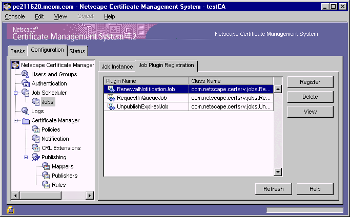

Deleting a Job Module
You can delete unwanted job plug-in modules by using the CMS window. Before deleting a module, be sure to delete all the instances that are based on this module; for instructions, see "Step 3. Delete Unwanted Jobs".To delete a job module from the CMS framework:
In the Plugin Name list, select the module you want to delete and click Delete.
When prompted, confirm the delete action.
