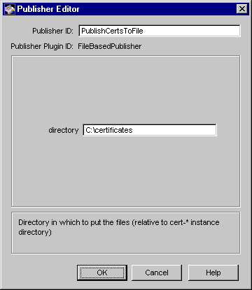

Step A. Create a Publisher for the File
Creating a publisher for the file involves creating an instance of the publisher module that enables the Certificate Manager to publish certificates and CRLs to files. In the next step, "Step B. Create Publishing Rules for Certificates", you specify the publisher you create here.
Log in to the CMS window for the Certificate Manager (see "Logging In to the CMS Window").
In the navigation tree, select Certificate Manager, select Publishing, and then select Publishers.
Click Add.
- The right pane displays the Publishers Management tab, which lists configured publisher instances.

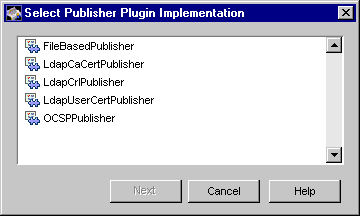

Select the module named FileBasedPublisher.
- The Select Publisher Plugin Implementation window appears. It lists registered publisher modules.
Click Next.
- Only this publisher module enables the Certificate Manager to publish certificates and CRLs to flat files.
Enter the appropriate information:
- The Publisher Editor window appears.
Click OK.
- Publisher ID. Type a name for the rule. Be sure to use an alphanumeric string with no spaces. For example, PublishCertsToFile.
- directory. Type the complete path to the directory in which the Certificate Manager should create the DER-encoded files; the path can be an absolute path or can be relative to the CMS instance directory. For example, C:\certificates.
If you want to publish certificates and CRLs to two separate directories, repeat steps 4 though 8 to create another publisher (for example, PublishCrlsToFile) with the value of the directory parameter set to the file path to the other directory (for example, C:\crls).
- You are returned to the Publishers Management tab. It should now list the publisher you just created.

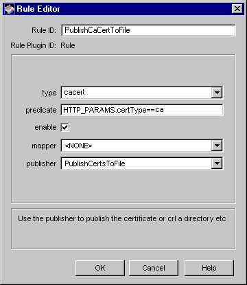

Creating a publishing rule for CA certificate and end-entity certificates involves creating a rule that uses the publisher that you created in the previous step.
In the navigation tree, under Publishing, select Rules.
Click Add.
- The right pane displays the Rules Management tab, which lists any configured publishing rules.

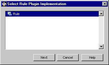

Select the module named Rule.
- The Select Rule Plugin Implementation window appears.
Click Next.
- This is the default module. (If you have registered any custom modules, they too will be available for selection.)
Click OK.
- Rule ID. Type a name for the rule that will help you identify it later; use an alphanumeric string with no spaces. For example, PublishCaCertToFile.
- type. Select cacert.
- predicate. Type HTTP_PARAMS.certType==ca.
- enable. Select this option.
- mapper. Select <NONE>.
- publisher. Select the publisher you created in the previous step, Step A. For example, PublishCertsToFile.
Repeat steps 2 through 6 to create publishing rules for each type of end-entity certificate the Certificate Manager will issue. Use Table 20-1 for filling in the correct values in the type and predicate fields. (For information on predicates, see "Using Predicates in Policy Rules".)
- The Rules Management tab appears, listing the new rule you just created for publishing the CA certificate to the file.

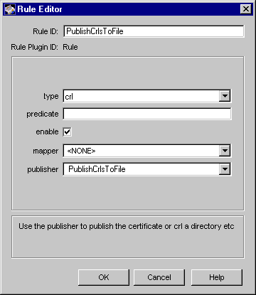

Step C. Create a Publishing Rule for CRLs
Creating a publishing rule for the CRL involves creating a rule that uses the publisher that you created in the previous step.
Click Add.
- The right pane displays the Rules Management tab, which lists configured publishing rules.
Click Next.
- The Rule Editor window appears.
Click OK.
- Rule ID. Type a name for the rule that will help you identify it later; use an alphanumeric string with no spaces. For example, PublishCertsToFile.
- type. Select crl.
- predicate. Leave this field blank.
- The Rules Management tab appears, listing the new rule you just created for publishing CRLs to files.

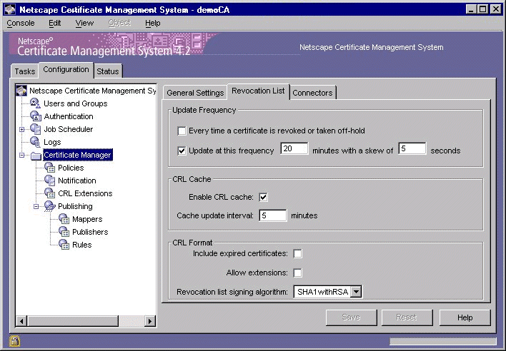

Step D. Specify CRL Details
You can specify information, such as the publishing interval, the CRL version (whether to include CRL extensions), and the signing algorithm the Certificate Manager should use for signing the CRL object.To specify the details for the CRL:
In the navigation tree, select Certificate Manager, and then in the right pane, select the Revocation List tab.
In the Update Frequency section, specify the interval for publishing the CRL to the directory:
In the CRL Cache section, specify whether to enable CRL caching:
- Every time a certificate is revoked, or taken off-hold. Select this option if you want the Certificate Manager to generate the CRL every time it revokes a certificate. Keep in mind that the Certificate Manager attempts to publish the CRL to the configured directory whenever it is generated, in this case, every time a certificate is revoked. Publishing a CRL can be time consuming if the CRL is large. Configuring the Certificate Manager to publish CRLs every time a certificate is revoked may engage the server for a considerable amount of time; during this time, the server will not be able to service any requests it receives and will not be able to update the directory with any changes it receives.
- (This setting is not recommended for a standard installation. You can select this option if you want to see the results of revocation immediately, for example, when testing whether the server publishes the CRL to a flat file.)
- Update at this frequency. Select this option if you want the Certificate Manager to generate CRLs at regular intervals. In this case, the server publishes the CRL to the configured directory at the interval you specify.
- In the adjoining text field, type the interval, in minutes, at which the Certificate Manager should publish CRLs. For example, if you want the server to publish CRLs every day, you should type 1440 in this field.
- with a skew of. If you configure the Certificate Manager to update the CRL automatically every time period, the server by default adds a 5 second skew to the next update time to allow time to create the CRL and publish it. For example, if you configure the server to update the CRL every 20 minutes, and if the CRL is updated at 16:00:00, the CRL will be updated again at 16:19:55. You can change the skew by editing the default value, which is specified in seconds.
In the CRL Format section, specify the format for publishing the CRL:
- Enable cache. Check this box to enable CRL caching. Leave the box unchecked if you don't want the server to maintain a cache.
- Update interval. If you enabled caching, type the interval for updating the cache.
To save your changes, click Save.
- Include expired certificates. Check this box if you want the server to include revoked certificates that have expired in the CRL.
- Allow extensions. Check this box if you want to allow extensions in the CRL. If you enable this option, the server generates and publishes CRLs conforming to X.509 version 2 standard. If you disable this option, the server generates and publishes CRLs conforming to X.509 version 1 standard. By default, the server publishes version 1 CRLs. If you enable this option, be sure to set the required CRL extensions as described in "Step E. Set the CRL Extensions".
- Revocation list signing algorithm. Select the algorithm the server should use to sign the CRL. If the Certificate Manager's signing key type is RSA, select MD2 with RSA, MD5 with RSA, or SHA-1 with RSA. If the Certificate Manager's signing key type is DSA, select SHA-1 with DSA.
- The configuration is modified. If the changes you made require you to restart the server, you are prompted accordingly. Don't restart the server yet; you can restart it after you've made all the required changes.

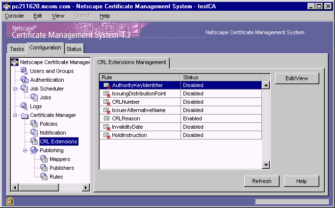

Complete this step only if you configured the Certificate Manager to publish version 2 CRLs in the previous stepthat is, if you selected the "Allow extensions" option in "Step D. Specify CRL Details".During installation, the Certificate Manager creates default CRL extension rules. Note that the server is configured to add the CRL Reason extension only; all the other rules are in the disabled state. In this step, you modify the default rules to suit your organization's requirements.
To specify the CRL extensions the Certificate Manager should set:
In the navigation tree, select Certificate Manager, and then select CRL Extensions.
To modify a rule, select it and then click Edit/View.
- The right pane shows the CRL Extensions Management tab, which lists configured extensions.
Change the information as appropriate.
Click OK.
- Be sure to supply all the required values. Click the Help button for detailed information on individual parameters.
To modify other rules, repeat steps 2 through 4.
- You are returned to the CRL Extensions Management tab.

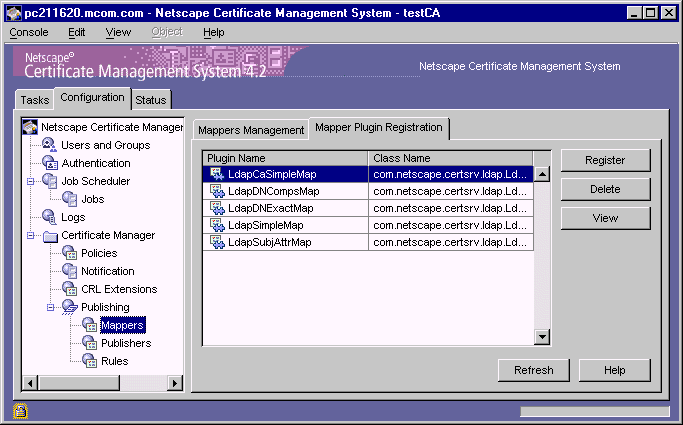

Managing Mapper and Publisher Plug-in Modules
This section explains how to use the CMS window to perform the following operations:
Registering a Mapper or Publisher Module
You can register new mapper or publisher plug-in modules in a Certificate Manager's publishing framework. Registering a new mapper or publisher module involves specifying the name of the module and the full name of the Java class that implements the mapper or publisher interface. For example, you can add a mapper implementation, named as follows, to the Certificate Manager's policy framework:com.netscape.publishing.customMapper
Before registering a plug-in module, be sure to put the Java class for the module in the classes directory (the implementation must be on the class path).
To register a policy module in a Certificate Manager's publishing framework:
Log in to the CMS window (see "Logging In to the CMS Window").
In the navigation tree, select Certificate Manager, and then select Publishing.
Select the appropriate object under Publishing:
To register a mapper module, select Mappers, and then in the right pane, select the Mapper Plugin Registration tab.
To register a publisher module, select Publishers, and then in the right pane, select the Publisher Plugin Registration tab.
Click Register.
- This tab lists registered plug-in modules.
Specify information as appropriate:
- If you selected Mapper, the Register Mapper Plugin Implementation window appears. If you selected Publisher, the Register Publisher Plugin Implementation window appears.
Click OK.
- Plugin name. Type a name for the plug-in module.
- Class name. Type the full name of the class for this modulethat is, the path to the implementing Java class. If this class is part of a package, be sure to include the package name. For example, if you are registering a class named myMapper and if this class is in a package named com.myCompany, type com.myCompany.myMapper.
To view the updated configuration, click Refresh.
- You are returned to the Mapper Plugin Registration tab or Publisher Plugin Registration tab.
Deleting a Mapper or Publisher Module
You can delete unwanted mapper or publisher plug-in modules using the CMS window. Before deleting a module, be sure to delete all the rules that are based on this module.To delete a mapper or publisher module from a Certificate Manager's publishing framework:
To delete a mapper module, select Mappers, and then in the right pane, select the Mapper Plugin Registration tab.
To delete a publisher module, select Publishers, and then in the right pane, select the Publisher Plugin Registration tab.
In the Plugin Name list, select the module you want to delete and click Delete.
