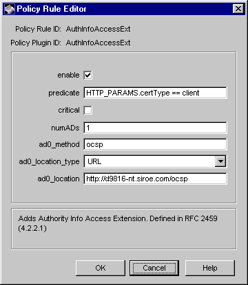

To verify the status of policy rules that enable the Certificate Manager to add the extensions required in an OCSP-compliant client certificate:
In the navigation tree, select Certificate Manager, and then select Policies.
In the Policy Rule list, select the rule named AuthInfoAccessExt and click Edit; this rule was created by default during installation.
- The Policy Rules Management tab appears. It lists configured policy rules.
Make sure the following values are assigned:
Click OK.
- Enable. Checked or selected.
- predicate. Shows HTTP_PARAMS.certType==client.
- critical. Unchecked.
- numADs. Shows 1.
- ad0_method. Shows ocsp or 1.3.6.1.5.5.7.48.1.
- ad0_location_type. Shows URL.
- ad0_location. Shows the complete path to the location where the Certificate Manager listens to calls from OCSP-compliant clients. The path should be in this format: http://<hostname>:<nonSSL_end_entity_port>/ocsp
- If the end-entity port number is 80, you need not specify it in the URL. For example, if the hostname of your Certificate Manager is demoCA.siroe.com and the end-entity port number is 8000, the URL to type in the field would be:
- http://demoCA.siroe.com:8000/ocsp
- If you need details about any of the configuration parameters, click the Help button.

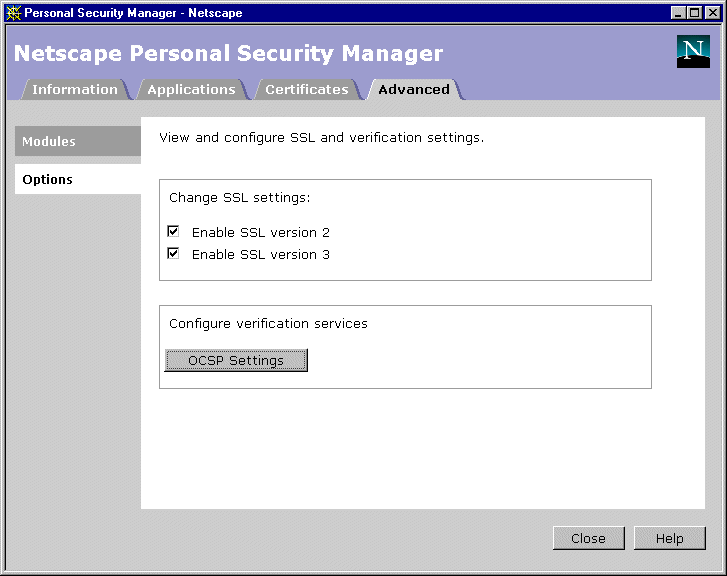

Open the Personal Security Manager interface.
Select the Advanced tab, and then in left pane, select Options.
- In Communicator version 4.7, you can open this window by clicking the Security button in the navigation bar. Alternatively, you can also open this window by selecting Communicator from the main menu, selecting Tools, and then selecting Security Info.
Click the OCSP Settings button.
Select the "Use OCSP to verify only certificates that specify an OCSP service URL" option, and click OK.

In the browser, open the Personal Security Manager interface.
Select the Certificates tab and, in the left pane, click Authorities.
- In Communicator version 4.7, you can open this window by selecting Communicator from the main menu, selecting Tools, and then selecting Security Info.
Locate the Certificate Manager's CA signing certificate, select it, and click Edit.
- The list of CA certificates currently stored in the browser's certificate database appears.
Make sure all the three options are selected and click OK.
- The Edit Security Certificate Settings window appears.

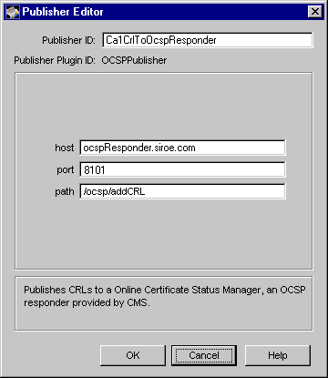

Step C. Create a Publisher for the CRL
Creating a publisher for the CRL involves creating an instance of the publisher module that enables the Certificate Manager to publish the CRL to the Online Certificate Status Manager. In the next step, described in "Step D. Create a Publishing Rule for the CRL", you specify the publisher you create here.To create a publisher for the CRL:
In the navigation tree, click Publishers.
Click Add.
- The right pane shows the Publishers Management tab, which lists configured publisher instances.
Select the module named OCSPPublisher.
- The Select Publisher Plugin Implementation window appears. It lists registered publisher modules.
Click Next.
- Only this publisher module enables the Certificate Manager to publish the CRL to the Online Certificate Status Manager. (If you have registered any custom publisher modules, they too will be available for selection.)
Enter the appropriate information:
- The Publisher Editor window appears.
Click OK.
- Publisher ID. Type a name for the rule; use an alphanumeric string with no spaces. For example, Ca1CrlToOcspResponder.
- host. Type the fully-qualified host name of the Online Certificate Status Manager. The name must be in the form <machine_name>.<your_domain>.<domain>. For example, ocspResponder.siroe.com.
- port. Type the Online Certificate Status Manager's agent port number. For example, 8101.
- path. Make sure this field shows the default path, /ocsp/addCRL. If necessary, type it in.
- The Publishers Management tab appears, listing the new publisher.

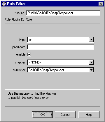

Creating a publishing rule for the CRL involves creating a rule that uses the publisher instance that you created in the previous step. To create a publishing rule:
In the navigation tree, click Rules.
Click Add.
- The right pane shows the Rules Management tab, which lists any currently configured publishing rules.
Select the module named Rule.
- The Select Rule Plugin Implementation window appears. It lists registered modules that enable creating of publishing rules.
Click Next.
- This is the default module. (If you have registered any custom modules, they too will be available for selection.)
- The Rule Editor window appears.
Click OK.
- Rule ID. Type a name for the rule; be sure to use an alphanumeric string with no spaces. For example, PublishCa1CrlToOcspResponder.
- type. Select crl.
- predicate. Leave this field blank.
- enable. Select this option.
- mapper. Select <NONE>.
- publisher. Select the publisher you added for publishing the CRL to the Online Certificate Status Manager. For example, Ca1CrlToOcspResponder.
- The Rules Management tab appears, listing the new rule.

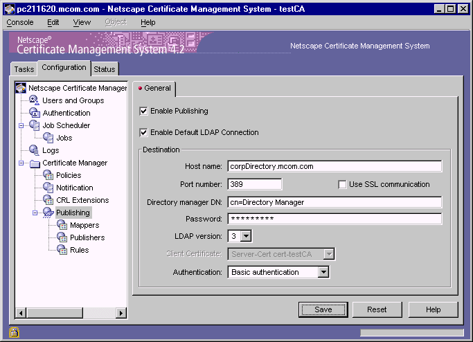

Step E. Make Sure Publishing is Enabled
To make sure that the Certificate Manager is configured for publishing:
In the navigation tree, select Certificate Manager, then select Publishing.
Make sure that the Enable Publishing option is selected. If it is already selected, leave it as it is. If it isn't, select it.
- The right pane shows the publishing details necessary for the server to publish to an LDAP-compliant directory, to files, or to an online validation authority.
If you changed anything, click Save to save the changes.
- (Leave the "Enable default LDAP connection" option as it is; it specifies that the Certificate Manager is configured to publish certificates and CRLs to an LDAP directory.)
- If the changes you made require you to restart the server, you are prompted accordingly. Don't restart the server yet. You can do that after you've made all the required changes.

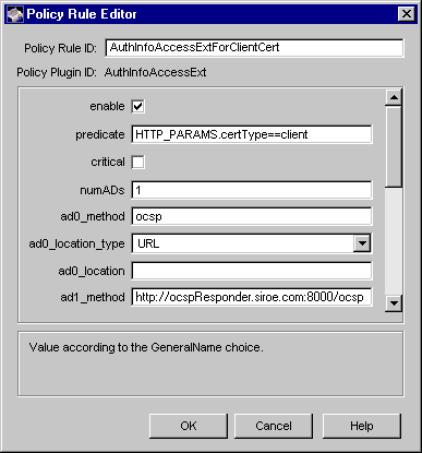

Step 5. Configure Certificate Manager for Required Extension Policies
In order for OCSP-compliant clients to query the Online Certificate Status Manager about the revocation status of a certificate, the certificate being validated must contain the Authority Information Access extension pointing to the location at which the Online Certificate Status Manager listens for OCSP service requests. For details about the Authority Information Access extension, see section "AuthInfoAccessExt Plug-in Module" of CMS Plug-ins Guide.The Certificate Manager can add an extension to a certificate it issues only if the corresponding policy is enabled and configured properly. Hence, before issuing the OCSP-compliant client certificate, you must verify that the Certificate Manager is configured with the appropriate policy rules to add the required extensions to these certificates.
Also, for testing whether your OCSP-compliant clients can verify revocation status of certificates by querying the OCSP responder, you will be issuing a client certificate containing the Authority Information Access extension to Personal Security Manager you installed.
Assign the following values:
- The Policy Rule Editor window appears, showing how this rule is currently configured.
Click OK.
- Enable. Check this box.
- predicate. Type HTTP_PARAMS.certType==client.
- critical. Leave this option unchecked.
- numADs. Type 1.
- ad0_method. Type ocsp or 1.3.6.1.5.5.7.48.1.
- ad0_location_type. Select URL.
- ad0_location. Type the complete path to the location where the Online Certificate Status Manager listens to calls from OCSP-compliant clients. The path should be in this format:
- http://<hostname>:<end_entity_HTTP_port>/ocsp
- For example, if the host name of your Online Certificate Status Manager is ocspResponder.siroe.com and the port number assigned to the non SSL end-entity port is 8000, the URL to type in the field would be:
- http://ocspResponder.siroe.com:8000/ocsp
Make any other changes, if necessary.
- You are returned to the Policy Rules Management tab.
- The Certificate Manager is ready to request client certificates with Authority Information Access extension.

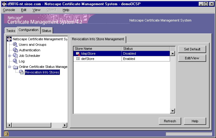

The Online Certificate Status Manager stores each Certificate Manager's CRL in its internal database and uses it as the default CRL store for verifying the revocation status of certificates. You can also configure the Online Certificate Status Manager to use the CRL published to an LDAP directory, instead of the CRL in its internal database. For example, if you've configured Certificate Managers to publish CRLs to LDAP directories (see Chapter 19 "Setting Up LDAP Publishing"), you can configure the Online Certificate Status Manager to use the CRLs published to these directories.To configure the Online Certificate Status Manager to use the CRLs in its internal database or an LDAP directory for verifying revocation status of certificate:
Log in to the CMS window for the Online Certificate Status Manager (see "Logging In to the CMS Window").
In the navigation tree, select Online Certificate Status Manager, and then select Revocation Info Stores.
Select the appropriate option:
- The right pane shows the two repositories the Online Certificate Status Manager can use; by default, it uses the CRL in its internal database.
If you want to configure the Online Certificate Status Manager to use the CRLs in its internal database, select defStore and click Edit/View.
If you want to configure the Online Certificate Status Manager to use the CRLs in one or more directories, first click Set Default to enable the ldapStore option, select ldapStore, and click Edit/View. (Clicking the Set Default button toggles the selection between the two repositories.)
Fill in the appropriate values.
- The Revocation Info Store Editor for the selected store appears.

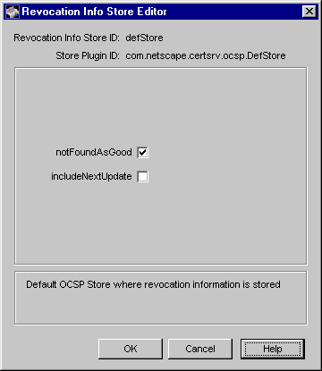

If you selected defStore, fill in values as below:
Click OK.![]()

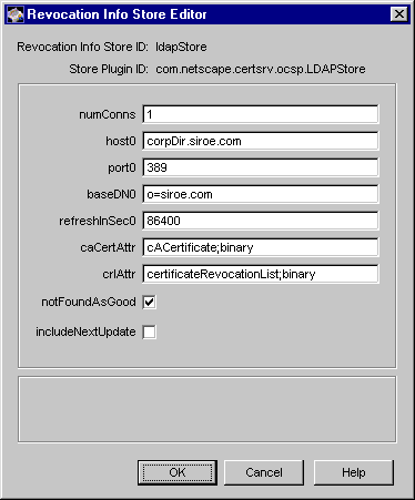

If you selected ldapStore, fill in values as below:
- notFoundAsGood. A certificate's status can typically be indicated by three possible OCSP responses, namely GOOD, REVOKED, and UNKNOWN. Select this option if you want the Online Certificate Status Manager to return an OCSP response of GOOD if the certificate in question cannot be found in the certificate repository. If you deselect the option, the response will be UNKNOWN, which when encountered by Netscape Personal Security Manager (an OCSP-compliant client) results in an error message.
- includeNextUpdate. The Online Certificate Status Manager can include the time stamp of next CRL updatea future update time for the CRL or the revocation informationin the OCSP response that it sends to OCSP-compliant clients. (According to the OCSP protocol, it is optional to include the time stamp of next CRL update in an OCSP response.) Select this option if you want the OCSP response to contain information about the next CRL update. Leave the option deselected if you don't want the OCSP response to contain this information.
- numConns. Type the total number of LDAP directories the Online Certificate Status Manager should check. By default, this is set to 0. If you change the value to a postive integer, for example 1, 2, or 3, you will see that many sets of host, port, baseDN, and refreshInSec fields. (Change the value, click OK, and reopen the window to see the updated fields.)
- host<n>. Type the fully-qualified hostname of the LDAP directory. The name must be in the <machine_name>.<your_domain>.<domain> form. For example, corpDir1.siroe.com.
- port<n>. Type the nonSSL port of the LDAP directory. For example, 389.
- baseDN<n>. Type the DN to start searching for the CRL. For example, O=siroe.com.
- refreshInSec<n>. Type how often the connection be refreshed. The default is 86400 seconds (that is, refresh every day).
- caCertAttr. Leave the default value, cACertificate;binary, as it is. (It's the attribute to which the Certificate Manager publishes its CA signing certificate.)
- crlAttr. Leave the default value, certificateRevocationList;binary, as it is. (It's the attribute to which the Certificate Manager publishes CRLs.)
Click Refresh.
- You're returned to the Revocation Store Info Management tab

To ensure that Personal Security Manager (the OCSP-compliant client) is configured to verify the revocation status of certificates using the OCSP protocol:
Open a web browser window.
- The OCSP Setting window appears.
