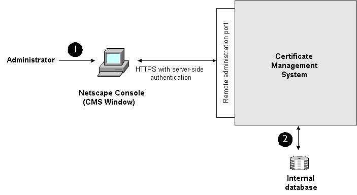

Authentication of Administrators
When an administrator makes an administrative request to Certificate Management System (from the CMS window within Netscape Console or from any command-line tool), the server needs to authenticate the administrator before processing the request. To facilitate this, Certificate Management System supports an authentication method that includes user ID- and password-based authentication from the client and SSL server authentication from the server.
Certificate Management System identifies and authenticates users with administrator privileges by checking their user IDs and passwords in its internal database. These are the user IDs and passwords you entered in the internal database when you created these user entries. For details, see "Setting Up Administrators".
Figure 15-1 illustrates the authentication process.
Figure 15-1    CMS authentication of a user with administrator privileges
These are the steps shown in Figure 15-1:
  1. An administrator opens Netscape Console and attempts to log in to the CMS window by entering the user ID and password at the login prompt. The server takes the administrator's user ID and password and binds them to privileged-user entries in its internal database.
  2. If the user ID and password bind successfully to a user entry, authentication succeeds; otherwise, it fails.
    • If authentication fails, the server logs an error message and sends a rejection notification. See Chapter , "."
    • If authentication succeeds, the server checks the user's access rights (based on group memberships) to determine whether the user is authorized to perform the requested operation.
    If both authentication and authorization succeed, the server services the request. Otherwise, it rejects the request and logs the reason for the rejection.
    Note Authentication for administrators is hardcoded; it is not configurable.

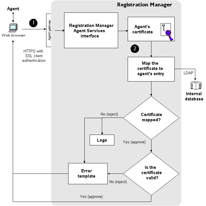

Figure 15-2 shows how a Registration Manager authenticates and authorizes a Registration Manager agent.
Figure 15-2    Registration Manager authentication of a user with Registration Manager agent privileges
This example shows these steps:
  1. An agent opens a web browser and enters the URL to the Registration Manager Agent Services interface hosted by the Registration Manager. The server requests the client for SSL client authentication. The client in turn prompts the agent to specify the certificate that it should present to the server for authentication. The successfully SSL client authenticated certificate is presented to the Registration Manager.
  2. Upon receiving the certificate, the Registration Manager performs the following authentication and authorization process:
    • First, it verifies that the certificate exists in its internal database. Next, it verifies that the certificate is a valid client certificate. If the certificate is valid, the Registration Manager proceeds. Otherwise (for example, if the certificate has expired or been revoked or was signed by an untrusted authority), the Registration Manager rejects the request, sends an error message to the agent, and logs a reason for the rejection.
      Note that the Registration Manager verifies the revocation status of the agent certificate if it has been issued by the Certificate Manager to which the Registration Manager is connected to; the Certificate Manager keeps a record of all the certificates it has issued and their current status in its internal database. However, if the agent certificate is issued by any other CA, the Registration Manager cannot verify the revocation status of the certificate; it can only verify that the certificate is valid and that it has been issued by a CA that the Registration Manager trusts. For details on configuring the Certificate Manager or Registration Manager to check the revocation status of its agents' certificates, see "Revocation Status Checking of Agent Certificates".
      If the internal database contains an invalid certificate for an agent, the server rejects all requests from that agent. For the server to accept requests from that agent, you would have to replace the agent's invalid certificate in the internal database with a valid one. For details on how to do this, see "Changing a Privileged User's Certificate".
    • The Registration Manager reads the user's subject name (in DN form) and the issuer name from the certificate. This combination is unique. It then finds the login name corresponding to this unique combination in its privileged-users list, which is stored in the internal database. If a login name is associated with the certificate, the Registration Manager proceeds. Otherwise, it rejects the request.
      The Registration Manager then checks the group memberships of the login name and the corresponding access rights to determine whether the user is authorized to perform the requested service.
    If both authentication and authorization succeed, the Registration Manager services the request. Otherwise, it rejects the request and logs a reason for the rejection.

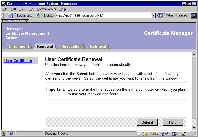

Certificate Renewal Form
The End Entity Services interface of the Certificate Manager and Registration Manager includes a default HTML form for renewing end users' certificates. The form is accessible from the Renewal tab as shown in Figure 15-3.
Figure 15-3    Certificate renewal form for end users
The default renewal form is preconfigured for SSL client authentication, enabling end users to renew their personal or client certificates by presenting valid or expired certificates.
If you want to change the form content to suit your organization's requirements, edit the following file:
<server_root>/cert-<instance_id>/web/ee/UserRenewal.html
For details on individual form elements, see the online help available by clicking the Help button on the form. For more information on customizing the form, see CMS Customization Guide.

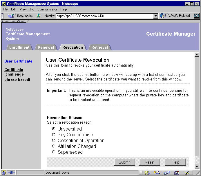

Authentication of End Users During Certificate Revocation
Certificates can be revoked by administrators, agents, and end users. When an end user submits a certificate revocation request, the first step in the revocation process is for the Certificate Manager or Registration Manager to identify and authenticate the end user. The reason for this is when an end user attempts to revoke a certificate, the server needs to verify that the user is attempting to revoke his or her own certificate, not a certificate belonging to someone else.
Both Certificate Manager and Registration Manager support the following methods of revocation:
  • SSL Client Authenticated Revocation
    This method requires an end user to present a valid or revoked certificate that has the same subject name as the one he or she wants to revoke. Without the certificate, the user won't be able to revoke the certificate.
  • Challenge-Password-Based Revocation
    This method requires an end user to enroll for a personal certificate using the manual enrollment method. The reason for this is, by default, only the manual enrollment form includes fields for entering the challenge password when requesting a certificate. None of the other enrollment forms, for example directory-based or NIS server-based forms, by default allow end users to specify a challenge password.
    You can use the manual-enrollment form (ManUserEnroll.html) as a model and introduce the input fields for entering the challenge password in any of the other end user enrollment forms. Keep in mind that this feature is available for end-user certificates only; the feature is not available for other types of certificates.
    Revoking a certificate using the challenge password is useful in certain situations. For example, if you issue a single certificate to a user and the user is unable to use the certificate due to loss of corresponding key pair, it's not possible for the user to revoke his or her own certificate using the SSL client authenticated revocation method. If the user has a challenge password for the certificate, he or she can use it to revoke the certificate the server maintains in its database.
Forms for both methods are available through the End Entity Services interface (HTTPS only) of the Certificate Manager and Registration Manager; see "Certificate Revocation Forms".
The End Entity Services interface of the Certificate Manager and Registration Manager includes default HTML forms for both the SSL client authenticated revocation and challenge-password-based revocation. The forms are accessible from the Revocation tab. Figure 15-4 shows the form that enables end users to revoke their certificates using a challenge password. You can view the form that enables SSL client authenticated revocation by clicking the User Certificate link.
Figure 15-4    Form for SSL client authenticated certificate revocation
If you want to change the forms to suit your organization's requirements, you can edit the following files:
  • ChallengeRevoke1.html (the form that allows challenge password based revocation of client or personal certificates)
  • UserRevocation.html (the form that allows SSL client authenticated revocation of client or personal certificates)
Both the files are located here: <server_root>/cert-<instance_id>/web/ee

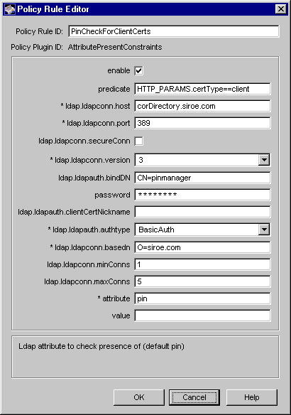

The Attribute Present Constraints policy enables you to prevent users from successfully enrolling for multiple certificates from the Registration Manager during the time interval between directory updates. If you configure the Certificate Manager to use this policy to check the master directory for PINs before issuing certificates, successive certificate requests would fail because the PIN has been removed from the master directory. This way, even if the Registration Manager authenticates successive requests, the Certificate Manager rejects them, thus ensuring that a user has only one certificate.
If you are not familiar with the Attribute Present Constraints policy, see section "AttributePresentConstraints Plug-in Module" in Chapter 3, "Constraints Policy Plug-in Modules" of CMS Plug-ins Guide.
Note that unlike some of the other policy rules, Certificate Management System does not create an instance of the Attribute Present Constraints policy rule during installation. If you created this rule after installation, you can configure the server to use that rule. The instructions below explain how to create a new rule:
  1. Log in to the CMS window for the Certificate Manager (see "Logging In to the CMS Window").
  2. Select the Configuration tab.
  3. In the navigation tree, select Certificate Manager, and then select Policies.
    The Policy Rules Management tab appears. It lists currently configured policy rules.
  4. Click Add.
    The Policy Plugin Implementation window appears.
  5. Select AttributePresentConstraints and click Next.
    The Policy Rule Editor window appears. It lists the configuration information required for this policy rule.
  6. Enter the appropriate information.
  7. Click OK to save your configuration.
    You are returned to the Policy Rules Management tab. If required, click the Reorder button and order the rules as appropriate. For details, see "Step 5. Reorder Policy Rules".

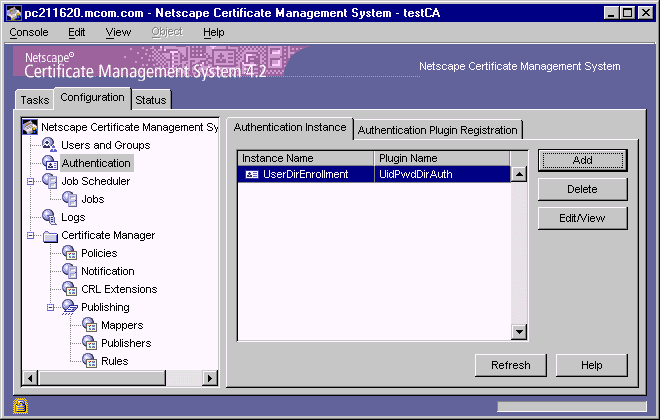

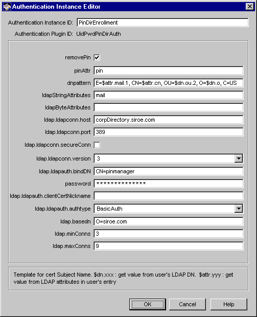

To add an authentication instance to the CMS configuration:
  1. In the CMS window, select the Configuration tab.
  2. In the navigation tree, select Authentication.
    The right pane shows the Authentication Instance tab, which lists any currently configured authentication instances.

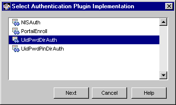

  3. Click Add.

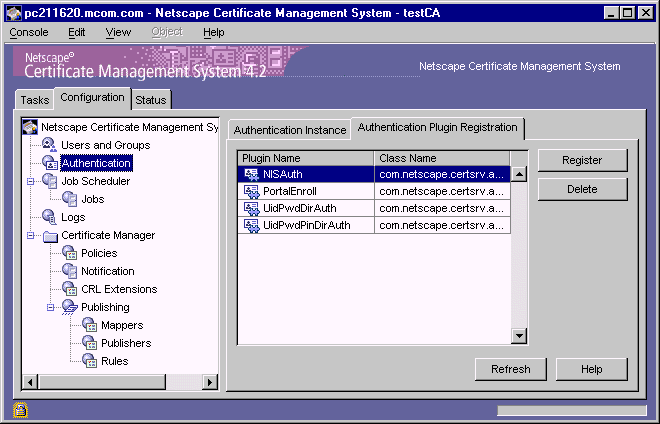

    The Select Authentication Plugin Implementation window appears. It lists the currently registered authentication plug-in modules.
  4. Select a plug-in module.
    The following choices are the ones provided by default with Certificate Management System. If you have registered any custom authentication plug-in modules, they too will be available for selection.
    UidPwdDirAuth. Select this if you want to use the directory-based authentication module.
    UidPwdPinDirAuth. Select this if you want to use the directory- and PIN-based authentication module (with or without PIN removal). To configure Certificate Management System for PIN-based enrollment method, you must have completed "Step 2. Set Up the Directory for PIN-Based Enrollment".
    NISAuth. Select this if you want to use the NIS server-based authentication module.
    PortalEnroll. Select this if you want to use the portal authentication module.
    For the purposes of this instruction, assume that you selected UidPwdPinDirAuth.
  5. Click Next.

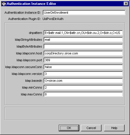

    The Authentication Instance Editor window appears. The Authentication Instance ID field shows the default instance name embedded in the associated enrollment form (see Table 15-1). The Authentication Plugin ID field shows the module you've chosen. The remaining fields list the configuration information required for this authentication instance.
  6. If you don't want to use the default instance name, in the Authentication Instance ID field, type a unique name for this instance that will help you identify it.
    For the name, be sure to use an alphanumeric string with no spaces. If you chose to use a different name, be sure to edit the default name in the enrollment form in the next step, "Step 5. Set Up the Enrollment Interface".
  7. Fill in values for the remaining parameters.
  8. Click OK.
    The CMS configuration is modified. If the changes you made require you to restart the server, you will be prompted accordingly. Don't restart the server yet; you can do this after you've made all the required changes.

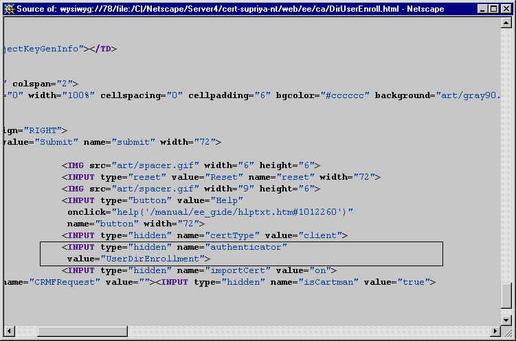

  4. Locate the attribute that associates the authentication instance with the enrollment form.
    In the default enrollment forms, locate this line:
    <INPUT TYPE="HIDDEN" NAME="authenticator" VALUE="myAuthMgr">
    In the custom enrollment form, be sure to include the following line, and replace myAuthMgr with the name of the authentication instance you added.
  5. Check the value assigned to authenticator attribute (the VALUE= field). Make sure that it is same as the name or ID you assigned to the authentication instance you created in Step 5. If it is different, replace it with the name of the authentication instance. For example, if you used test_auth as the instance name, the edited line should look like this:
    <INPUT TYPE="HIDDEN" NAME="authenticator" VALUE="test_auth">

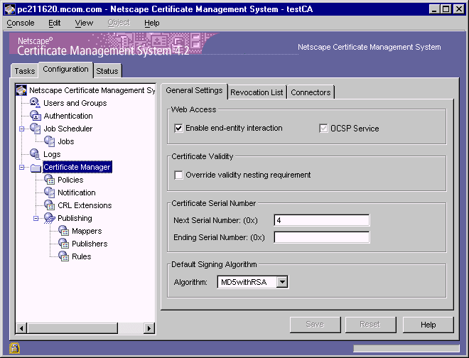

Enabling End-Entity Interaction with a Certificate Manager
To enable end-entity interaction with a Certificate Manager:
  2. In the navigation tree, select Certificate Manager.
    The General Setting tab appears.
  3. In the Web Access section, check the "Enable end-entity interaction" option if you want end entities to be able to interact with the selected Certificate Manager via the HTTPS port; leave it unchecked to disable end-entity interaction with the server.
    Note that if you disable end-entity interaction, the Network tab still shows the HTTPS port and allows you to configure it (see "Configuring Port Numbers"). However, you should know that the server ignores this port.
  4. In the Certificate Validity section, check the "Override validity nesting requirement" option, if you want the Certificate Manager to issue certificates with validity periods beyond that of its CA signing certificate; see "CA Signing Key Pair and Certificate").
    If you leave the box unchecked and if the Certificate Manager (CA) finds a request with validity period extending beyond that of its CA signing certificate, it automatically truncates the validity period to end on the day the CA signing certificate expires. For example, if the CA signing certificate expires on June 10, 2004, any enrollment or renewal request with validity period beyond June 10, 2004 will have validity period truncated to end on June 10, 2004.
    Validity periods of certificates during enrollment is determined by the policy explained in ValidityConstraints plug-in module. Similarly, validity periods of certificates during renewal is determined by the policy explained in RenewalValidityConstraints plug-in module. Both the modules are explained in CMS Plug-ins Guide.
  5. In the Certificate Serial Number section, specify the serial number range for certificates issued by this Certificate Manager. The server assigns the serial number you enter in the "Next serial number" to the next certificate it issues and the number you enter in the "Ending serial number" to the last certificate it issues.
    The serial number range enables you to deploy multiple CAs, balancing the number of certificates each CA issues. Note that the combination of an issuer name and a serial number uniquely identifies a certificate. To ensure that two distinct certificates issued by the same authority doesn't contain the same serial number, make sure the serial number range does not overlap among cloned CAs. (For information on cloning CAs, "Cloning a Certificate Manager".)
    Also note that when a CA exhausts all its serial numbers, you can revive it by changing the values in the "Next serial number" and "Ending serial number" fields, followed by restarting the Certificate Manager.
  6. In the Default Signing Algorithm section, select the signing algorithm the Certificate Manager should use for signing certificates. The choices are "MD2 with RSA," "MD5 with RSA," and "SHA1 with RSA," if the CA's signing key type is RSA and "SHA1 with DSA," if the CA's signing key type is DSA.
    Note that the signing algorithm specified in the Certificate Manager's policy configuration overrides the algorithm you select here. For information on a Certificate Manager's policy configuration, see SigningAlgorithmConstraints policy plug-in module in CMS Plug-ins Guide.
  7. To save your changes, click Save.
    The CMS configuration is modified. If the changes you made require you to restart the server, you will be prompted accordingly. In that case, restart the server.

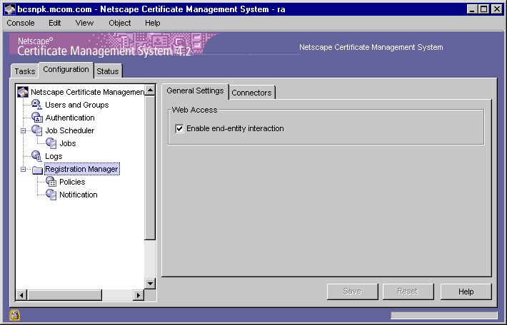

Enabling End-Entity Interaction with a Registration Manager
To enable end-entity interaction with a Registration Manager:
  2. In the navigation tree, select Registration Manager.
  3. In the Web Access section, check the "Enable end-entity interaction" option if you want end entities to be able to interact with the selected Registration Manager via the HTTPS port; leave it unchecked to disable end-entity interaction with the server.
  4. To save your changes, click Save.

This section explains how to use the CMS window to do the following:
For information on adding or changing authentication-specific information in the configuration file, see "Changing the Configuration by Editing the Configuration File".
Deleting an Authentication Instance
You can delete an authentication instance that you no longer need from the CMS configuration. If you delete an authentication instance, end users will fail to enroll for certificates using the associated enrollment form. If you want the form to work with another authentication instance, you must make the appropriate changes to the form; see "Step 5. Set Up the Enrollment Interface".
To delete an authentication instance from the CMS configuration:
  1. Log in to the CMS window (see "Logging In to the CMS Window").
  3. In the navigation tree, click Authentication.
    The right pane shows the Authentication Instance tab, which lists currently configured authentication instances.
  4. In the Instance Name list, select the instance you want to delete and click Delete.
  5. When prompted, confirm the delete action.
Modifying an Authentication Instance
You can modify an authentication instance by editing its configuration parameter values; you cannot edit the name of an instance. To change the name of an instance, you need to create a new instance exactly like the instance you want to rename, except with a new name, and delete the old instance. For details, see "Step 4: Add an Authentication Instance".
When you modify an authentication instance, the CMS configuration is updated to include the modifications. Because you are not changing the name of the authentication instance, you do not have to make any changes to the end-user servlet configuration.
To modify an authentication instance in the CMS configuration:
    The right pane shows the Authentication Instance tab, which lists configured authentication instances.
  4. In the Instance Name list, select the instance you want to modify and click Edit.
    The Configure Authentication Instance Parameters window appears, showing the current configuration of this instance.
    For the purposes of completing these instructions, assume you selected UserDirEnrollment.
  5. Make changes as appropriate. If you need description for any of the parameters, click the Help button or check the CMS Plug-ins Guide.
  6. Click OK.

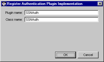

Registering an Authentication Module
You can register custom authentication plug-in modules from the CMS window. Registering a new authentication module involves specifying the name of the module and the full name of the Java class that implements the authentication interface. For example, you can add a Java class, named as follows, that implements an authentication module:
com.netscape.certsrv.authentication.ssnAuth
Before registering an authentication module, be sure to put the Java class for the module in the classes directory. If you need help, check the tutorials installed in this directory: <server_root>/cms_sdk/cms_jdk/samples/authentication
To register an authentication module in the CMS authentication framework:
  3. In the navigation tree, click Authentication, and in the right pane, click the Authentication Plugin Registration tab.
    The tab lists modules that are already registered.
  4. Click Register.
    The Register Authentication Plugin Implementation window appears.
  5. Specify which module you want to register:
    Plugin name. Type a name for the module.
    Class name. Type the full name of the class for this module—that is, the path to the implementing Java class. If this class is part of a package, be sure to include the package name. For example, if you are registering a class named NISAuth and if this class is in a package named com.mycompany, type com.mycompany.NISAuth.
  6. Click OK.
